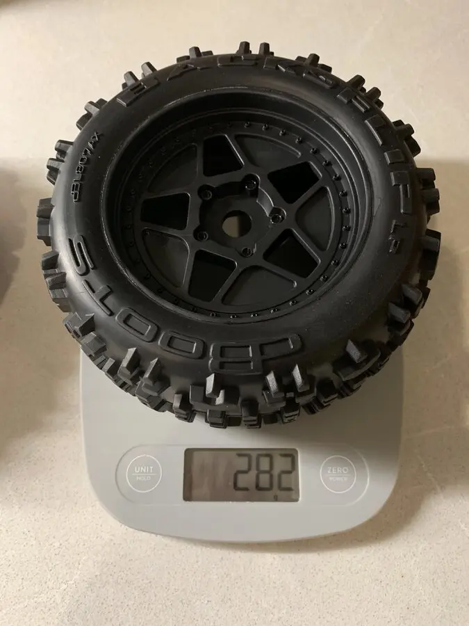

When I was ordering my ET48, since I knew all of nothing about RC cars (still don’t know much), I got on the phone with the online vendor to ask them about different things, including wheels and tires, and while browsing I asked him whether the Backflip 6S fit, and he said they did. I took them out for the first time tonight, man these things are big! I put them on, and they hit the turnbuckle at full turn, and also the arms when turned the other way.
Quick search and it looks like the Backflips 4S might be better for the ET48, but there were also mentions of extended hubs so I’m not entirely sure whether I need to change anything for them to fit, so here are a few questions:
1- will the backflip 4S fit the stock ET48 2.0 or do I need any modifications?
2- same question for the 3.8 Proline Badlands
3- do The Backflip 6S for the MT410? I don’t have an MT410 but maybe I’ll get one and I could keep the wheels for that. If not, I may just return them
Thanks for the help, the wheel/tire sizing is a little confusing.

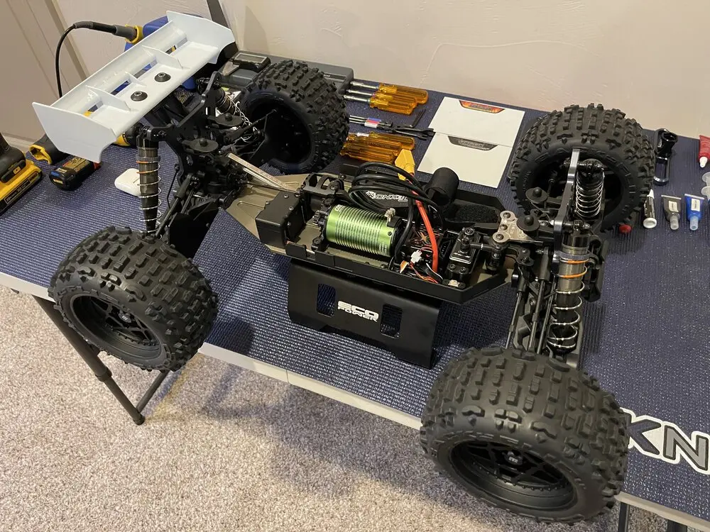

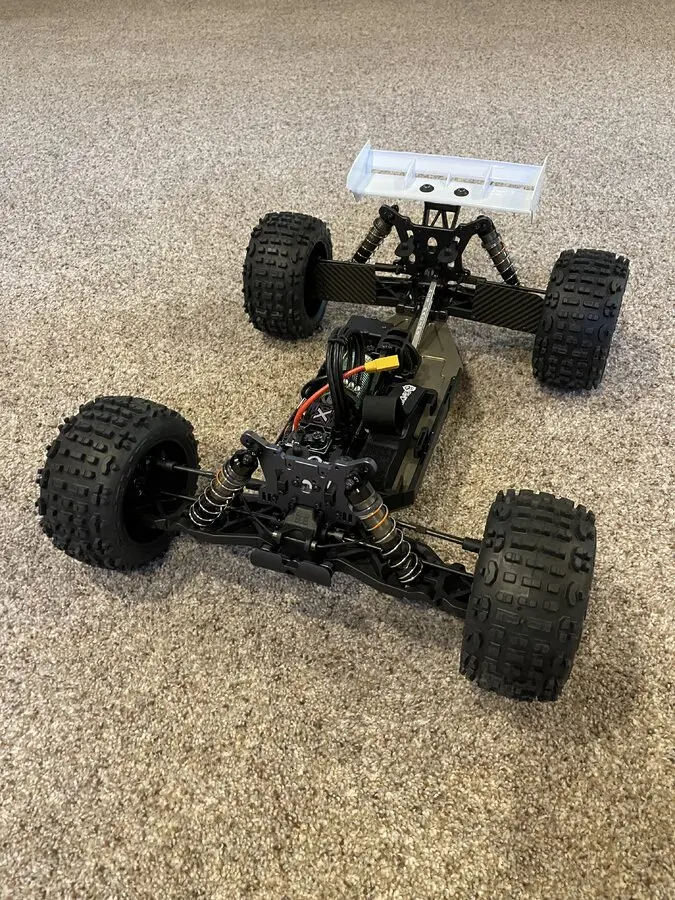

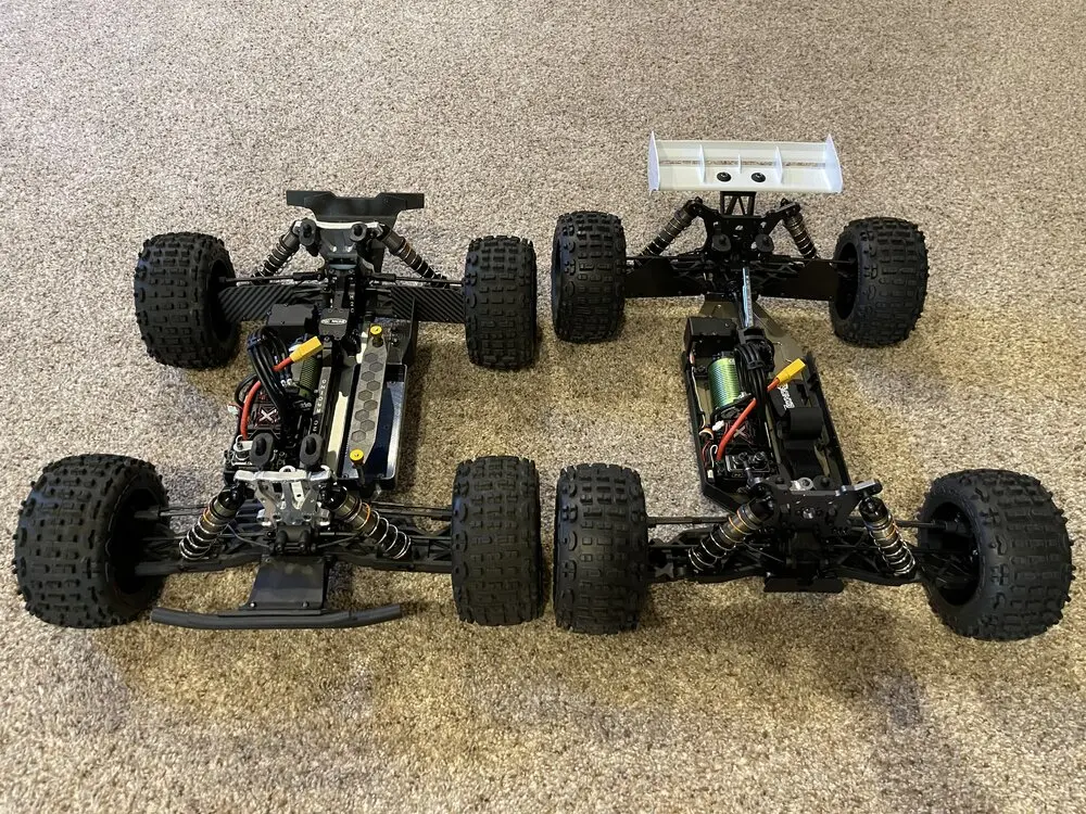

Grab the 4S they fit just fine. I run backflip 4s for both my MT410 and ET48 2.0.
Prolines work too just a tad smaller overall than the 4S.
Here are some older pics of the 4S. Currently, my ET48 2.0 is getting rebuilt for racing this spring and I reverted my heavily modified MT410 to mostly stock.

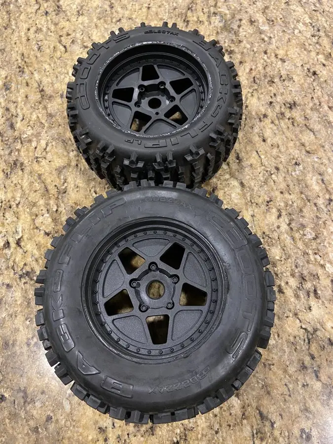

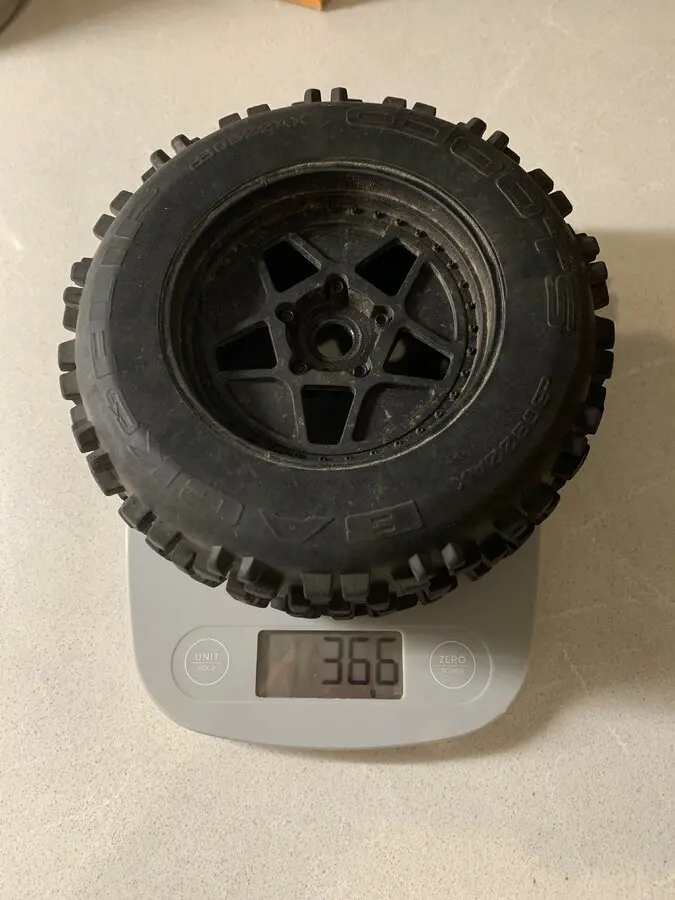

What a difference! The 6S look ridiculous next to the 4s.
That is quite the difference! I never really compared. I’ve got some Bakflip LP 4S for my Tekno ET48 2.0 build as well so good choice on those. Great tire I may order a second set as I am always afraid Arrma will stop making them if they don’t continue their 4S line of rc.

I did a lot of searching but couldn't find any direct comparisons online so I thought this picture might be helpful for others who are making the same decision. I did come across a couple of YouTube videos talking about how good the "Backflips" are on the MT410 and the ET48, but neither of them mentioned whether they were talking about the 6S or 4S.
I didn't weigh the 6S before shipping them back, but they were also noticeably heavier.
