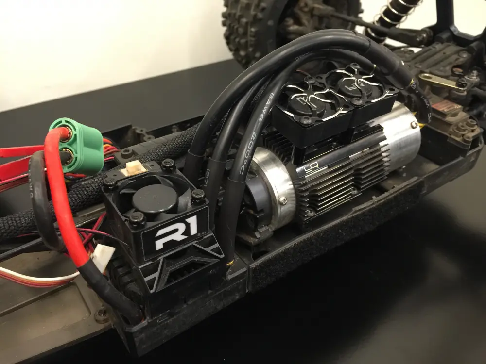

Ok. I will have to try and mount it near the rear of the car behind the motor. My concern is that the MAX8 is quite big and it could possibly get damaged by debris/impact being so close to the rear wheel.
This is my MMX, it's tight but it works. It's fully covered underneath and the body covers the side of the ESC. The wires aren't as close to the pinion as it looks in the picture. I'm not sure how tight it is with the Max8.
2642
Ok. I’ll have a go at fitting the ESC there. If t doesn’t fit I could try mounting it on the steering plate.
