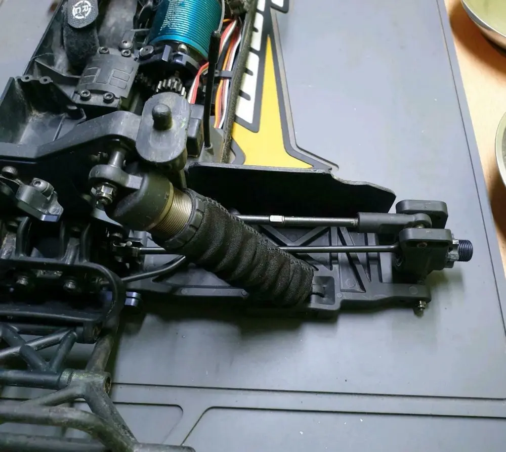

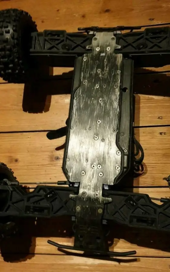

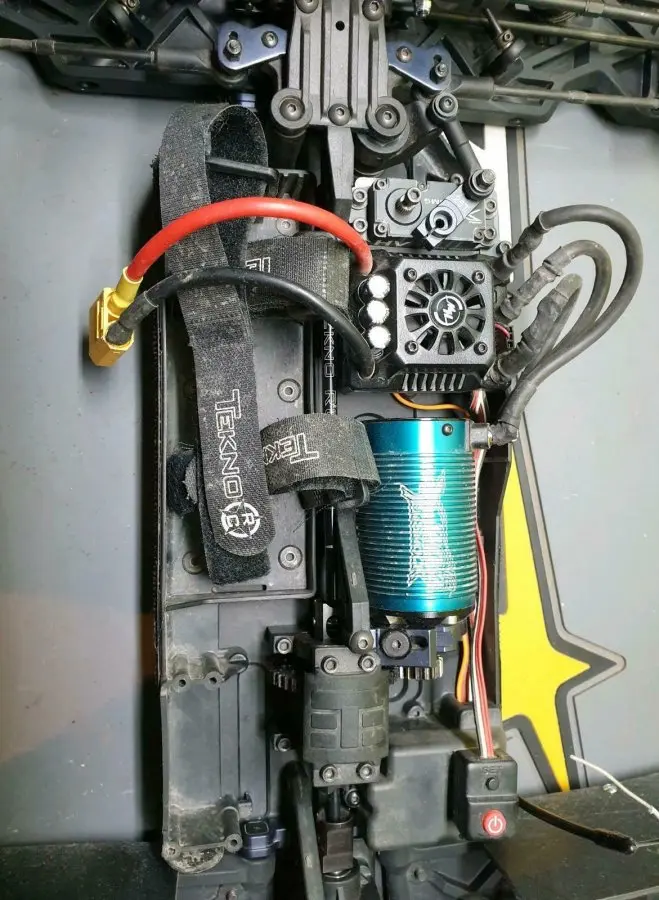

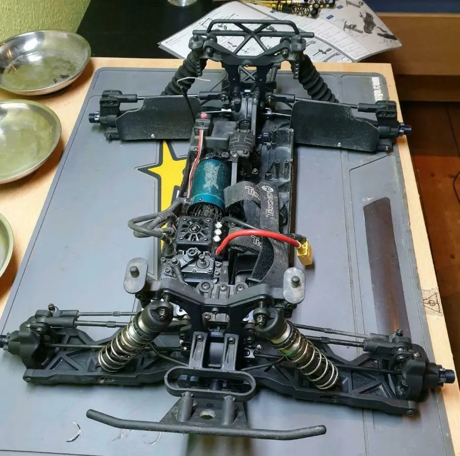

Here are the pictures, i'm happy if anyone takes a look. The tires are proline badlands, not sure which size exactly.

Doesn't look bad. Is the servo good? I see its disconnected. How much is he asking?
He is willing to sell for 500€. Since it comes without a remote and shell, this seemed fair but not suspiciously low to me. Plus it fits my budget (I was originally going to buy an Outcast 6s). In terms of upgrades it's got the shroud, metal servo horn and a steel spur gear. From what i have read, those seem to be the essentials.
The servo is this one. I don't know much about servos, but it seemed adequate for the job.
It looks like the truck has been for sale for about a month. However, I think there is just not many people looking for a second hand tekno. The current amount of views on the ad is what an Outcast/Kraton ad gets after 1 or 2 days on the platform. The dynamics on these sites are just weird to me. People seem to be buying 6s Outcasts for more than 400€, even though the retail price is at 450€ right now (including taxes).
Owner says he's quitting the RC hobby. He has driven the truck for about a year (on 4s) and since then it's been sitting on the shelf.
Again, thank you all for taking an interest and helping me out!
*Edit: Is it normal having to wait for a moderator to approve every post i make? Or just because my account is new?
@rflx those pics don't look bad at all. Plastics, axles, dogbone pins, outdrives are actually rather clean. The chassis looks like it has more mileage than the rest of the truck... It could be just the pic. First impression is rather good.
Ask him to reconnect the servo and all for a quick test run. Again, you don't want to jump it for the test run, you just want to make sure the electronics is working and nothing is obviously weared.
Those are 3.8 Badlands, they baloon a bit, but they are excellent off road all around performers on 4s.
i agree - doesn't look too bad at all.
Again, my only thought was "why is the servo disconnected"? Maybe the servo is a dud and needs replacement? Even so, move the steering link by hand to make sure the wheels turn freely and nothing is binding.
If it drives straight and sounds good then go for it. Anything can be replaced on these trucks and there are tons of upgrades when thing do break. Seems like you're comfortable with the price. Maybe try shaving a few buck offs his asking price. He may have an advantage if they're in short supply in your area. Tell him you need to buy a radio, receiver, body and batteries and maybe hell cave in a bit. It comes to about $550 here in the states which is a good deal if the electronics are in good working order.

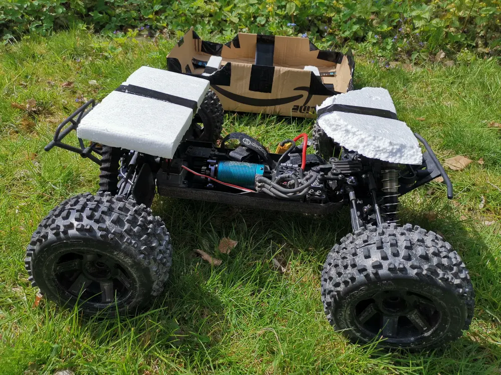

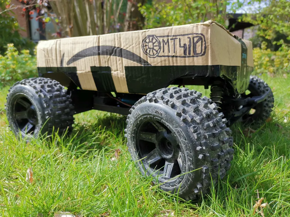

I am really eager to drive this thing. Since the new shell will probably not arrive before monday, i used a body i had at hand. As you can see, i went for a logistics/amazon kind of theme. I'll take it for a spin on 3s later today.

Sweet dude!
That body even has a racing stripe and everything!
