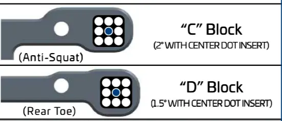

Still having moments trying to.figure out the pills in the ABCD blocks...which one will give me 0 anti squat?
I would have to look but just off the top of my head aren't the pills with the middle dot the neutral setting? Ill look tomorrow and post
the pill with the center dot on the c block would be 2 degrees anti-squat so I think you would need single dot down on "C" block and single dot up on the "D" Block to be 0 anti squat. Single dot up or down from center is 1 degree so to change it 2 degrees you would have to change both pill (1 up and 1 down) inserts on the c and d blocks.
Screen shot of the box set up stating that the center dot is 2 degrees anti quat
Someone correct me if I have that backwards.
