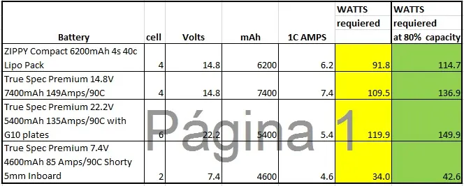

I'm stuck to this thread because I just order some new batteries so I need an upgrade for my little Imax B6 charger
According to my figures, I need a charger whit charge Circuit Power of 150 to 200 Watts
I don't have a big budget (just around $150 USD)

besides the longer charging time, Do you see any problem in charge your battery packs under 1c rating using a low wattage charger?
It's actually better for the batteries to charge them at a lower rate most times. As long as you have the time and monitor the charging. You never want to charge lipos unattended.
