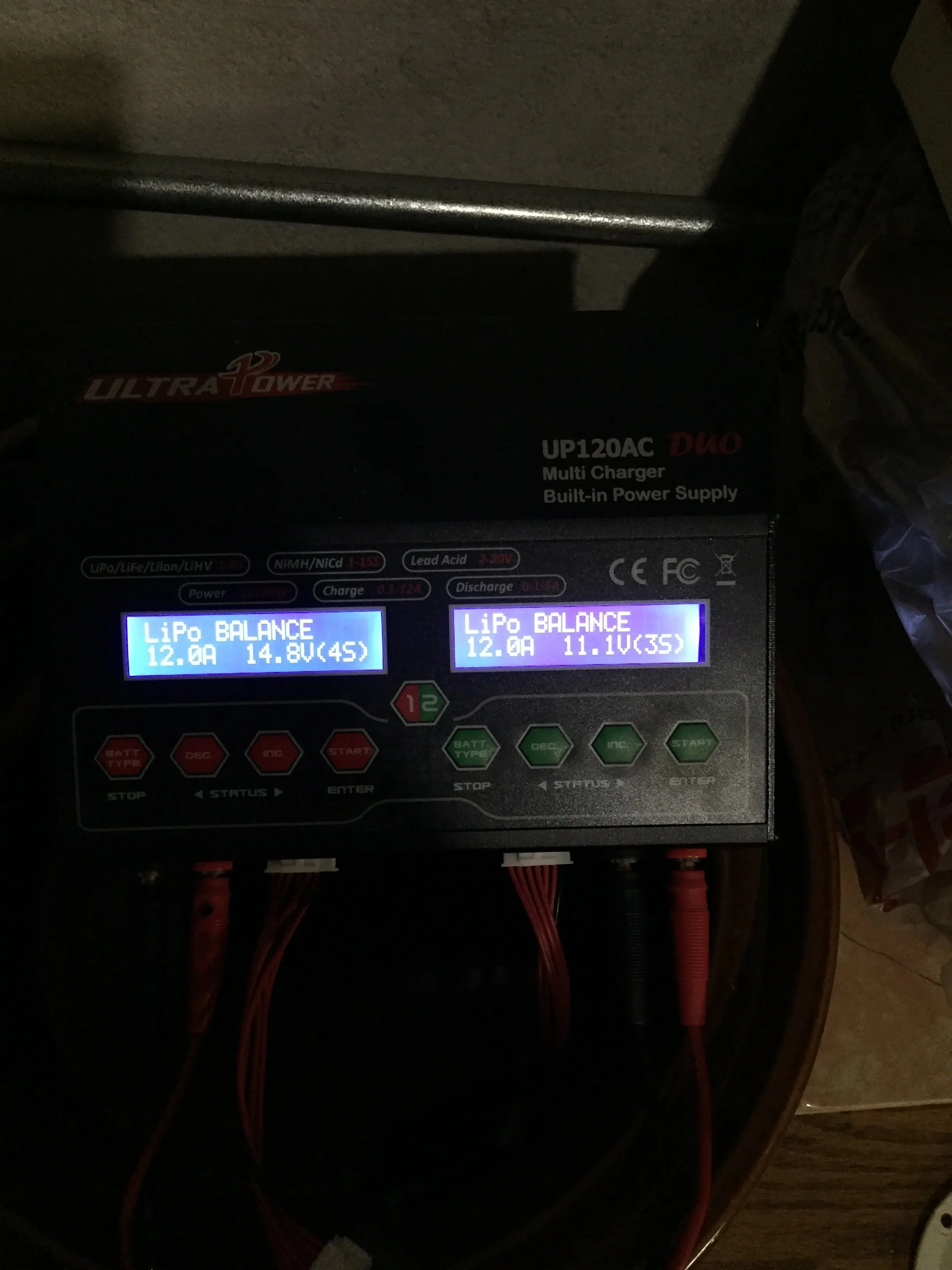

I’ve been very happy with my Ultra Power UP120AC. Can charge 2 batteries at the same time at 12a each! Great with 2c charge rate batteries.
