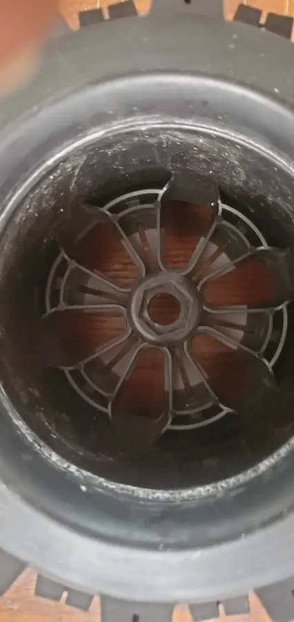

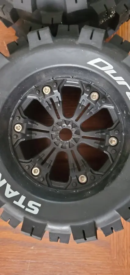

Hi, forum have anyone experienced having tires that refused to come off the hex? There 17mm duratrax stackers i dont know why they do this. I have to pick the truck up by the tire a shake it for them to come off!? Any suggestions on why this happens im afraid to put them back on there now.

I had this problem with my Arrma Outcast 6s, just a defect in manufacturing. I just used my body hole reamer to open the holes up more.

Hi. I had the same issue whith arrma dboots backflips tyres(both the 6S and the 4S LP version) on my ET48.3. They were really hard(almost locked) to remove from the hubs after a run. Actually i found that the rim's hole is a bit tight and drag on the thread of the hubs. Solution is to grind a bit the rim's holes to widen a bit the diameter(something like 0,5mm is probably enough for the rims to slide properly on the hubs).

Thanks for the response. Well I don't have the problem with my arrma dboots copperhead 2 being hard to take off but I sure do with the duratrax tires I have and I will maybe not use those again anytime soon. Lol ?

Well now that I got the arrma dboots 6s tires I dont have that struggle to get them off thanks for the advice ill do that next time I decide to put them on. Lol ?
I've had this issue, though not with the Tekno MT as of yet.
Seems that the torque from these beasts slip ever so slightly in the wheels' hex, causing it to lock into the plastic. Not sure that's what's happening here, but that's what I've experienced in other 1/8 buggies I've had.
