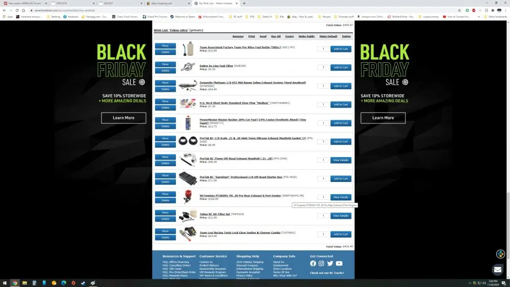

Looks like converting it to electric would be cheaper on your end for sure. I don't see an ESC on that list so I assume you have one already as well as a servo?

Yeah the roller comes with 2 Savox SB2273 servos and I have a BNIB Mamba Monster 2. I am just going to pick up a receiver off eBay and still undecided on what body and tires I want to run.

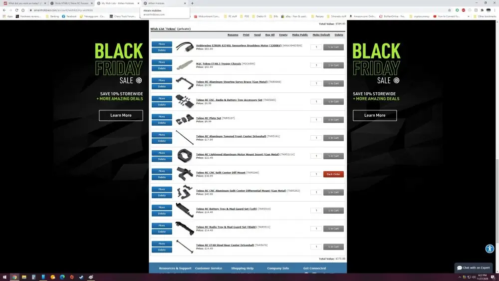

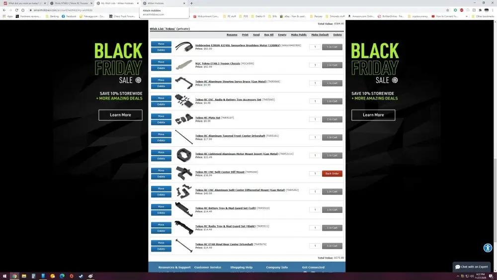

hi there - new to the forum and appreciate the information in advance. I have a NT48.3 that I built last year. Due to my neighborhood and use I want to convert to electric. It looks like the above picture contains all that is needed for this conversion but I can read due to size. Can someone post what exactly I would need for this conversion? Looks like I need to switch the chassis as well. Thanks again for the help!
This is my list. Some of the parts are the Tekno option parts, some are M2C upgrades and the M2C chassis brace is optional.

This build is going kind of slow, spent way too much money at Christmas so I probably won't make any headway on this until I get my stimulus check. So far all I have is the motor and esc.

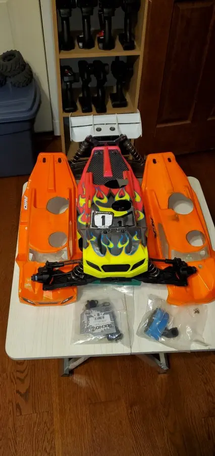

I missed this when I was comparing things in the manual https://www.ebay.com/itm/353334426375 and I am sure I missed a few other items as well. I'll find out for sure once parts start rolling in.

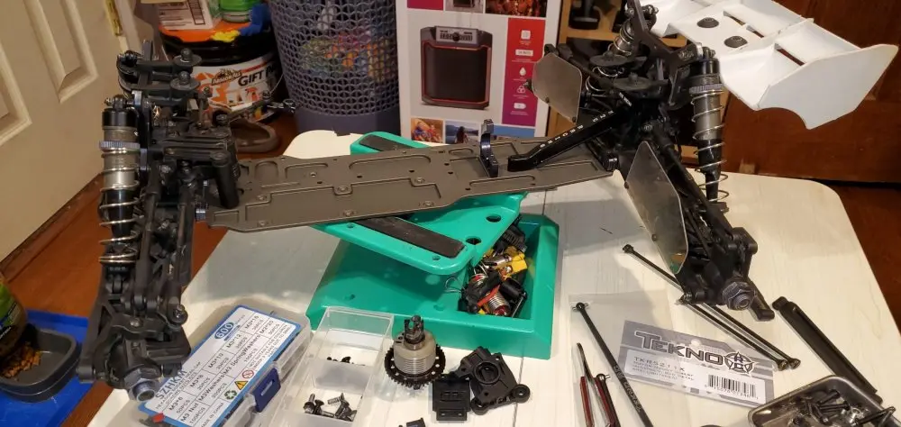

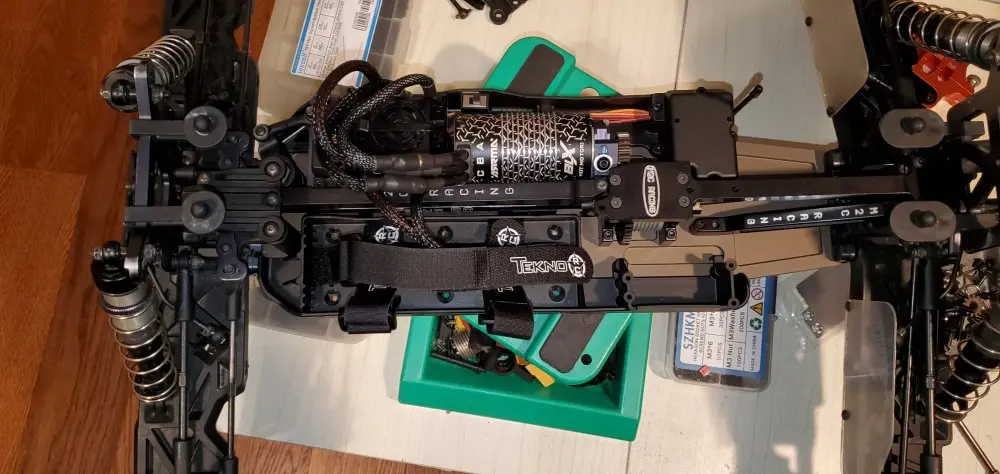

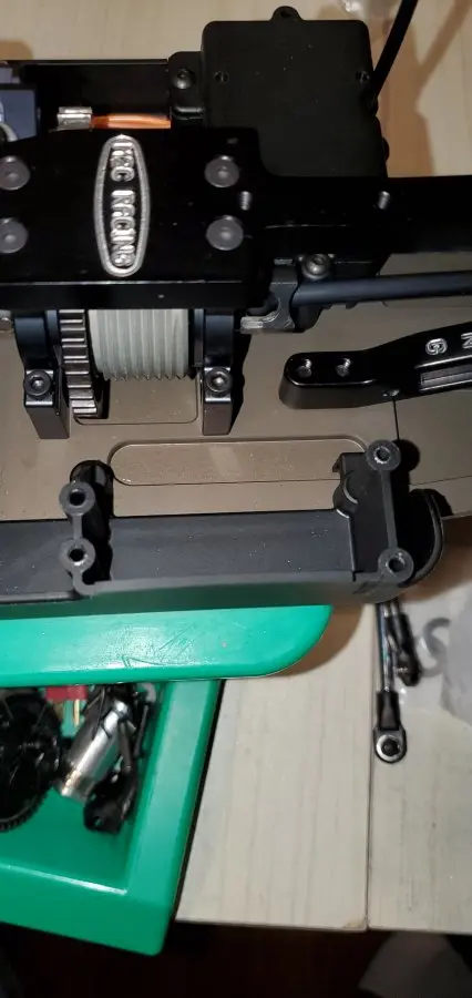

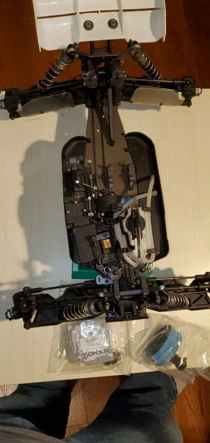

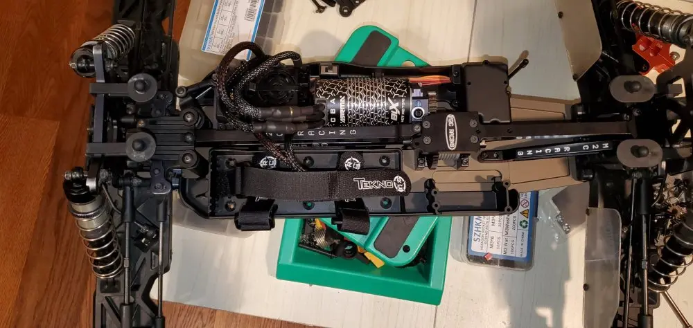

So far this is where I am. Waiting on some more parts.

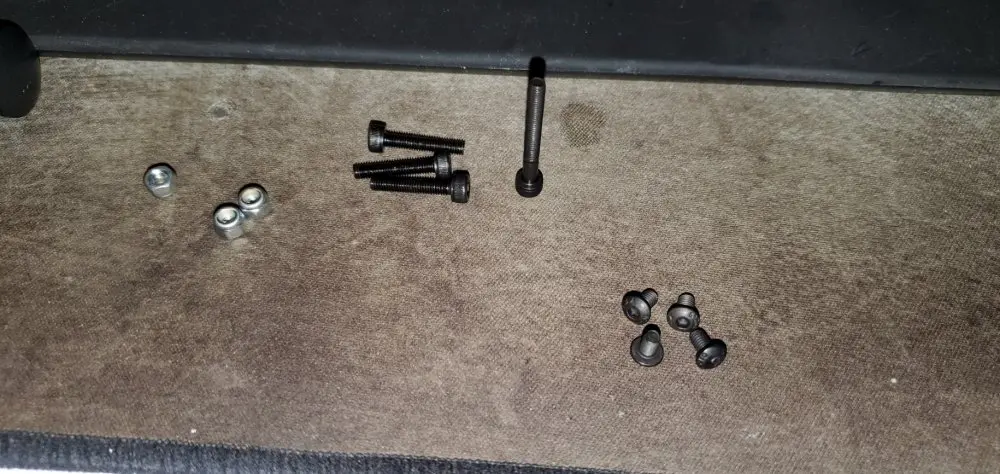

And I really wish there were some sort of directions included with the chassis stiffener kit, I figure out where most of the hardware goes but I have all this left over and no idea where it goes or what it is for.

I’ve had no luck with shipped orders lately. Try Ace Hardware supply, they carry those types of screws.
My Ace only carries 10.9 hardware and I don't remember them having anything that small I could always go check later today. I usually go to Menards as they carry 12.9 black oxide screws.

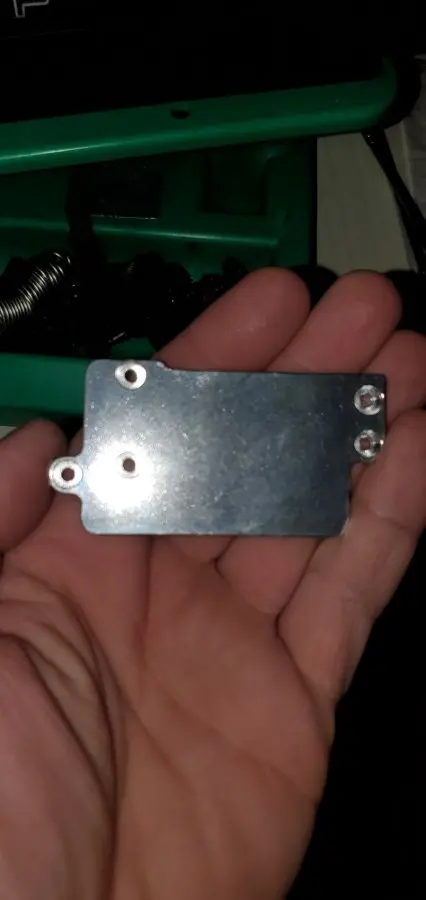

What is this thing for?
And this thing that came with the M2C Racing rear chassis stiffener kit.
