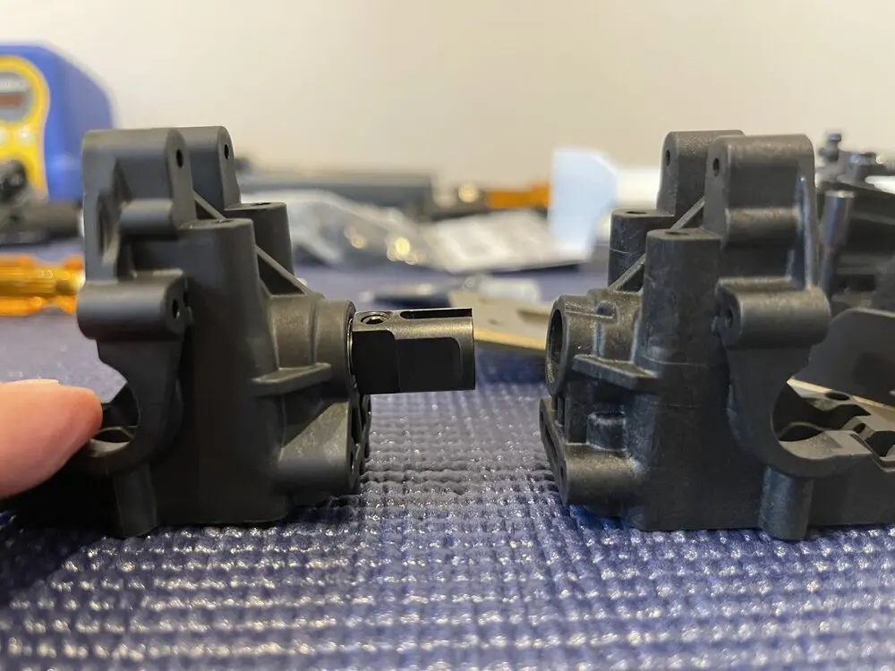

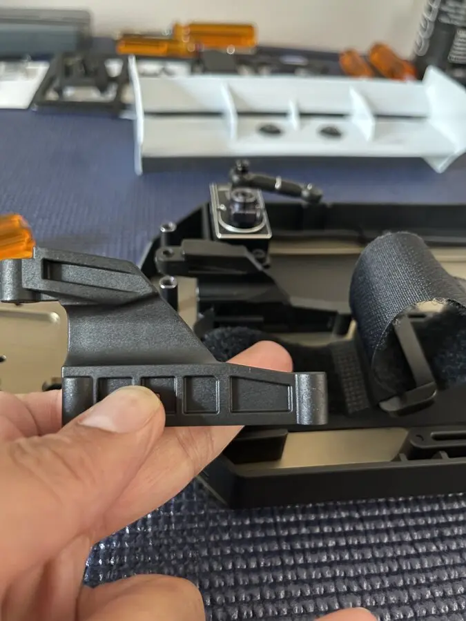

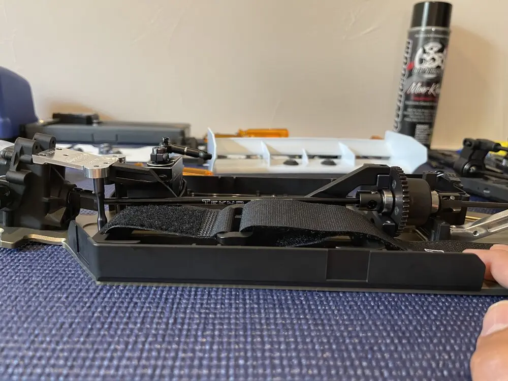

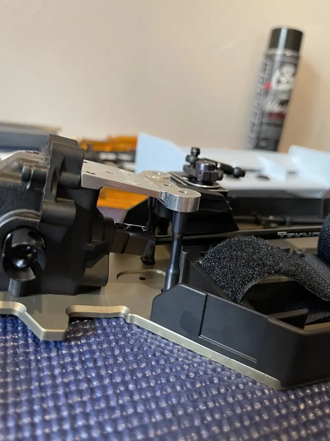

Definitely a change on angle for the differential pinion in the new front gearbox (TKR9412) also the new bracing that accommodates the change.

Looks like there making more room for the chassis to flex and not bend the front driveshaft. I don’t like the looks of it though that shaft is barely in the cup but um sure they tested it and tested it some more.
