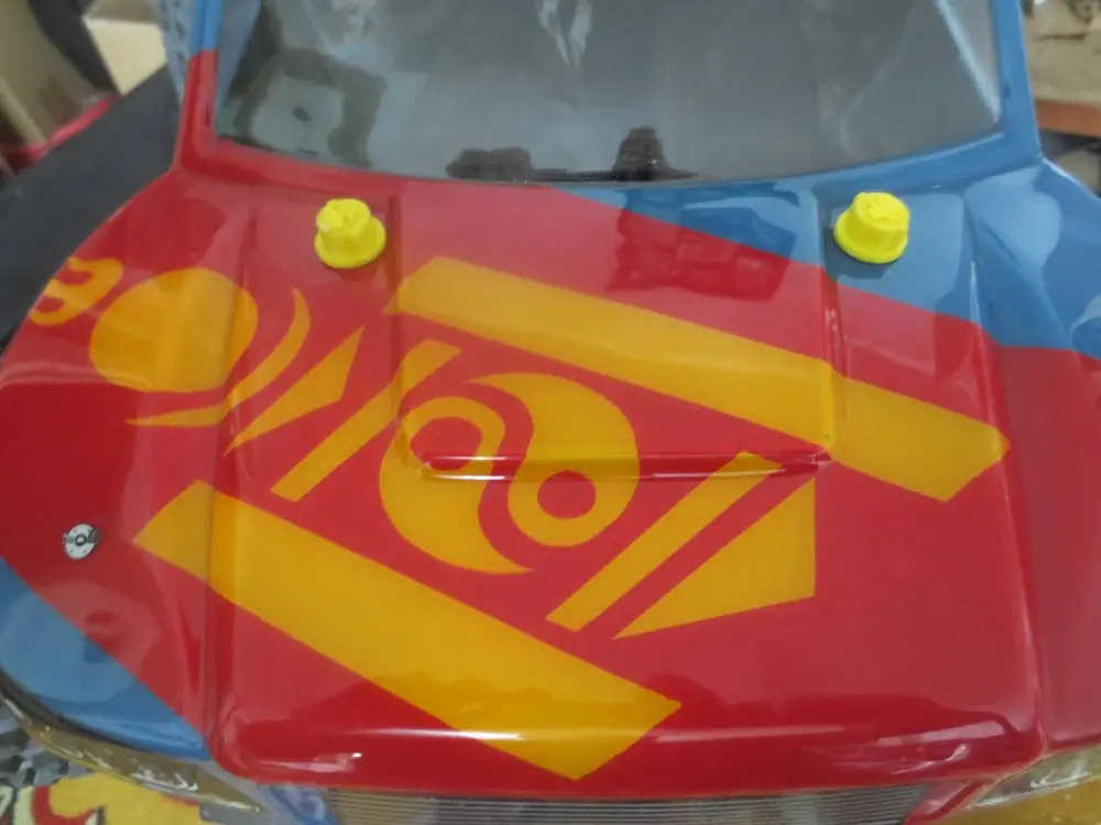

Hi from Ulaanbaatar Tekno fans,
Our MT410 is ready to rip (once the new motor arrives) on 6s in the and of the Great Khaan! Was running a SkyRC 1950kv Toro motor with the Max 8 ESC on 4s, but that motor could not handle 6s. We'll now try the Max 8/2200kv EZRUN combo, a couple of HV fans, two 3s lipos and I'll drop from a 16t to 15t pinion. We shall see. Whatever happens, this body won't last so enjoy the pics while it's pretty.

Looking good, what body is that?
Hi Buzz,
It's the Delta Plastiks 2mm SCT body. It is lined with gorilla tape. The wing attachments are cut out from mud flaps, very strong! We shall see how it holds up.
Man, that body looks great!
