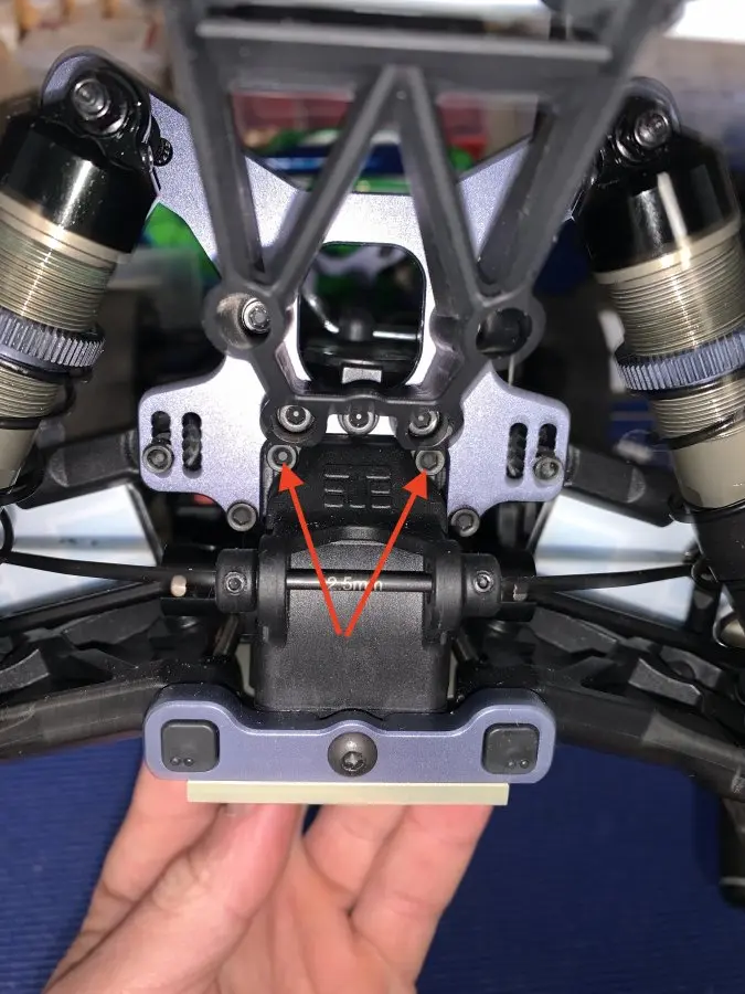

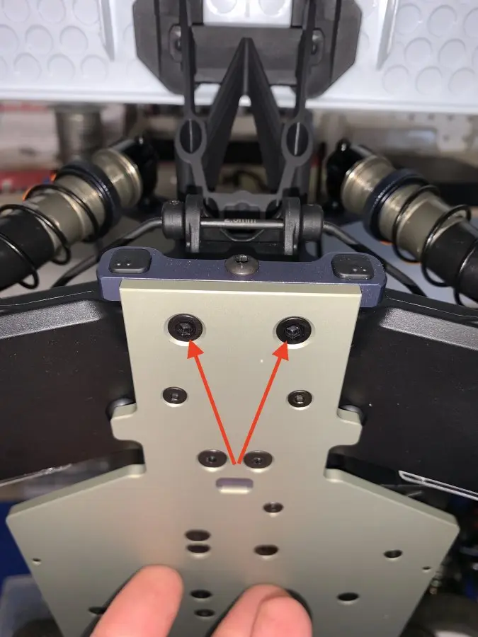

You only need to take out 4 screws and then loosen the sway bar grub screws to remove the diff cover.

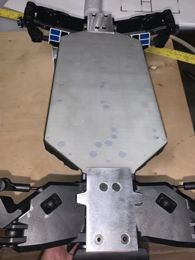

There are a few reasons we went wider. The first is to have more space on the chassis for electronics, specifically the ESC.

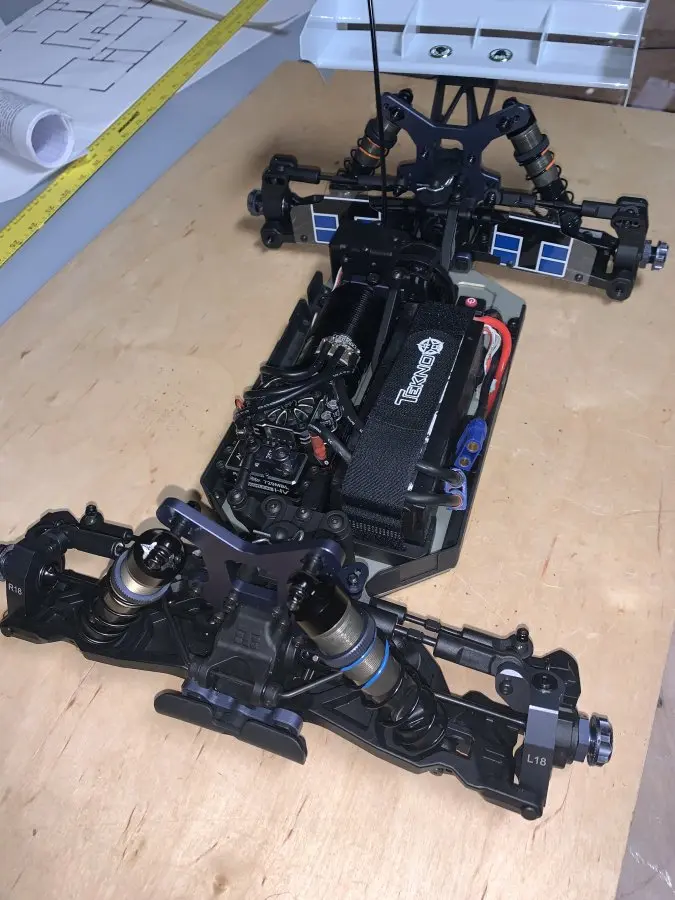

Hey dude, which ESC is this?
Did you shorten the sensor cable or is this the default shorter cable (4 inch?) included in the box?
ESC power switch is seated nicely!
Otherwise, the way you have run all wires is exactly how I envisioned doing mine.....
I am using the Hobbywing XR8 plus. I did not shorten the sensor cable, I just used some short ones (I believe they were 80mm, which is roughly 3") that I had already. I prefer to keep things tidy as far as wiring goes. I don't like a bunch of stuff flopping around inside the cab.
