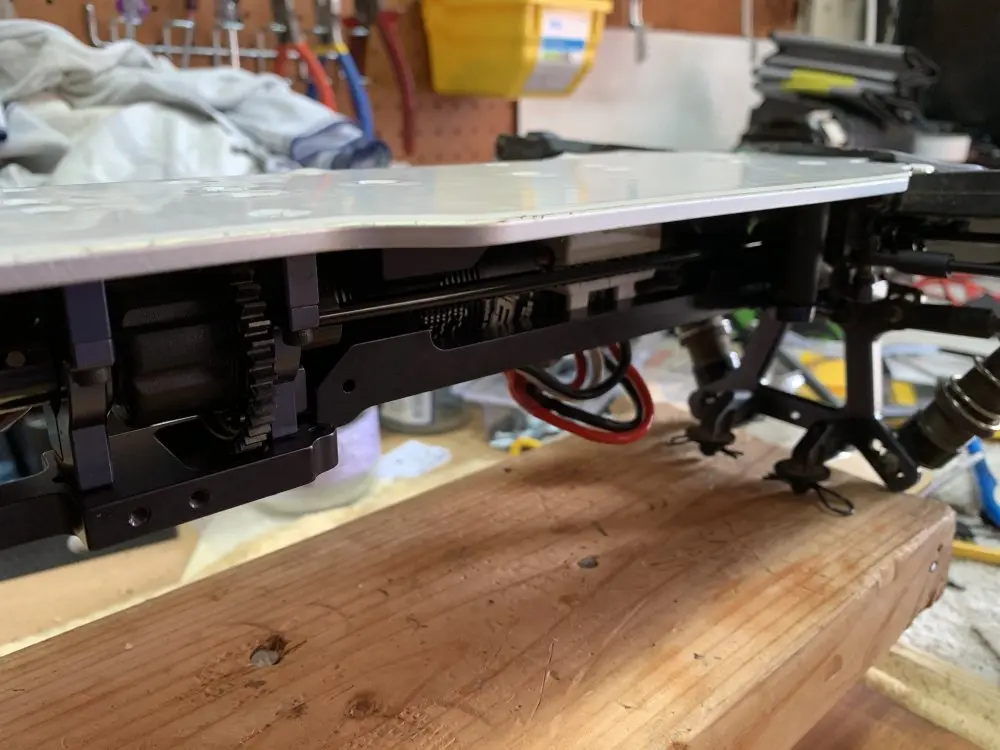

Some time ago I started looking for a way to protect my ET48.3 basher chassis. I tried car wraps / vinyl and very quickly noticed they are not strong enough.
What I was looking for is to create something that looks and functions like this:
3077
or this:
https://tboneracing.net/collections...thin-chassis-skid-w-vinyl-graphic-tekno-mt410
That's when I found this brilliant post:
https://www.rctech.net/forum/showpost.php?p=11817166&postcount=14
And ordered that material from McMaster.com:
https://www.mcmaster.com/7701T114
The result is the material that you can find under Snowboards and Skis:
3078
3079
I am very hopeful that it will prove to be a very strong protection. Will keep you guys updated.

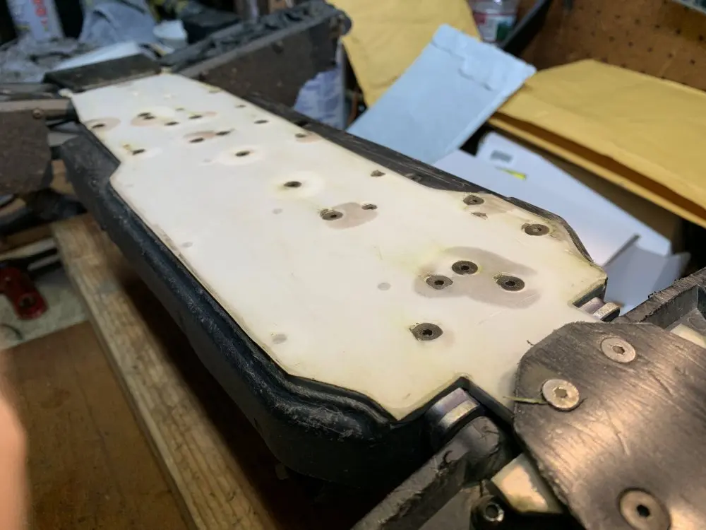

Here is the "6 months later" update on this mod:
This is the same truggy presented in the above post, I go through 2 to 3 packs every 2 weeks with this it. It is fair to say, this mod went through at least 25 packs by now. Driving style is mainly racing. Surface is a mix of loose dirt, hard packed dirt and some grass. Jumps were no higher than 5 to 6ft.
A few bubbles formed under the UHMW Plastic, but is not a problem:

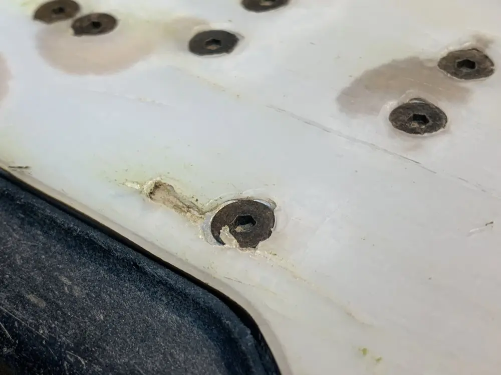

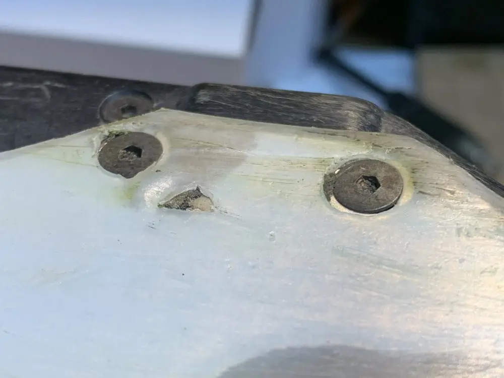

Two hard impact areas have creates significant damage in the UHMW Plastic, here:
and here:

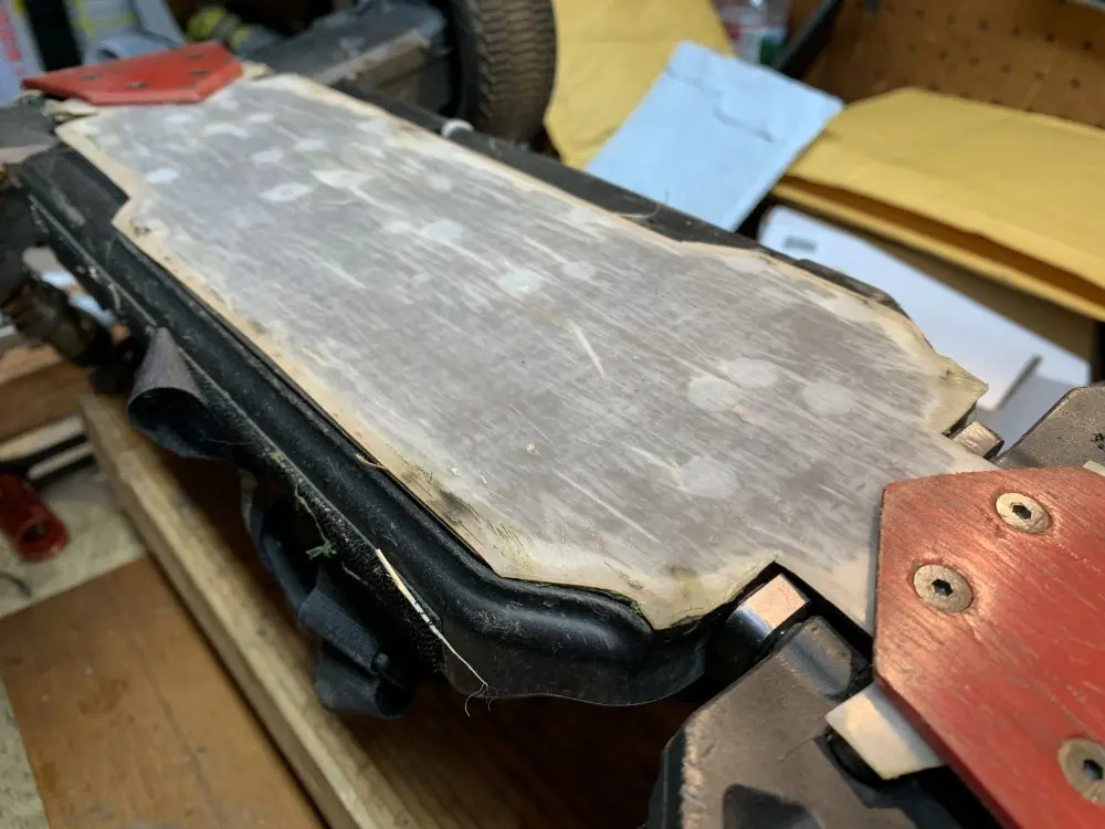

Optimization: here is a buggy that was treated the same way and which benefited from some experience. On this one I have not drilled holes for screws and have kept the surface intact. You can see the mod is doing a lot better.
Buggy EB48.4:
Same buggy:
Conclusion: for those who are a bit anal about their bottom, I would not hesitate to recommend the mod. It will have your back! :p
