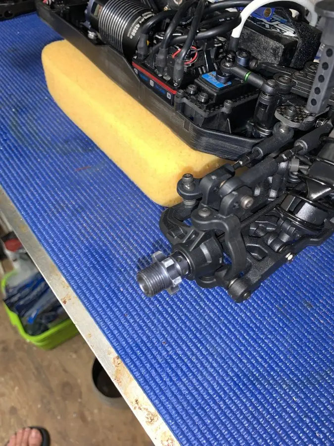

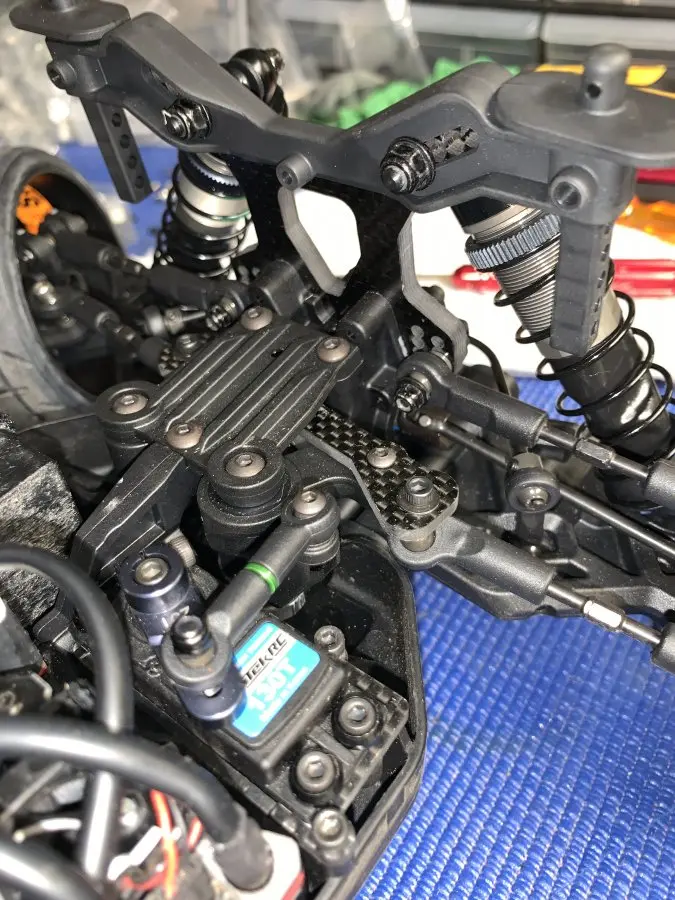

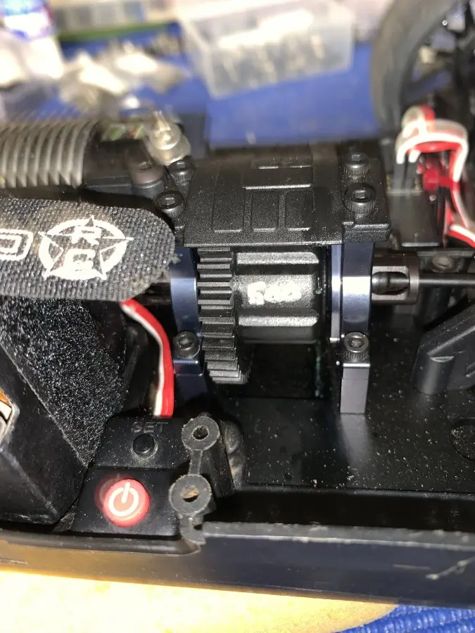

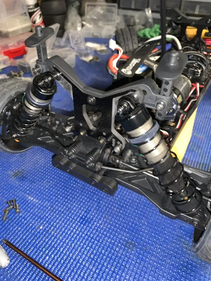

For now I am building it mostly as a stock EB48SL with the exception of carbon towers, .4 steering geometry w/carbon ackerman plate, aluminum center diff mount, bearing sleeves (on F,C and R diffs). I have front towers in both front and rear. The rear has front shock bodies built with rear shock shafts so I can get the down travel needed. I am not worried about the longer shafts since this thing will never see a jump, plus the chassis definitely bottoms out still before the shocks even come close to being fully compressed.

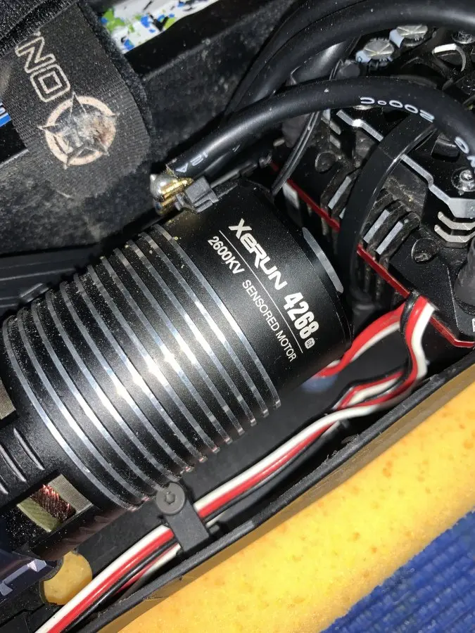

ESC-Hobbywing XR8 plus
Motor-Hobbywing 4268 2600kv

Servo- Protek 130 t

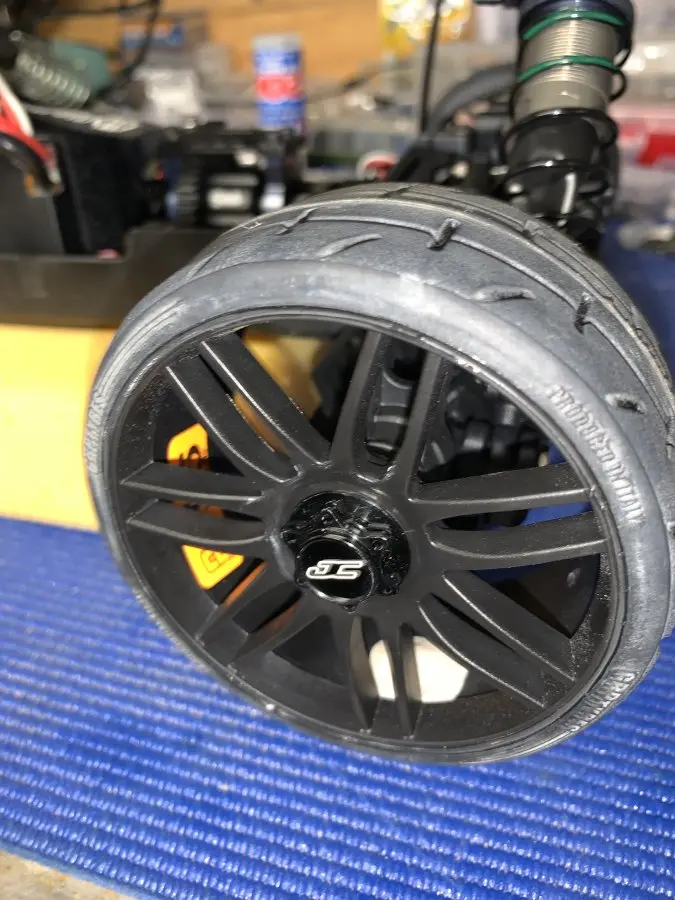

Running some GRP tires/wheels and may end up getting some foams too, but these will get me rolling. Running the SL 17mm extended hubs. Let me tell you these things were insanely out of balanced when I first put them on, but after some balancing I got them to spin pretty nicely in the end.
I will end up trying to find someone/somewhere to fab me up a custom chassis, a carbon fiber or an aluminum one, without the kick up in the front. For now I will run it like it is using the pills to reduce the kick up as much as possible for now. I also will be figuring out some custom shock towers in the near future, so I can run some other manufacturers shocks that are more appropriate for a lower CG, and will figure out a bumper mount eventually.

If I were to get back into GT8, I would definitely go with the shock package from Serpent and cut some custom towers, not sure it will be necessary to eliminate the kick up, but I'd definitely lock the front and center diffs for sure!
looking nice so far!
As far as shock packages I was looking at the shocks from the 988. Once I do get those I will be able to figure out shock tower dimensions.
Right now to start as far as diffs go I have;
F-500k
C-500k
R-60k
I may up the center diff and maybe the front to 1 mill, but it wasn't in stock last I checked at my LHS and figured 500k would be good place to start. Next time I head there I will check again. I haven't been in a rush for this build so I am being patient.
