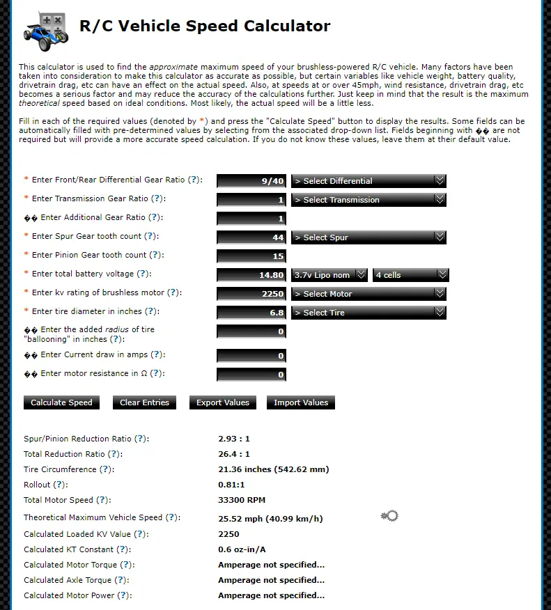

So im tying to pick a motor for my rig and had a few questions for you guys. My intention is to run mainly 4s but be 6s capable. Truck will see most likely alot of grass running so was trying to find a combo that will power it nicely without heat issues and am thinking of running the backflip MT's. Was wondering if anyone was running a tp 4050 with either the 1950 or 2100 kv? Would this suit my needs, am i right in thinking that a longer can would provide me more torque for the grass and be easier on the motor, know I'll have to relocate the esc but thats fine. Also Ive tried a speed calc. but the numbers i was getting didnt seem right to me but i could be totally wrong and they be right, lol. Do my numbers here look correct? Apreciate any adivse as I am pretty much a newbie. Also I know the kv is not one i mentioned but im wondering if the the other info i put in looks correct.

I will mostly be running on 4s, just wanted a stonger motor to keep temps in check and have enough power for the big wheels running in grass. I dont want silly speed something in the 50-60 range for the top end would be ideal but enough grunt to get me through on the low end. Already have parts on order to relocate esc so thats no biggie. just didnt know what KV to go for if i go with the tp4050. can anyone tell me if I configured the calc right as far as the gearing on scriptasylujm though?
think i put the gear ration in wrong on the front dif should it acually be 4.44? seems to make more sense that way
