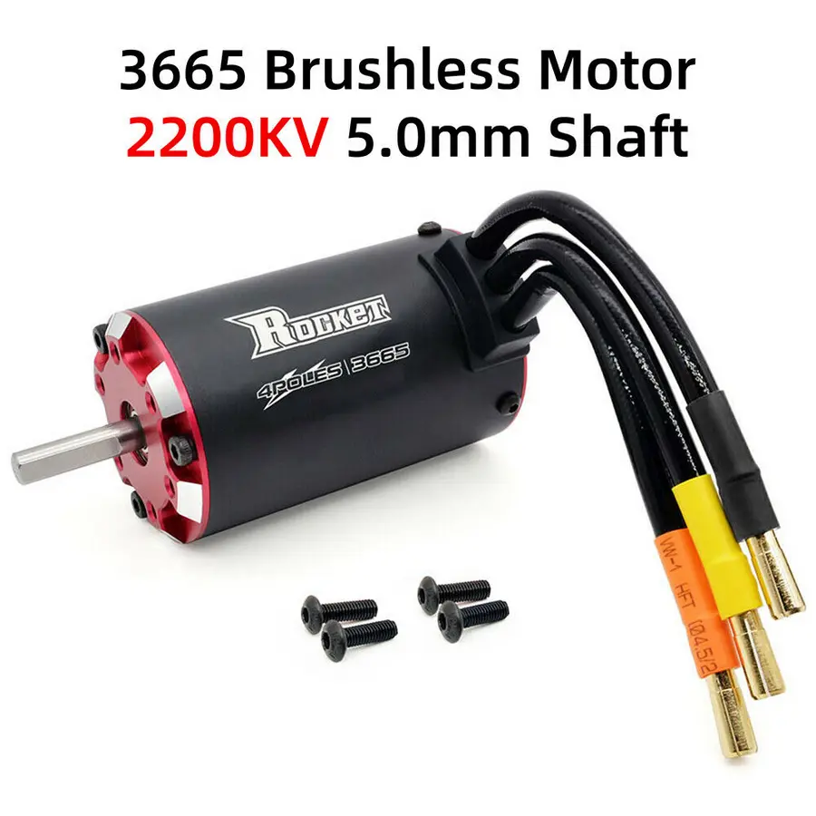

I'm leaning towards the 3665 size motor so as not to have too long of motor hanging off the motor mount. Probably will wait to see how much room is left over after getting WP-SC8 thrown in there.

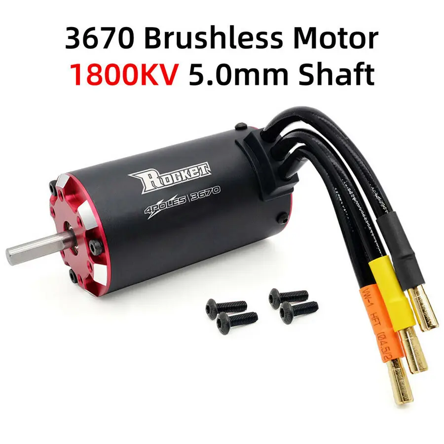

Definitely the 3670. It will work great.
I have mine with a 3674 and 2400kv, love it on 4s.

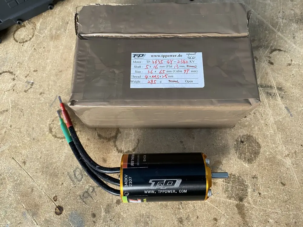

@Nicochau .. Just had a test run with the new setup with 15T pinion ( temps were around 128F ) maybe I'm too used to 6s but the truck seems slow 😩 I'm running 4s MMX and the 2340kv motor..
What pinion are you using on yours ??
I'm using 15T as well and believe am geared for ~42 MPH top speed.
Bear in mind that those SCT bodies look great but they parachute and are not meant for speed. I don't believe you can take such a body much above 50 MPH.
I'm not running a lot faster than 2s/3s setups, but do not need fans and have more runtime. You can probably push it a bit more to get more speed (like 16t or 17t).

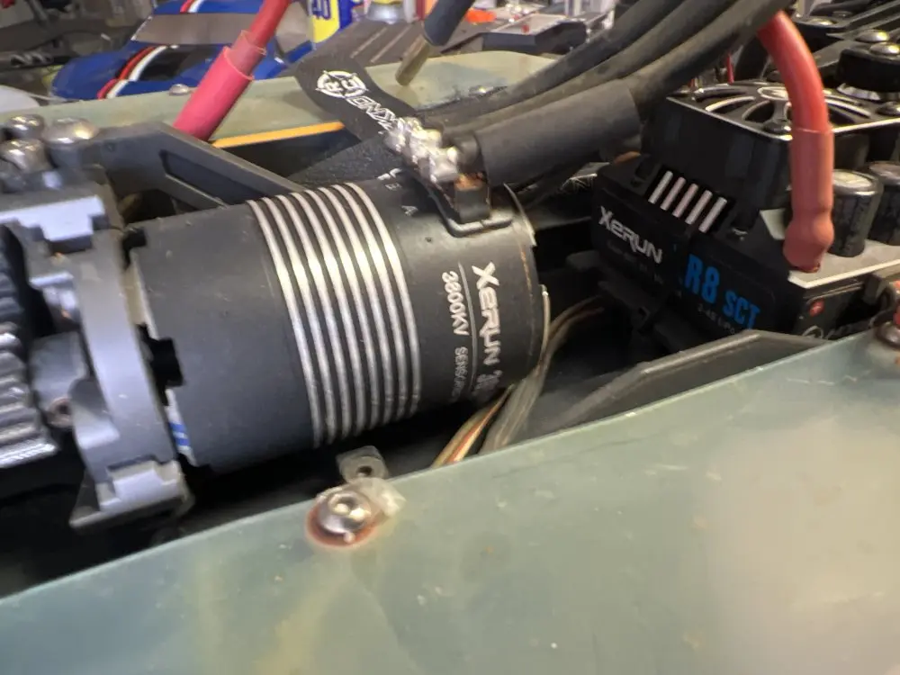

3652 sized motor can. Xerun XR8 SCT ESC. Been great so far. Probably have run around 4~5 8000mah 2S packs through this combo so far. Running in Tampa on crazy hot days. No thermal shutdowns yet. She running fairly cool all thing considering.
