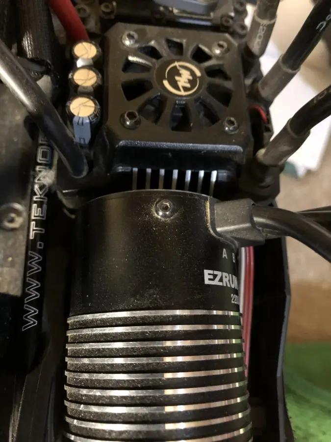

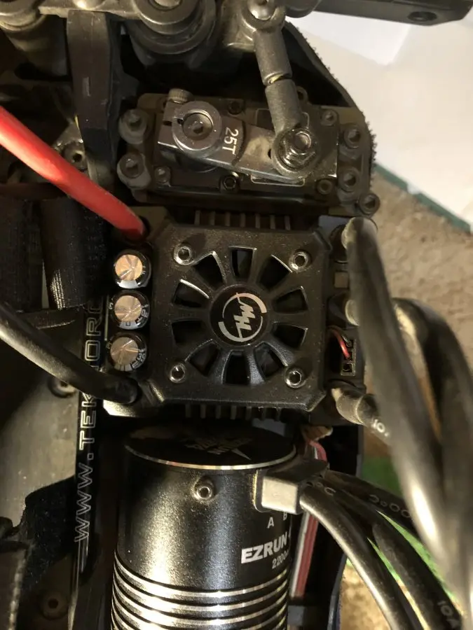

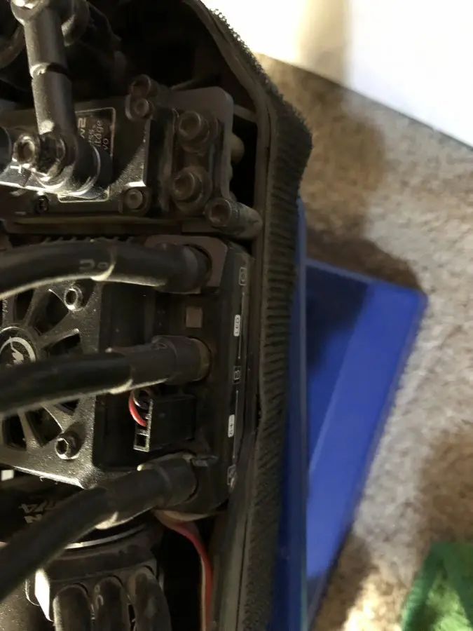

I am currently attempting to install the HW Max 8 ESC on my MT410. I noticed it does not fit smoothly up against the steering servo which results in the mounting holes not aligning correctly with the mounting plate. I feel like I read a while back I would be encountering this issue. My questions are:
-is this normal?
-what are the solutions to properly mount the ESC?
-are their any video links of HW Max 8 installs on the MT410?
-any good pictures of the electronics being installed?
Thanks for the help!
-Brian
If I remember correctly I had to cut the tabs off with a demel and smooth out the sides. After that no problems fitting.
