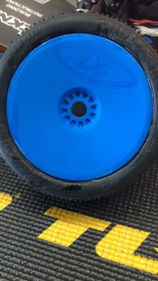

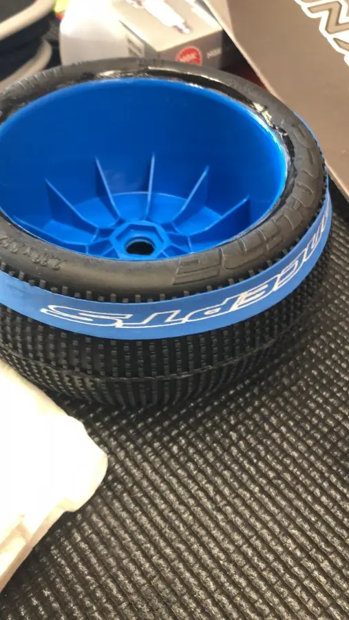

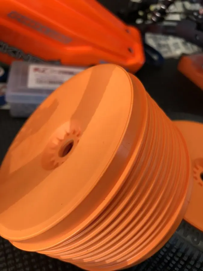

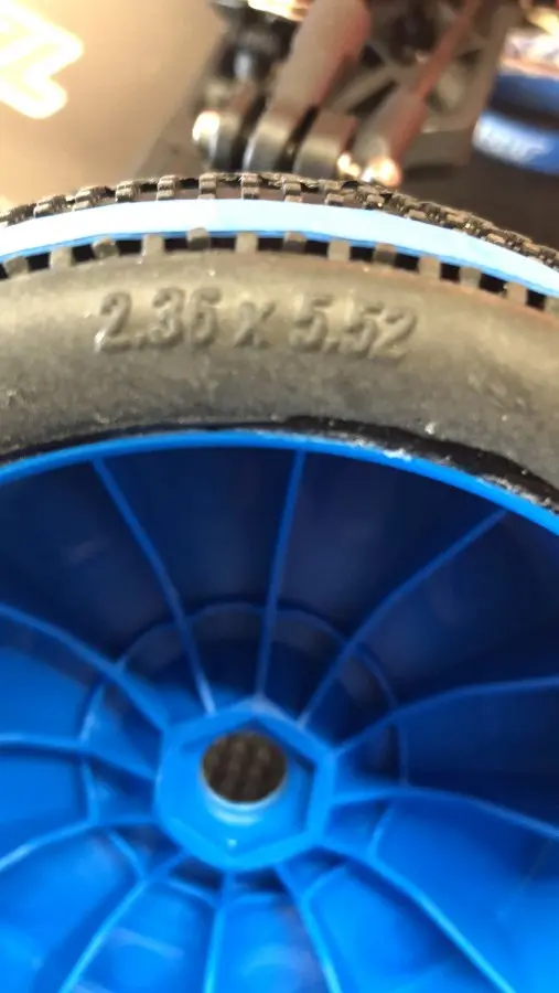

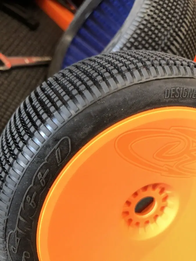

This is my first time flying tires to wheels and I am definitely not very good at it LOL! Also it doesn’t help that the JConcepts “thin” tire glue is not thin at all. It might as well be called sludge. I ended up finishing up with some Zap thin CA. I’m hoping they will hold up.
C119C290-0E94-4FB9-A33D-8CC2A23BB85D.jpeg013322CB-A07E-410A-B6E6-0F0EE1411A48.jpeg3D39ADD9-F6EF-4C2B-B2C9-C5461F02D7EC.jpeg8A41EC6D-9F99-4486-B48C-EA6CB09B29BE.jpeg
Also doesn’t help that the proline tires seem to have a crappy mold or something. The bead was not flat at all. They would not lay flat in the wheel for anythjng. Yet I also have some Sweepracing tires that sit perfect without a drop of glue put on them yet.

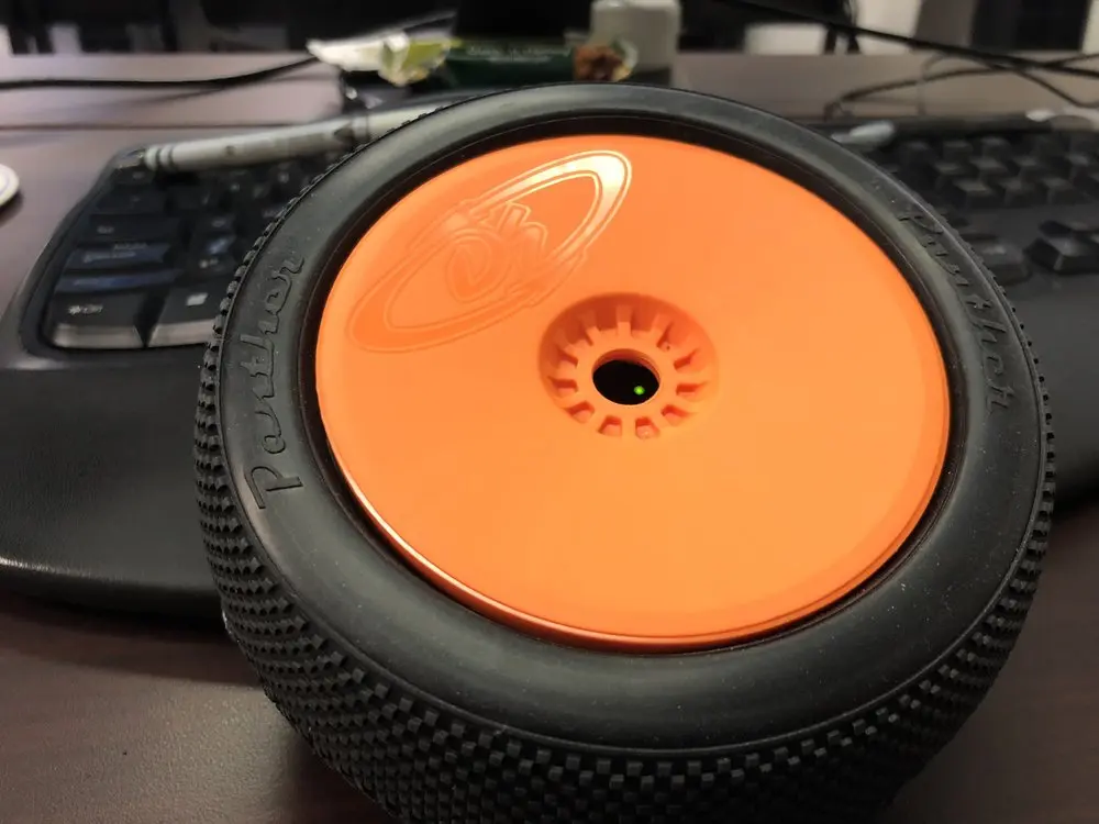

Ooh I have some zap thin. Might have to try that one too. I have a feeling the worst part for me this time was the tires. It seems proline tires are molded a little different and are matched for their own wheels. I talked to Dave at DEracing and he also told me proline tires are an issue. However the sweep I have and aka and jconcepts he says will fit fine. I know he sweeps do, I also want to try some panther tires (mainly because they are made here in Riverside).
C953CC70-8FC2-448D-9CB7-A59E3F7C9408.jpeg A9DE60C0-5433-4FB6-88F2-F53D2E36455E.jpeg
These do not have glue on them yet and they look perfect.
So while holeshots are recommended at my local tracks I need to find the equivalent from other brands LOL!

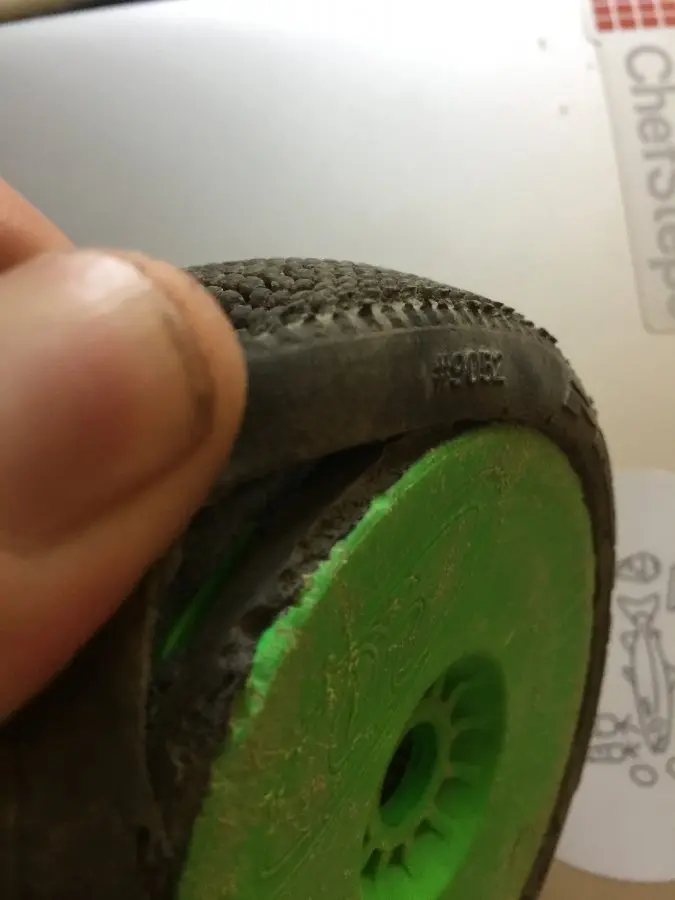

I have glued up every set of tires I have owned except for the first set. None of mine have failed at the glue with the method I use (knocking on wood now after saying that of course!!).
I am sure you know this, but ts pretty important to wash your tires and rims before gluing up. There are coatings from the manufacturing process that can cause the glue to not adhere properly.
With CA less is more all you need is to have the surfaces being glued to have a very thin coat. That is also why I like the thin stuff, because it runs really well and coats very quickly. I have never had a tire come un-glued with this method, in fact the tires fail before the glue does.
These are Pro-line fugitives on DE wheels, no glue failure here. Being the fact that the rubber tore tells me this glue-up method is very efficient. I did notice the pro-lines seat slightly different as apposed to AKA or JC's, but nothing you cant get around.

I've had tires RIP like that too, that's a reason i try to avoid soft racing compounds! As a basher, I always go for medium at least if I can. I'm guessing those must be soft if not extra soft to RIP that badly?
They were X3 compound wich are their soft but extended wear compound. So somewhere between soft and medium really IMO, but yes on the softer side.
Ok so I read through all that link and also used a different CA today I had on hand. It’s just Zap thin CA. Much better results this time. I’m actually liking the thin way better, now that it’s actually thin consistency (like water).
Also helps that Panther tires aren’t molded all stupid like the prolines. I have more wheels on order too, since I have at least 3 more sets of tires to mount LOL!
