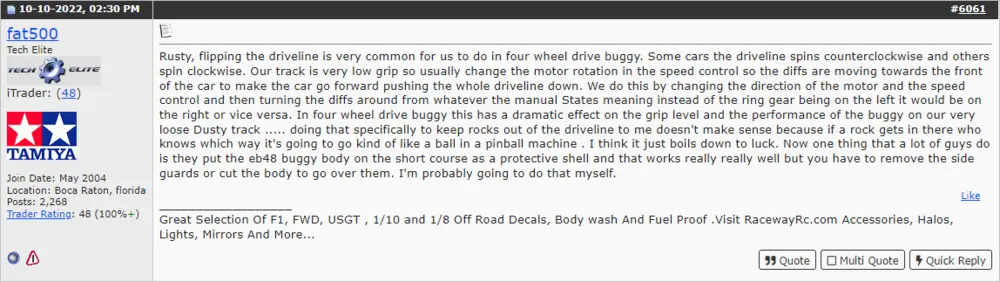

One response I remember was, "because the EB guys are doing it." 🤷‍♂️ 😁That meant nothing to me. Another response was...
Thanks, I also saw people saying the buggy guys were doing it for traction. But I didn't understand how it actually worked. The post you shared from fat500 helps. Maybe I will try it later this year, have some other tweaks I'm trying at the moment.
