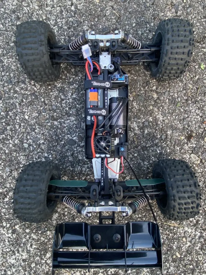

I did an MT48 build with a HW Max6 combo and it’s pretty nuts. On paper it’s the fastest rc I own. However running it a couple weeks back the front diff started making noise. Couldn’t easily find the issue while out bashing. Continued to run it and after a weird landing where I grabbed throttle as soon as the truck hit the ground I broke the front bulkhead. The pinion gear pushed back out of the bulkhead and broke the retaining ring for the bearings out of the housing. I’m running a 24t pinion on a 1650kv motor so I have been expecting carnage. It has a problem keeping tires together.

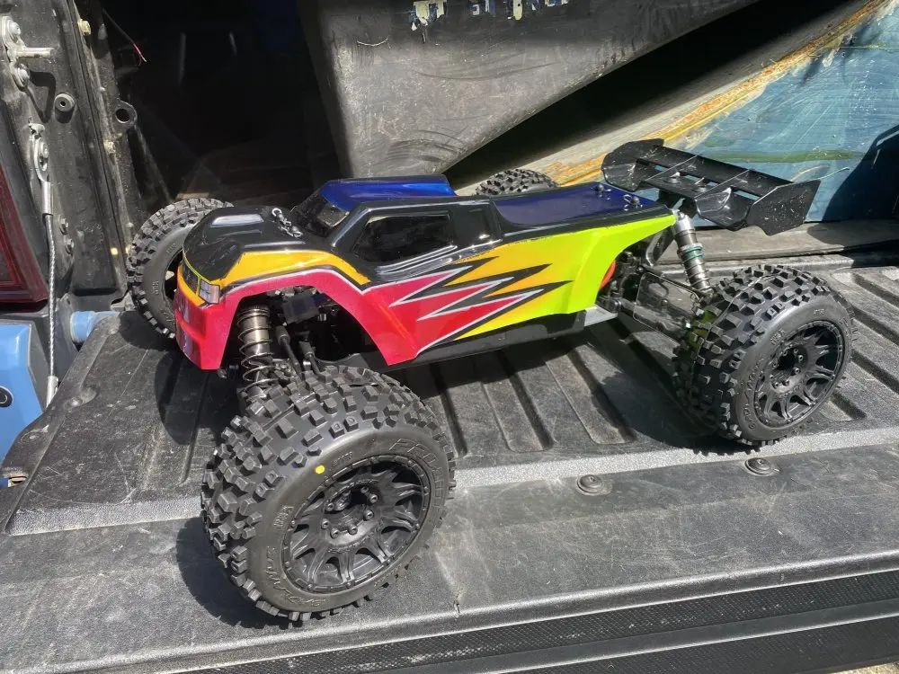

I have a mt410 I converted it to a ET4.8 I run it on 6s with stick diffs never had a issue with the differentials.
I run my mt410 on 6s and my other mt410 that I converted to a electric truggy both 6s or 4s depends on how I feel and the gearing.
You just need to know how to drive the truck. Don't take off on heavy throttle take of easy and also when doing wheelies you don't want to hit the throttle a lot or the front wheels can spin a lot faster and that can also cause diff issues.
