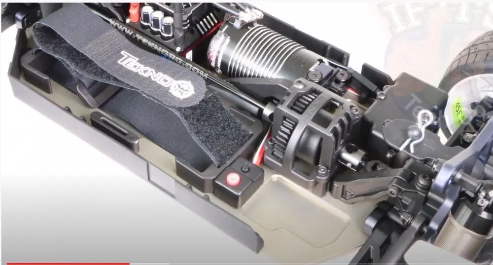

On my ET48 2.0 I plan on running a Protek 370TBL (same as in my MT410) and Arrma Backflip 4S.
@Lynny posted this pic. I think I asked what the offsets were back in the build thread.
Post in thread 'Tekno ET48 2.0 E-Truggy : COMPLETE VIDEO BUILD GUIDE'
https://www.teknoforums.com/threads...gy-complete-video-build-guide.2190/post-18401
I’m also swapping out my diff fluid from stock so far I’m considering 60-100-30
Had to go back to the manual! lol
Stock build comes with 4mm Hex front and 2mm hex rear, so the Backflip LPs should be fine with the stock build I hope ;)

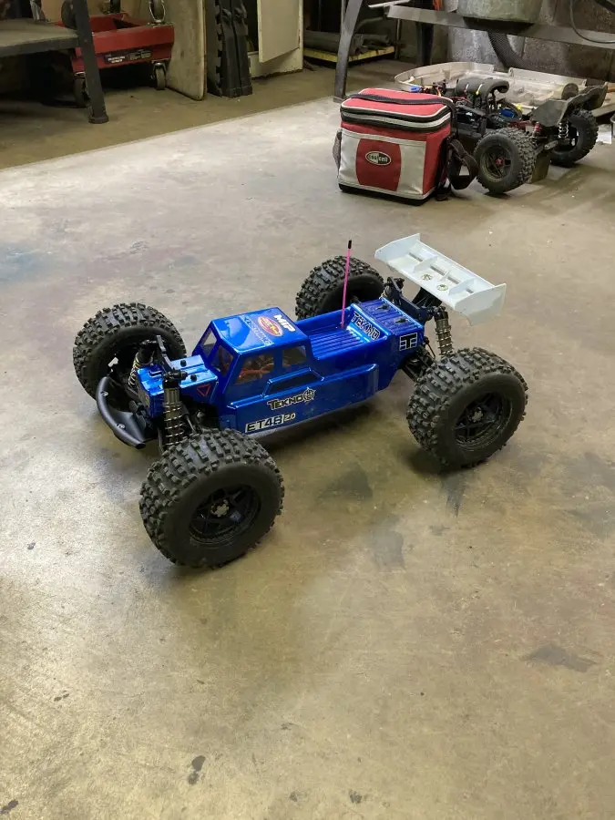

Yes backflip lps fit no problem they just clear the arms with the included plus 4 hex um runnin 50 200 20 fluids the thicker center is to cut down on ballooning of the 4s backflips. There’s just enough suspension travel to run 6s backflips also. Photo is with 6s backflips

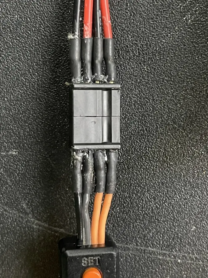

If your going with HW ESC and the motor you’ll have the same issue I did.
There’s nowhere good to mount the power switch.
I cut the wire, extended it to run into the battery box, mini 4 pin deans connector so it’s removable.
Throw some silicon under the shrink tubing to seal it up when it shrinks.
And cut a hole out the back of the battery box so I can mount it to the rear of the box, accessible with the body on but won’t be able to be knocked off by anything.
trial and error on the holes... need a new box now.
If you can find somewhere to mount the switch might need to do something similar.
I’ll post pics once I get it all finished.
How are you finding that fluid setup??

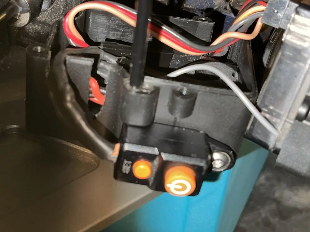

Cheers dude - with my EB48 I was able to run the power switch so it sat just behind the battery. Was hoping to do the same with this one, unless it has a shorter power switch lead then the XR8 Plus I ran in the EB48.....
QuarantineRC
22
24
Yeah that’s a good spot for it if the lead is long enough. My ezrun and firma esc both have super short leads.
So far it’s pretty good the thicker center keeps the front tires from ballooning and it turns on a dime. Um limited on the fluids I have but so far I like it.
