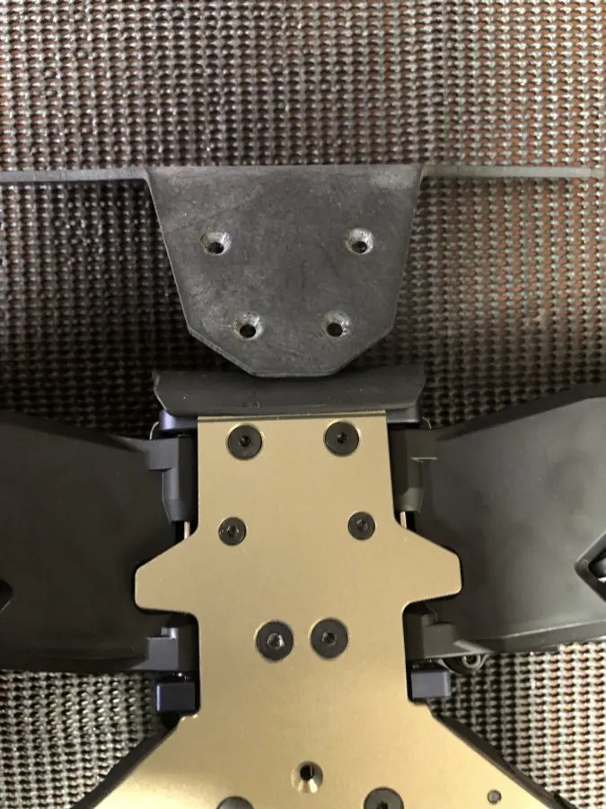

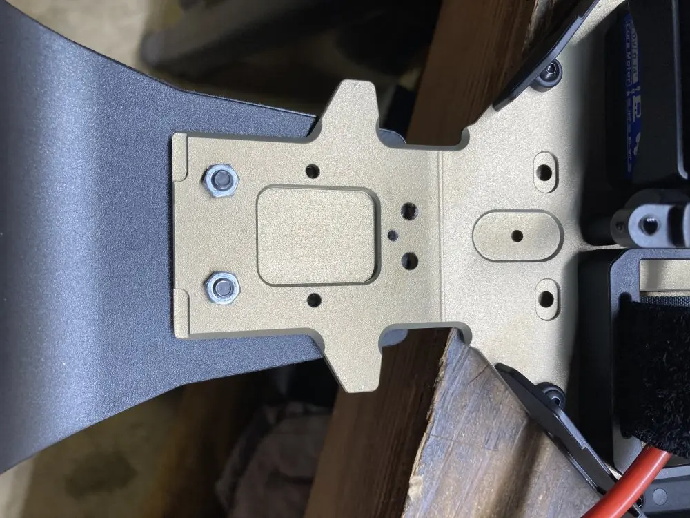

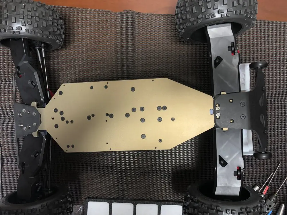

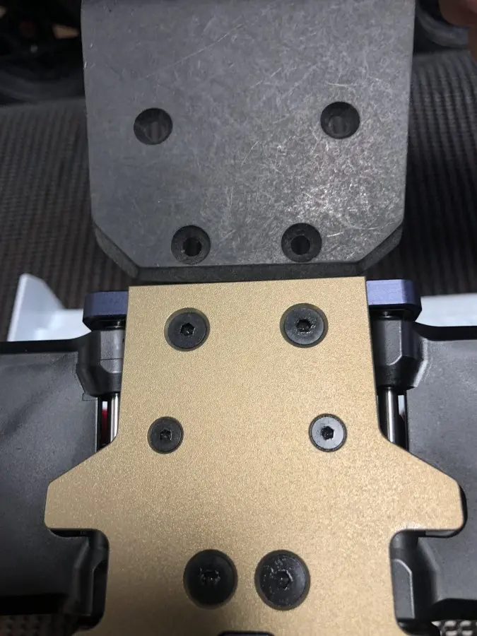

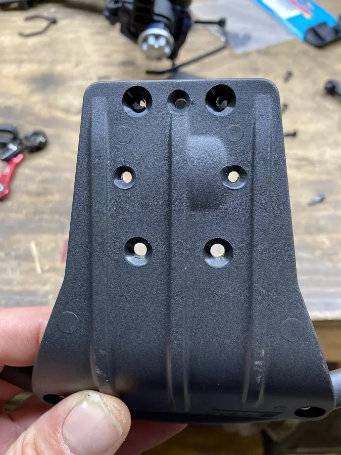

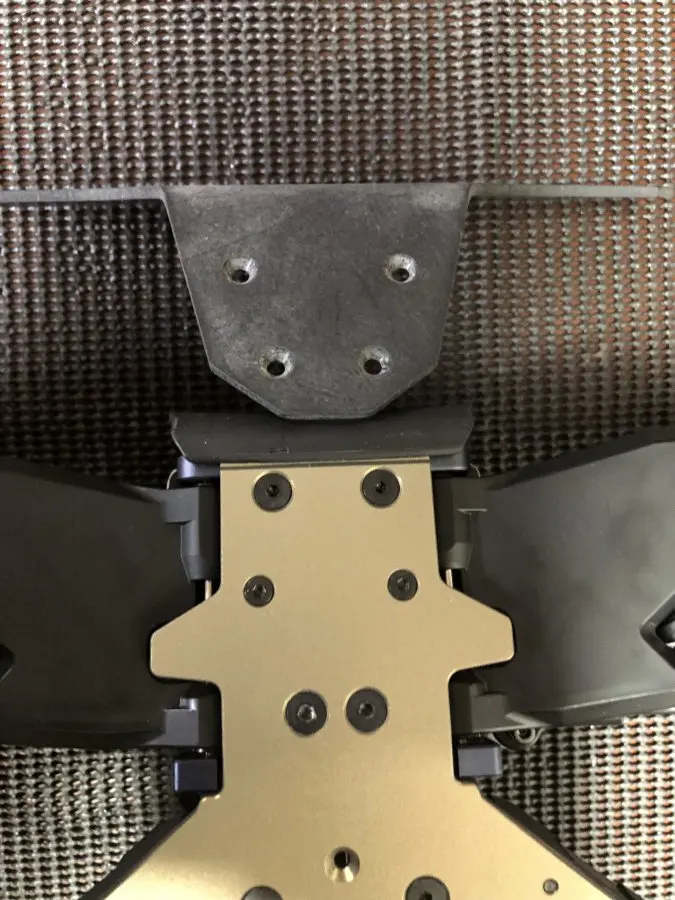

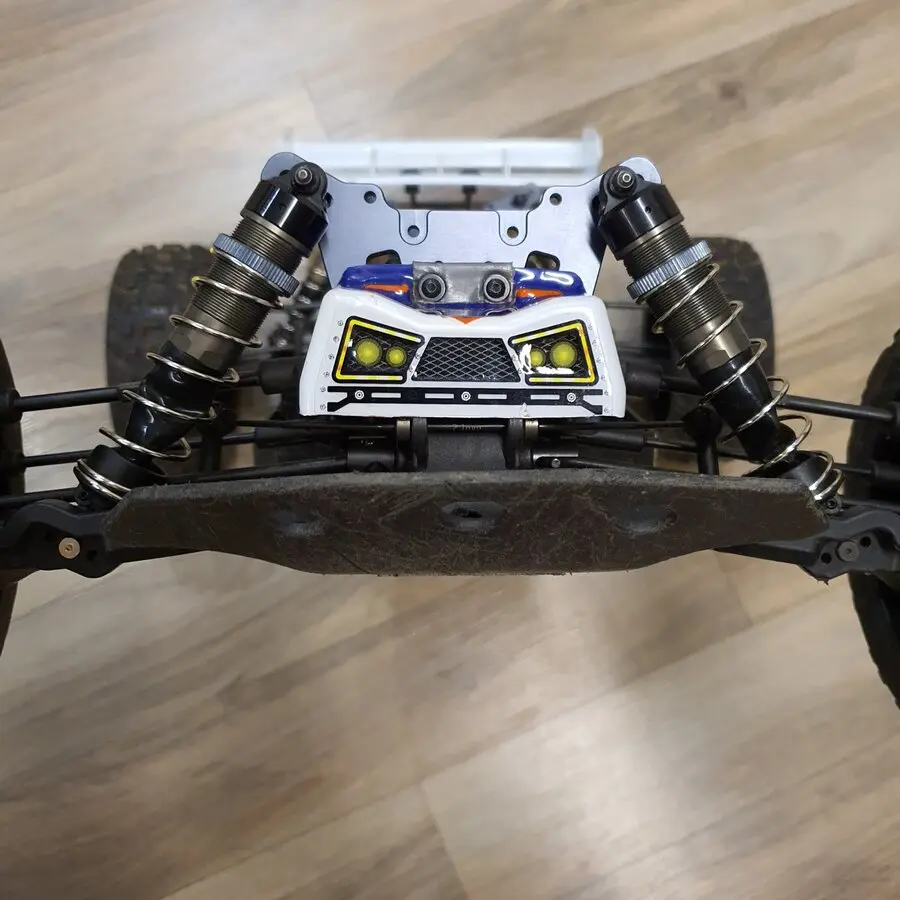

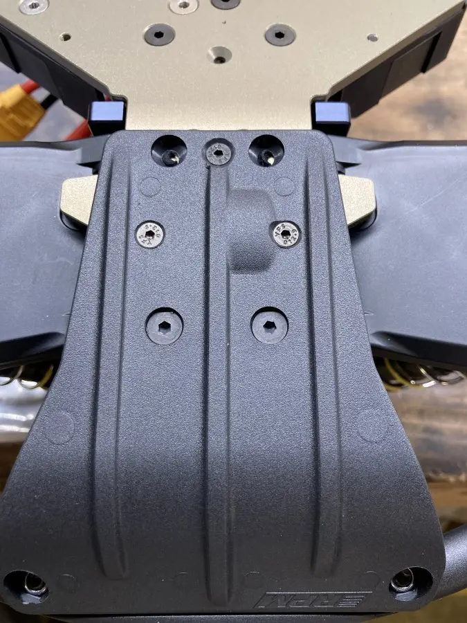

Adapted a RPM arrma kraton bumper to my new et 48 2.0 very easy to do. You will need a 3mm tap two m4 by 22 flathead screws the rear center hole is drilled and tapped into the chassis.

It’s very easy I will be doing a build thread in the next few days and explain it in detail so anyone can do it. Are you getting the 2.0

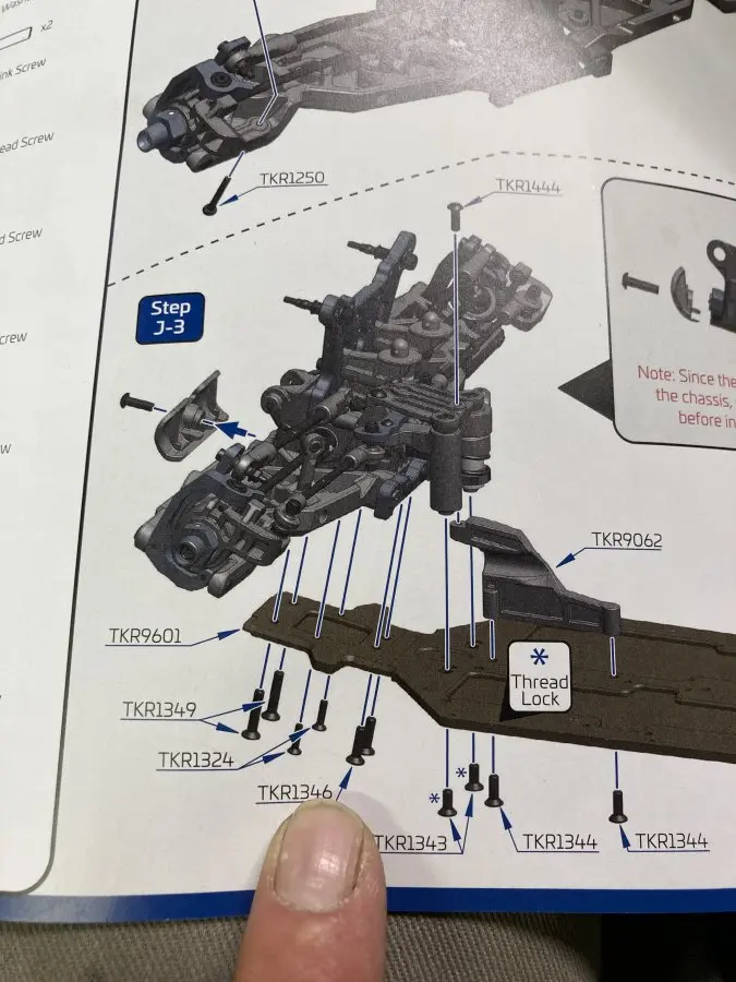

Awesome you’re gonna love it. The biggest thing to watch out for is installing the rear bulkhead to chassis mounting screws TKR1346 they get very tight use chapstick on threads and work them in and out as you go or you will round out the hex head.

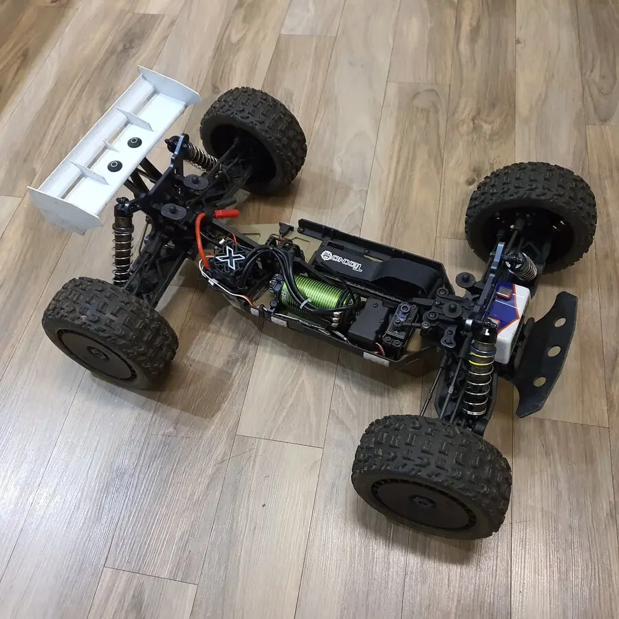

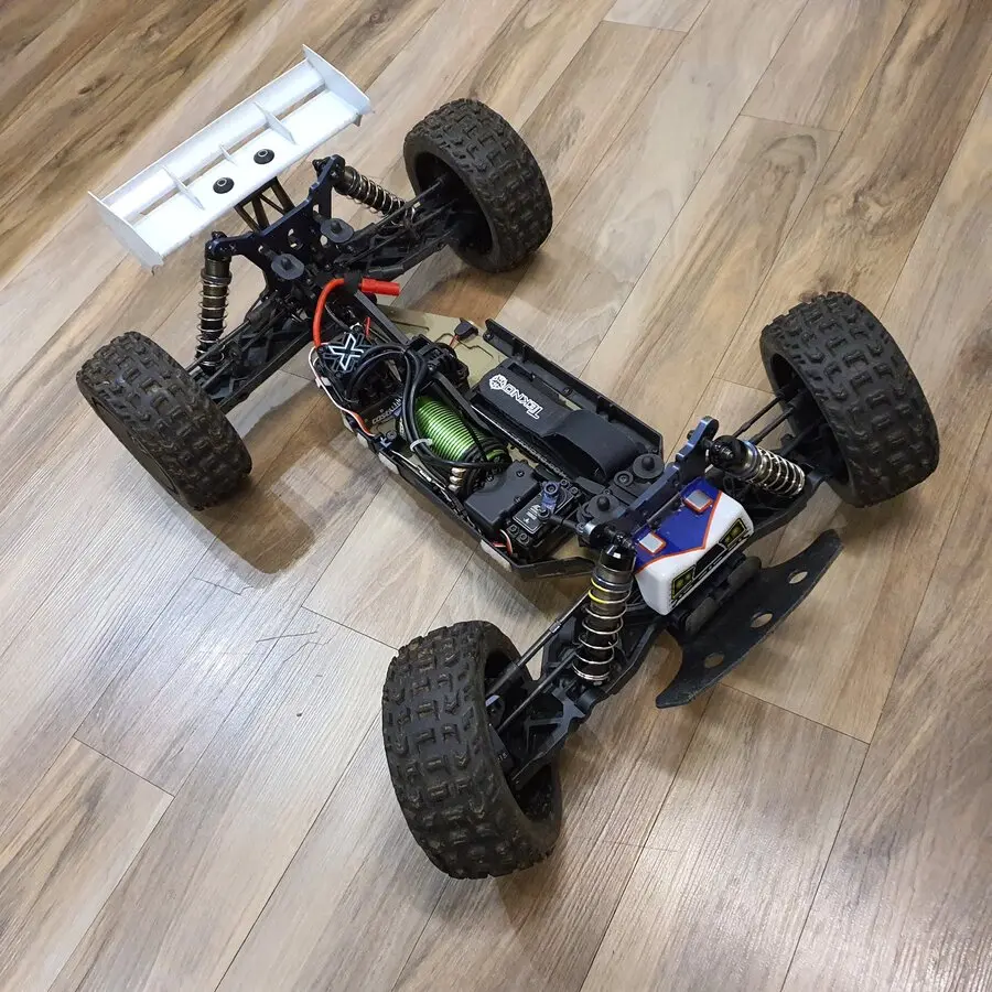

Lynny can you please post a pic with the wheels on it when done. I like that front bash bumper. I have it on my mt410, like to see how it looks on the et with wheels. thanks bro.​

Look under my build thread pics there

Thanks bud I explained it thoroughly in my build thread it is really easy to do.

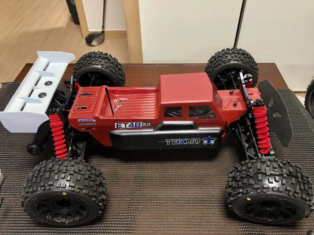

Rils
11
13

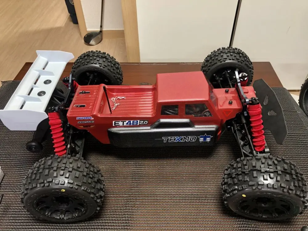

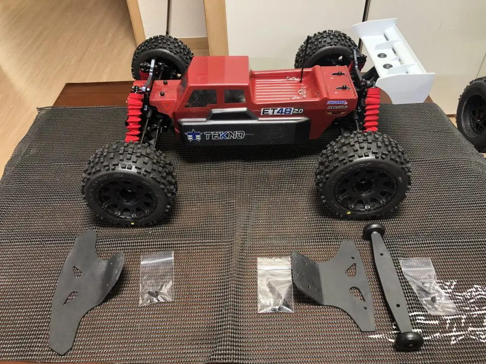

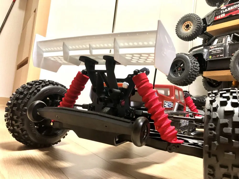

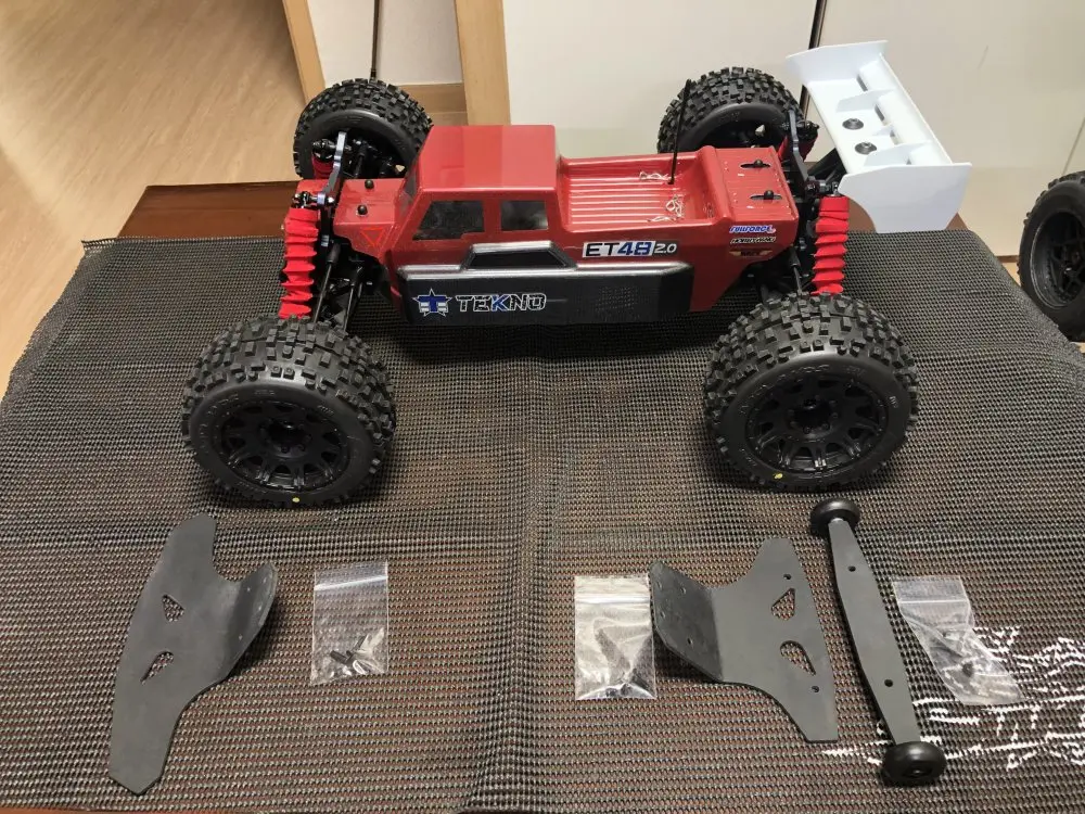

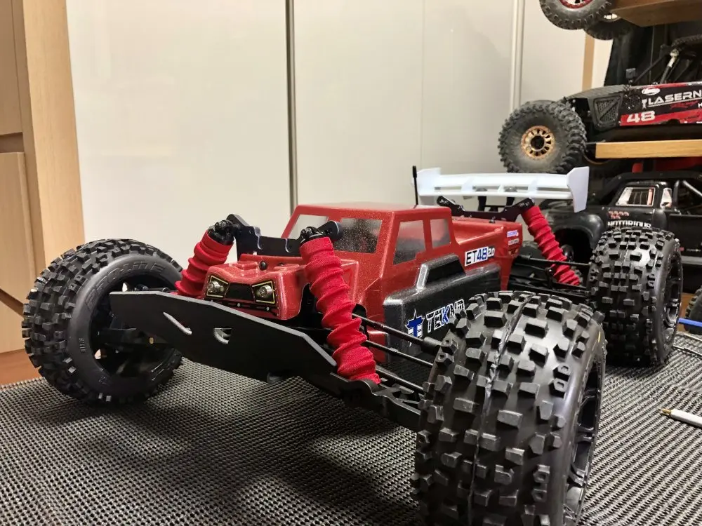

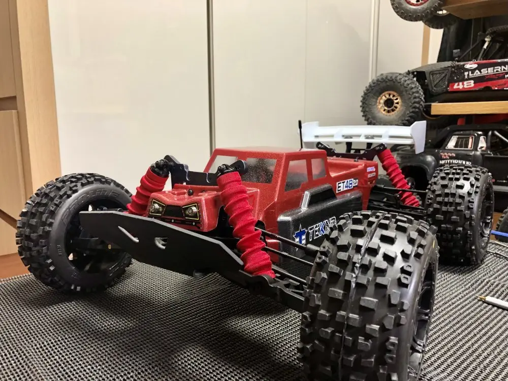

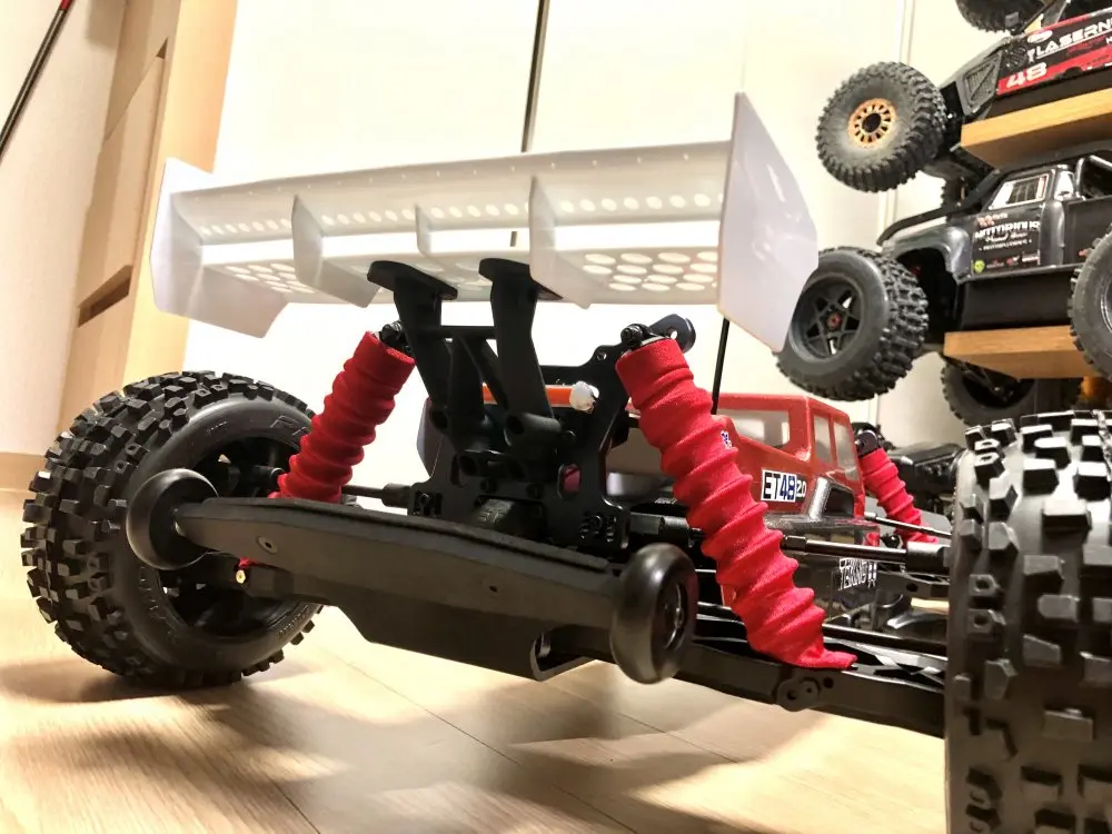

Lynny, your ET48 looks awesome!

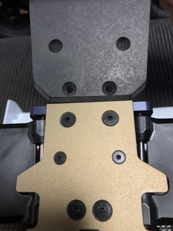

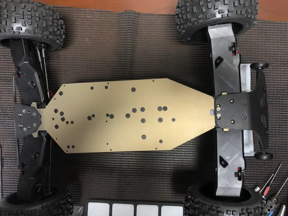

I did mine using T-Bone ET48.3 bumpers and wheelie bar.
Bolts layout was totally different. Drilled and dremel some.
Front
Rear
Adapted
Hope T-Bone makes stuffs for 2.0 soon.
Front
Rear
Adapted
You did a nice job on the car and the bumper mod looks good glad to see someone using there head and hands to get what they need.

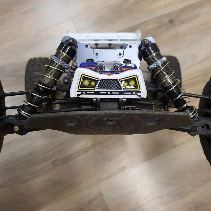

I just re-purposed an old Arrma bumper this afternoon then I found this thread, you guys did a fantastic job, well done! Mine is pretty poorly executed, but will do the job for now. I have loads of them lying around so I can try and do a better job with the next one.
Front
Rear
Adapted
Awesome job. Do you have the part number, I’m searching t bone and they have a lot differents ones.
does it hold well the bad landings?
Thanks
Rils
11
13
Thanks
Yes. it holds good.
But you’ll need longer bolts to install them. Longer 5mm each than stock bolts.
T-bone part number: 57007, 57010

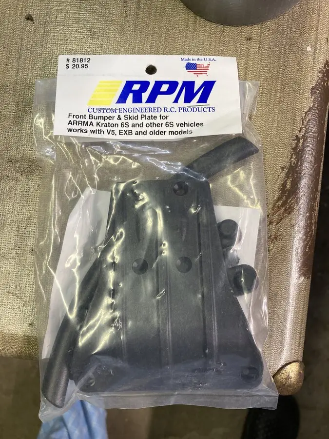

Can you post kraton bumper part numbers? The ones I'm finding don't look like this. They look smaller.
You can use 81812 or the older 81472 these are both rpm part numbers. If you look at my build thread et48 2.0 Basher build I layed it out step by step it’s really easy to do. If you do use this bumper get some 4by25 flat head screws to hold the front cover on the kit 4by20 don’t have much holding power.

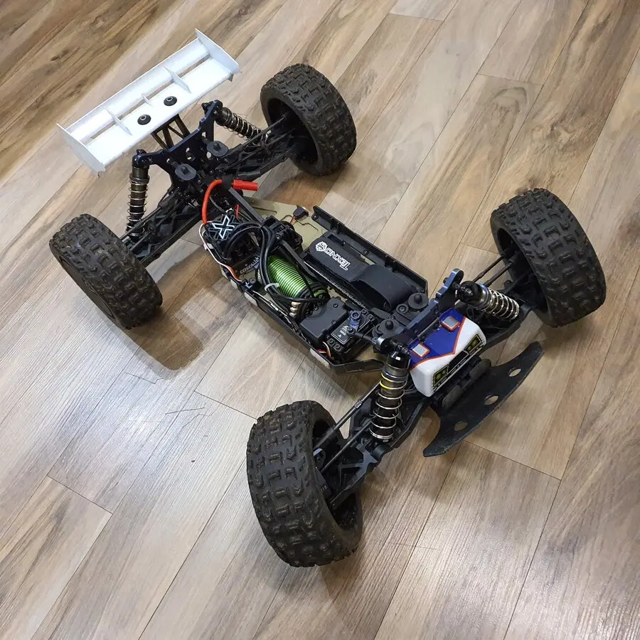

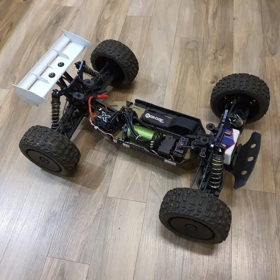

View attachment 7147 View attachment 7148 View attachment 7149
How is your ESC's placement doing? I'll have to do the same thing on mine. The TP 4070 is waaaayyy too long lol
