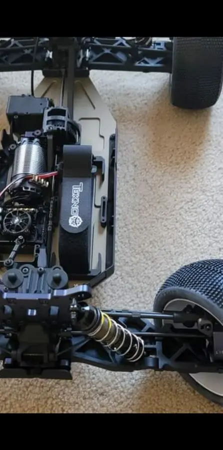

I have no experience with these tires, but the ET48 2.0 has cutouts in the arms for larger tires. If you did need more clearance Tekno makes extended hubs.
Attached is a picture of the front arm cutouts.

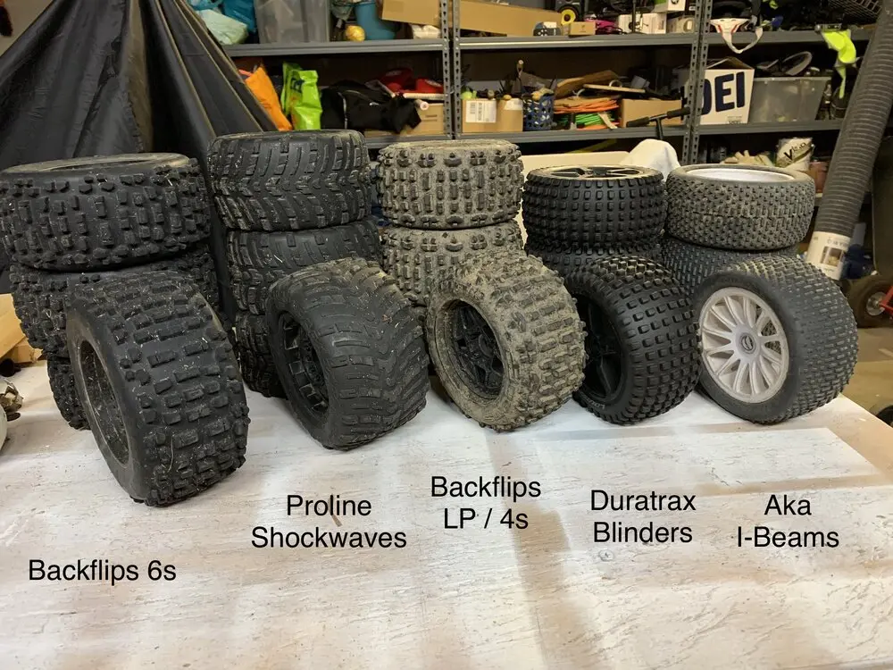

3/ tires are not a one-size-fits-all deal. To each use, specific tires. I have the Backflips 6s and believe they are great. They provide amazing air control (being so tall) and decent handling. The MX38 are far too heavy for my liking, but may work for you. Weight in general, hurts handling and is a liability to your driveline.
Here is a selection of tires I use for bashing:

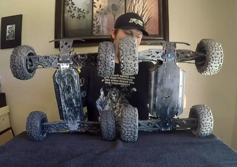

The MT410 chassi is from the SCT410 which is a 1/10 scale, the arms etc are from the ET48/NT48 which is 1/8 scale, which makes it a bit shorter but keeps it wide and perfect for bashing. On the picture you have the MT410 on the left and the 1/8 Notorious 6s on the right.
Either way, build the truggy and enjoy it! Can always get the MT410 later on if you want a nimble and super driveable/controllable monster truck basher.
Picture is from this video
