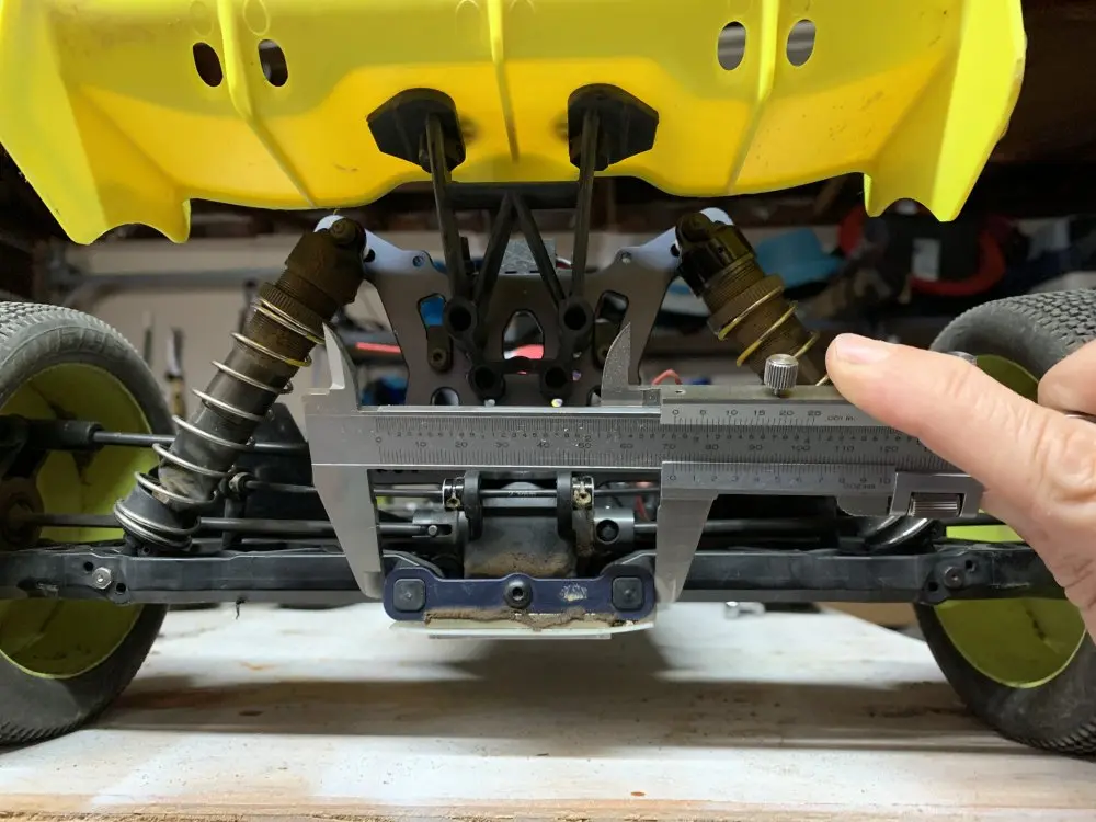

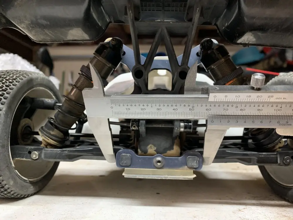

First of all, I applaud you for building and hopefully documenting the first MT410 2.0.
Here are a few pics from my EB48 2.0 and ET48 2.0, chassis should be compatible but A, B, C and D blocks won't. You can also see how much shorter the rear shocks of the EB48 2.0 are. They changed that on the EB48 2.1 and reverted to the full size backs if I'm not mistaken.

@Nicochau Thanks so much for this very helpful info. I just helped a friend build an MT410, and I loved the way it drove, so I thought about converting my EB48 into a similar vehicle. I had (mistakenly) assumed this would be a drop-in sort of build. I'll have to re-think this in light of the great feedback you've given. I thought the EB48 chassis (and more importantly the suspension blocks) were identical across platforms. Clearly they are not, which means a lot of added effort + cost to get things where I'd like them to be. I'll have to re-think this.
Thanks to everyone who replied - much appreciated!
