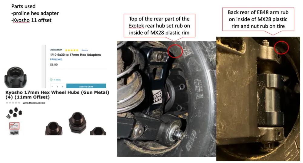

Here are the parts used to extend and the two spots I'm rubbing. The Kyosho hubs weren't great and it looks like I need a few for MM or need to make some slight other changes.
I'm not positive the 11.5 offset will work alone, maybe a another few MM? What do you think?
Yeah to get those 2.8 wheels to fit you need the hex hub extenders. The part number eludes me but it’s what I used on my db48. It’s a .3 using the buggy arms and everything.
