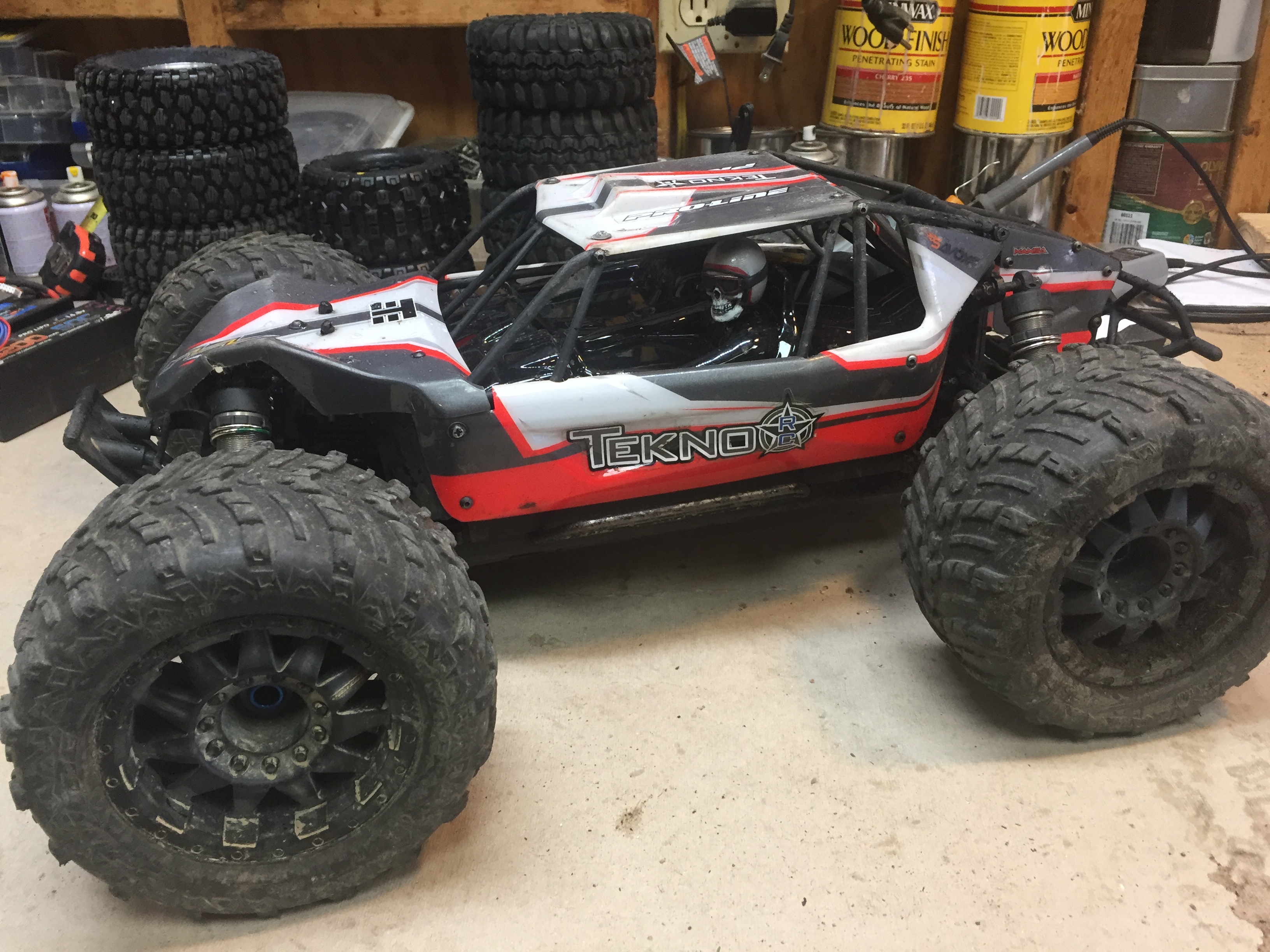

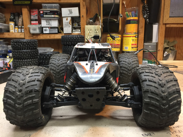

You can’t make the buggy into a MT410 without buying a ton of parts....but you can make it a very fun monster by taking a cheaper route. Get some team associated rc8t extended hexes, and some 3.8 Badlands, 2.8 mx38 Badlands or shockwave tires. You can have a versatile rc that can switch from a buggy to a monster just by swapping hubs and wheels in a matter of minutes.
Here’s my Tekno db410....which utilizes the same size chassis as the eb48...and I’m using a full eb48.4 driveline. Associated hexes let me run Shockwaves with full clearance.

Your truck looks awesome. I hope i'll do something similar with my arrma senton 6S
