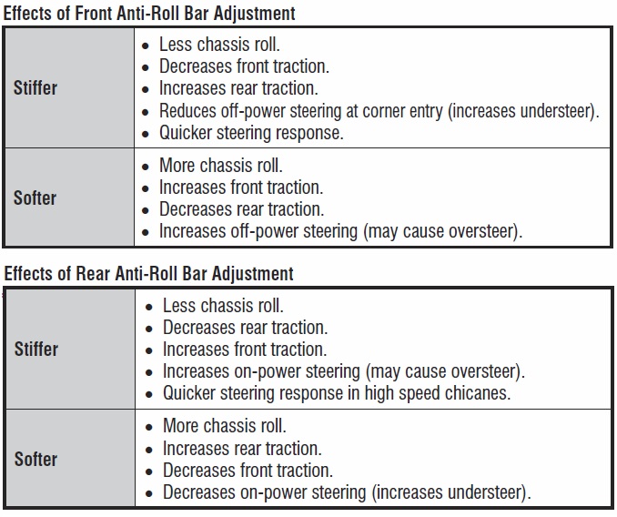

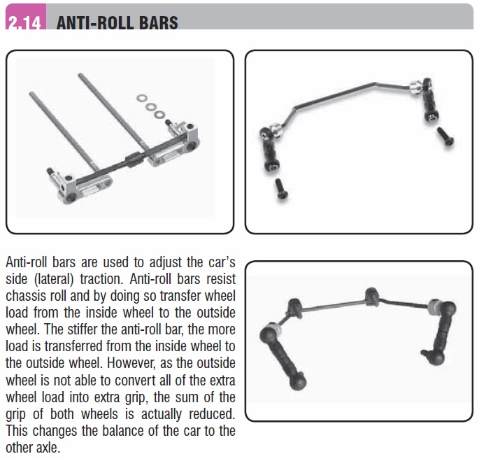

I have not raced DB but I would think you want some good articulation in the suspension for the rocky sections. Roll bars will limit the articulation for sure.
I just looked through the AE nomad DB8 manual and it does not use either front or rear sway bars. So maybe try without any or perhaps a very lite bar.
