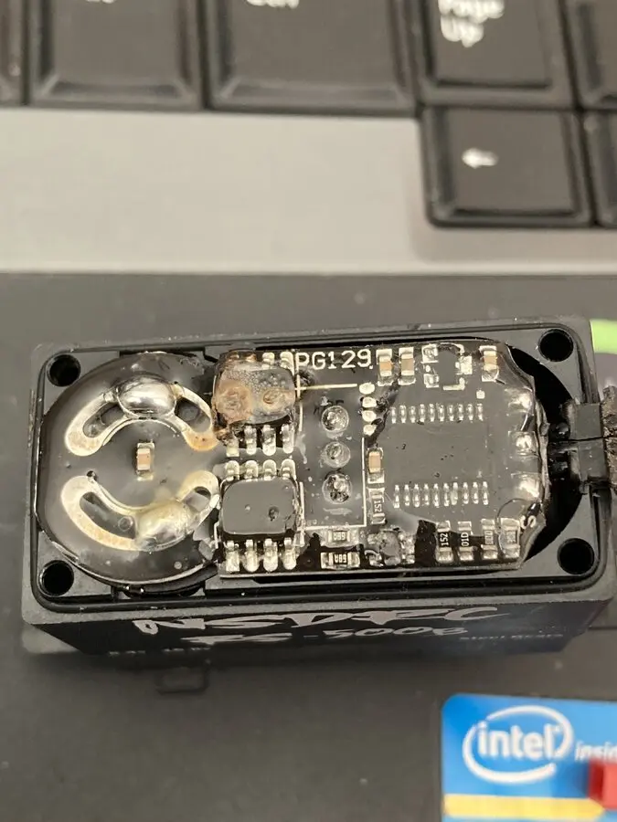

Servo went out while doing a warm up in the living room.

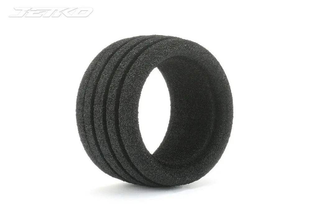

Then you have this Jetko brand which appears to be a knock off proline wheel?? I just wonder about the foam inserts with a brand like this, and the tread designs are a little different. On ebay there is a picture of the foam but no explanation if its a closed or open cell. Im not a foam insert expert so i couldnt tell you what it is. Im trying to insert the picture but its coming out like a mini thumbnail and just gets blurry if i try to enlarge it. I think they are also belted. It also seems like they come with all the removeable hex pieces.
About the same height as the proline stuff, significantly slimmer by several MM's, which i like.

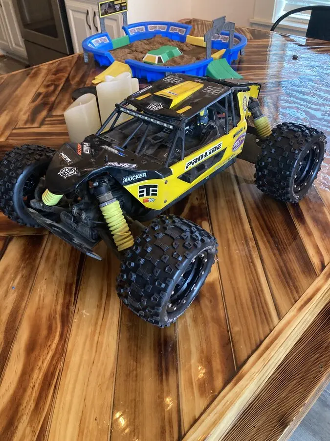

With the +4mm hex hubs tekno offers, these 1/2” offset 2.8” MT tires have zero clearance issues. I wasn’t sold on the 2.8 tires from the looks of pictures. But in real life, hell yes. The lugs are as big as the badlands 2.2” sct tires on the losi, they look real good. There’s actually one more lug along the sidewalls than what the badlands have.

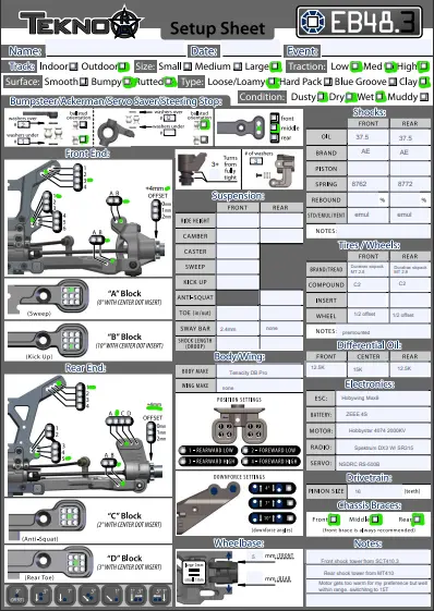

anyway i will have to play around with ride height and adjust the springs. Im still adjusting other things here and there but someday I'll post up a setup sheet.

I am having trouble posting up my set up sheet that is large enough to read, straight from the TEKNO site will not post, and its a PDF which shouldnt be an issue. I dont get the option to save as a jpg.

I’ve put on some pre-mount 2.8 OG badlands. The chassis slap has returned. They are slightly less diameter than the duratrax. I even belted them with some Kevlar braid.
