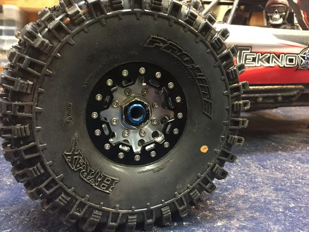

Yeah I like the looks. But the main thing I like is that they’re a true 17mm hex. I wasn’t too crazy about running big power on 12mm hexes.
They look great, will have to check how much to get them to UK

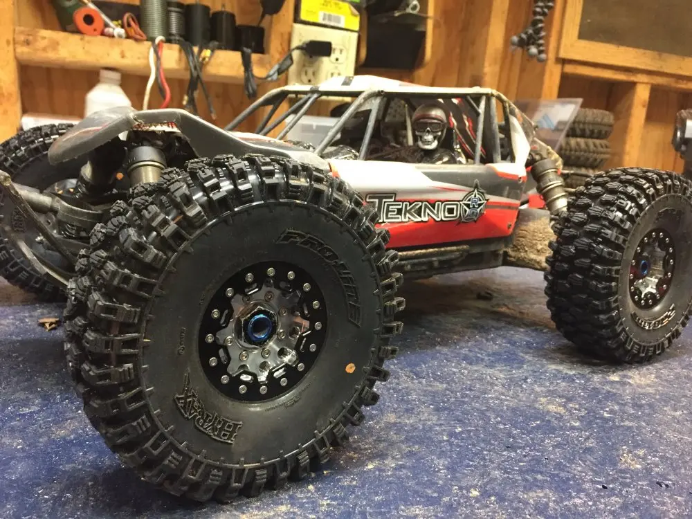

Man that wheel and tire combo just looks perfect. You're not helping my itch to build an DB48 at all. :D
Nice wheel and tire combo. Nice there is a dedicated 17mm wheel. What foams did you go with?
Nor me. I want to build one of these Front and Rear IFS buggies in the worst way.
They really don’t balloon too crazy. The run 4s with a 20t pinion. The tires themselves balloon some, but I have closed cell foams in them. These foams won’t expand with the tires like normal stock foams....so it decreases the overall ballooning.

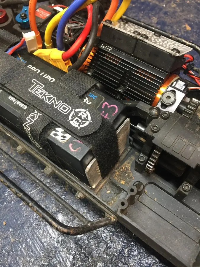

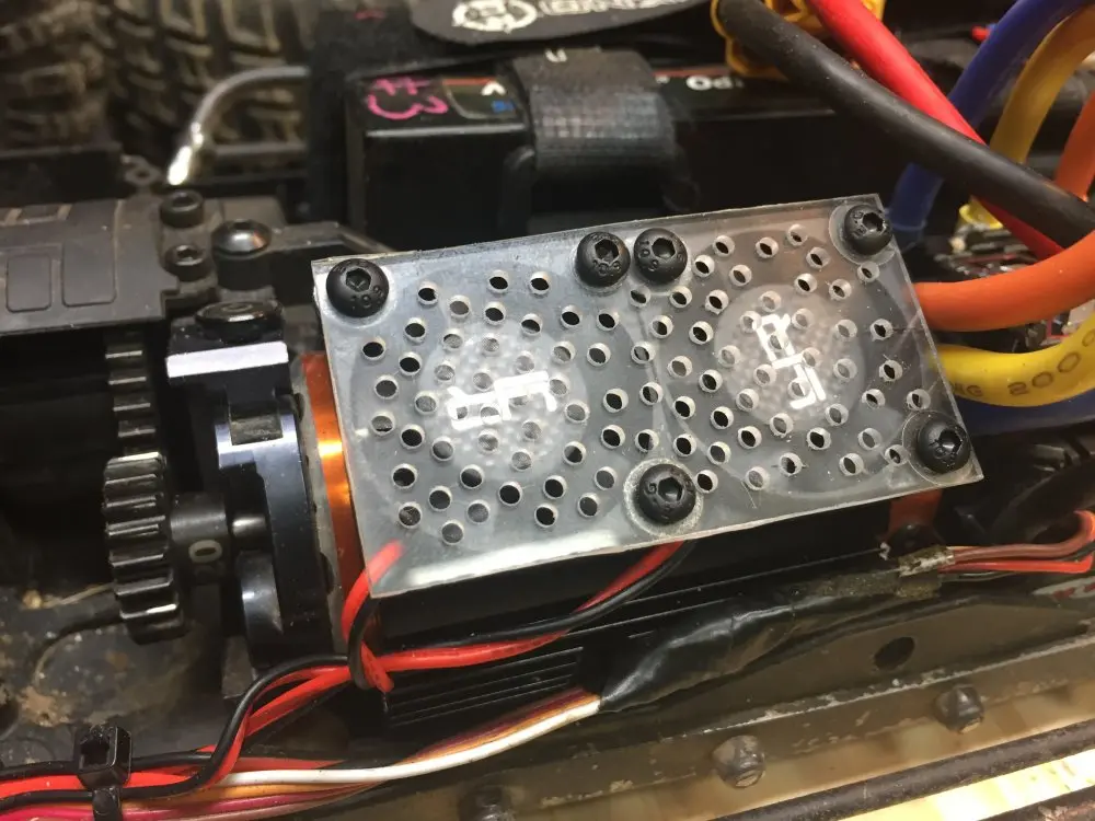

Well I got my Gool motor well over 200 degrees yesterday. It was very hot and humid ....and I ran it very hard for a full pack. I’m going to remove the drivers assembly for the summer, it really restricts airflow. Also I installed a Yeah Racing heatsink with double fan. I made a lexan screen to keep out the debris.

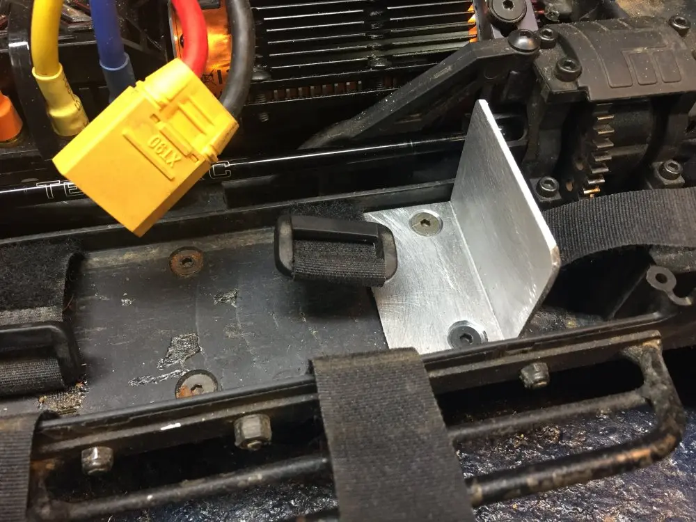

I destroyed an almost brand new Turnigy Graphene 5s lipo about a month ago. Because the outdrive chewed it up. That ain’t gonna happen again.

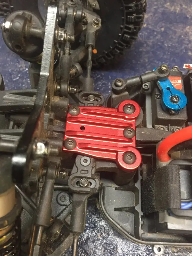

I read somewhere (I have read a lot of your posts) that you upgraded the diffs on your sct to 8th scale. Did you have to upgrade the housings as well? Any details would be appreciated. Thank you.
