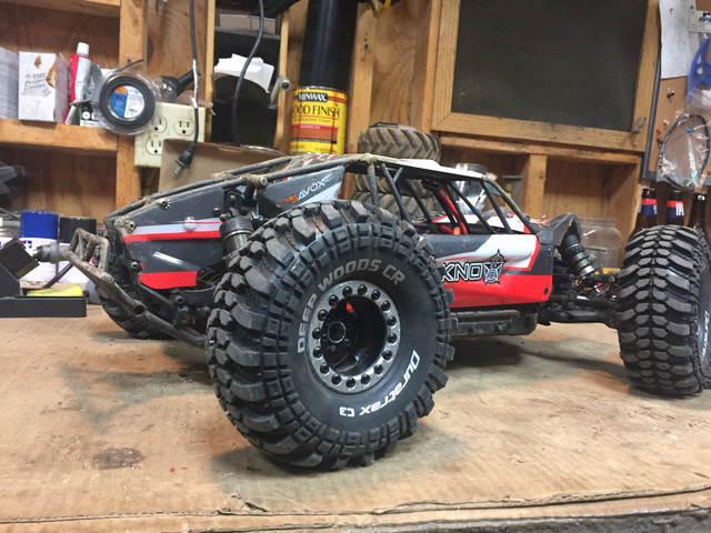

I originally bought a SCT410.3 to try my hand at racing at a local indoor track. As soon as I got it set up the track closed. So I started tinkering ...
The cage body is a Losi scbe. It’s a perfect length for the Short course or Tekno 1/8 buggy.

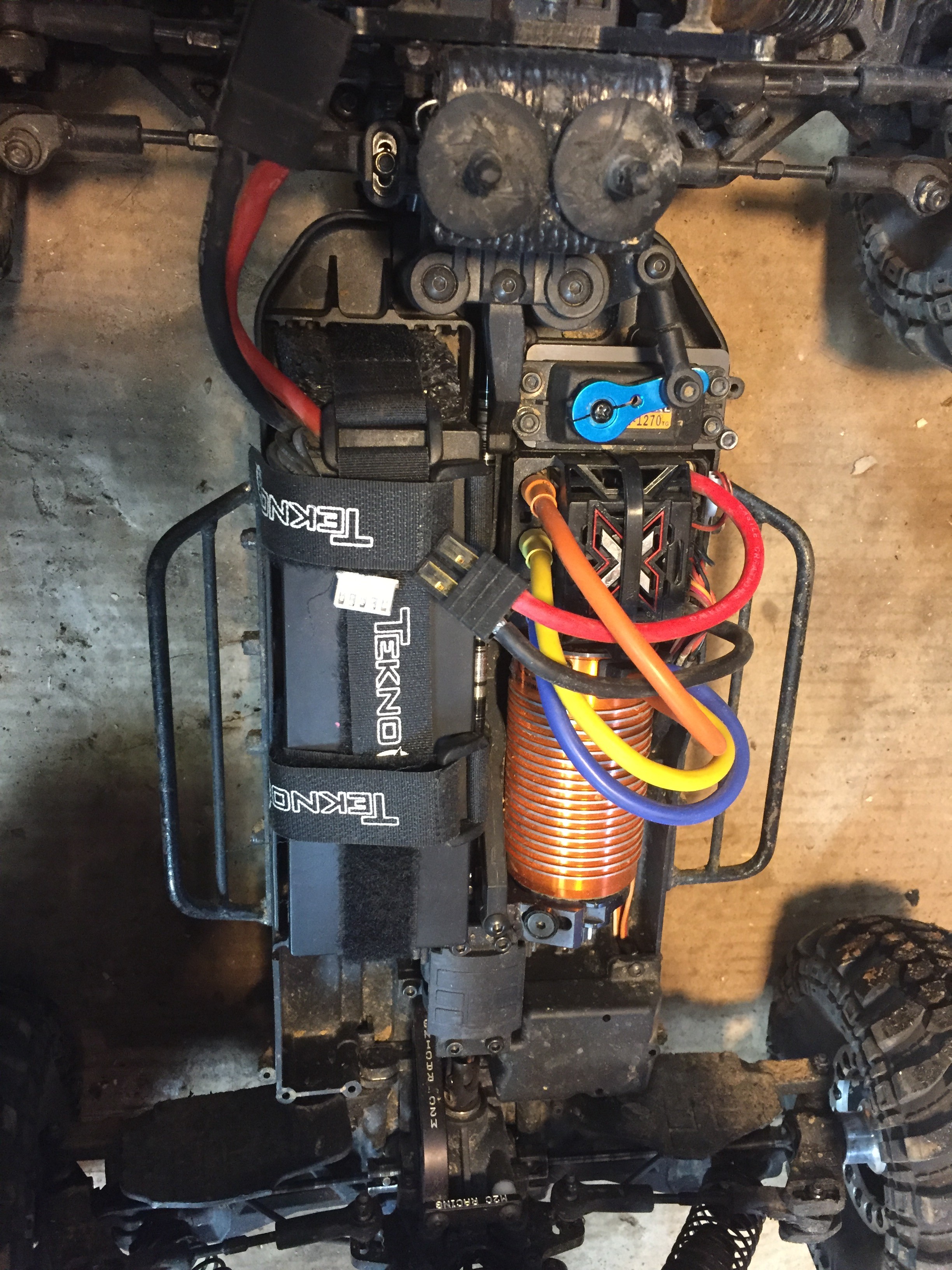

Currently running with Mamba Monster X, a 2000kv Gool motor, and Savox 1270 Servo

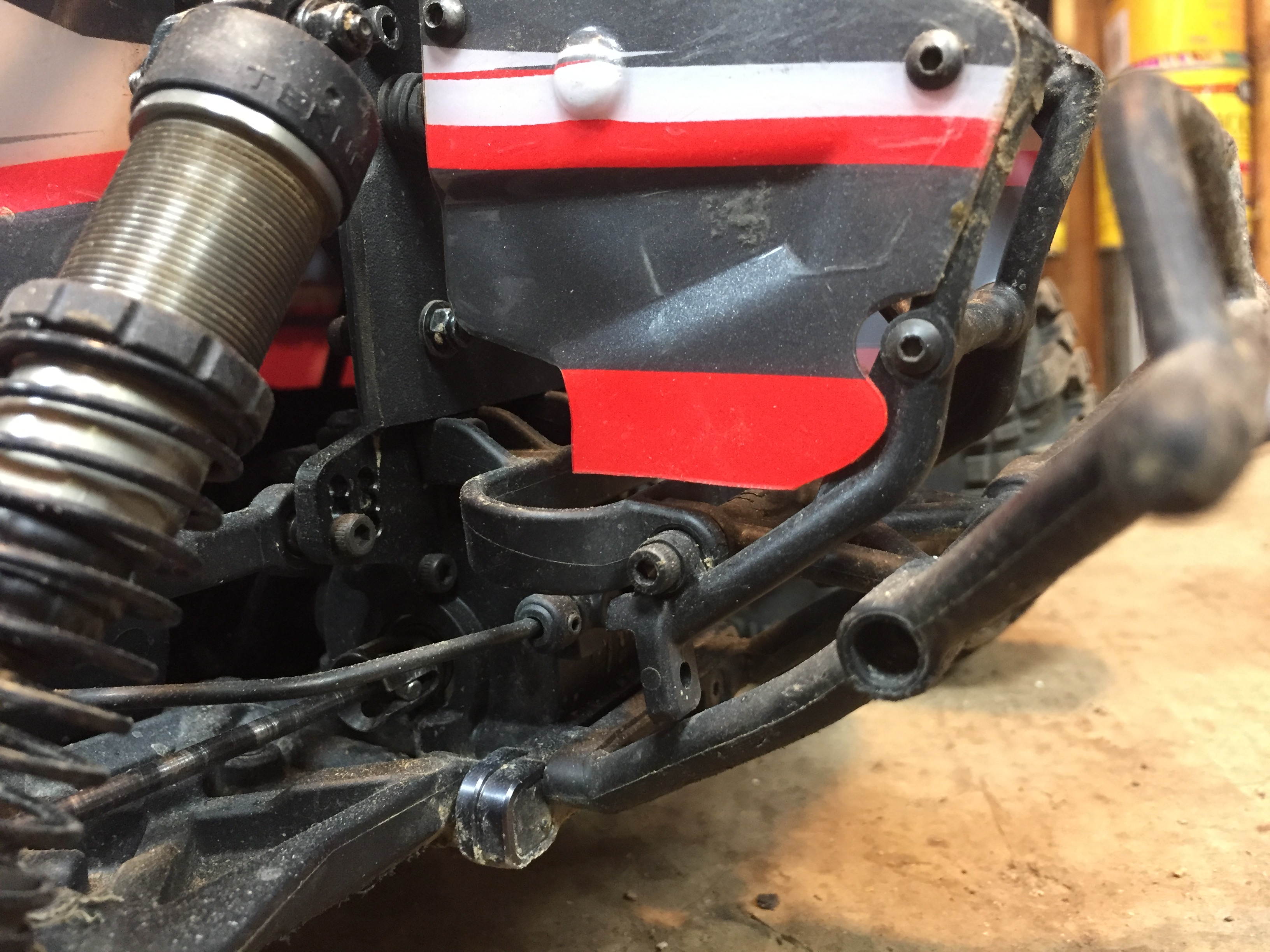

How does the body mount?

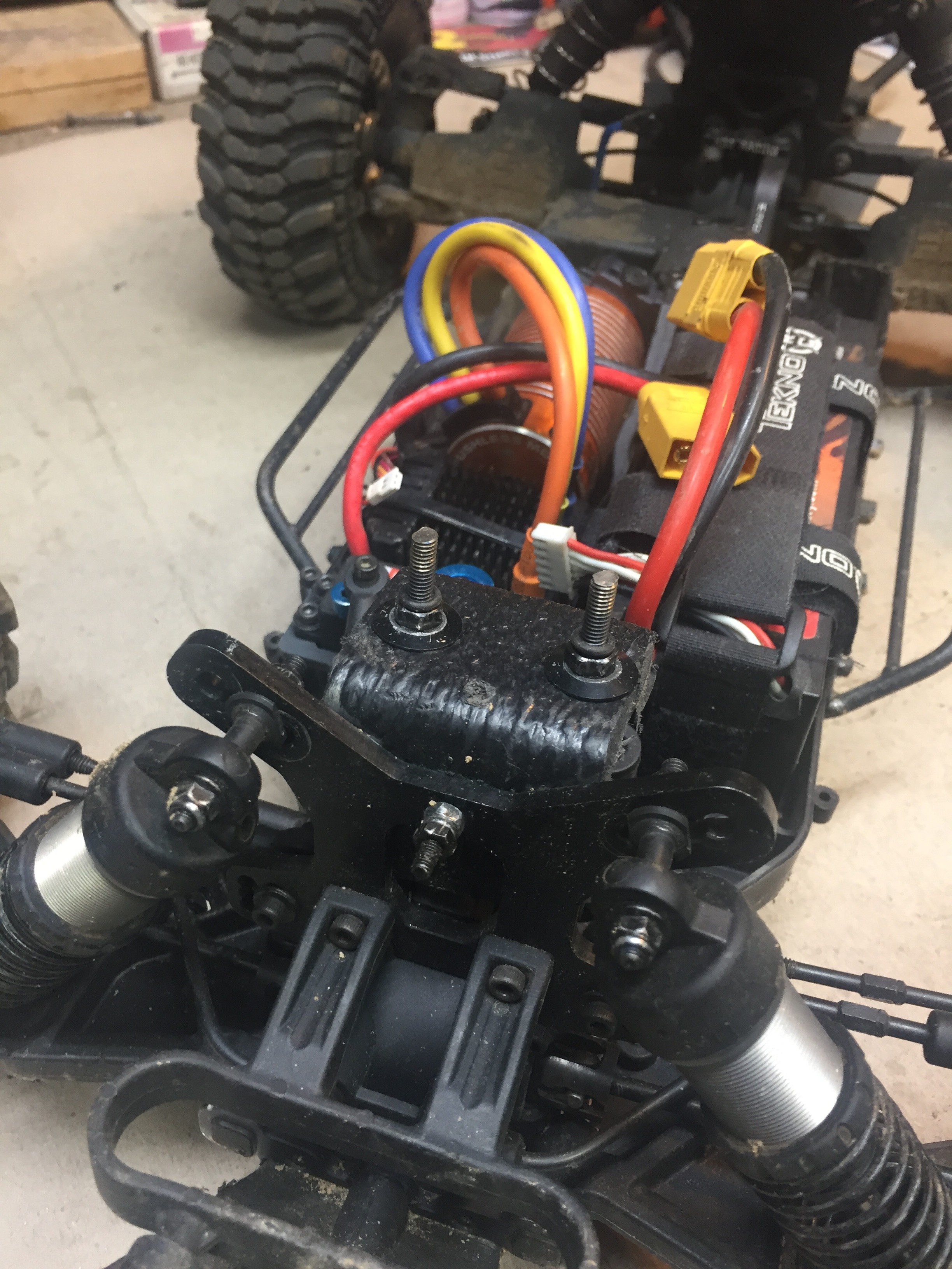

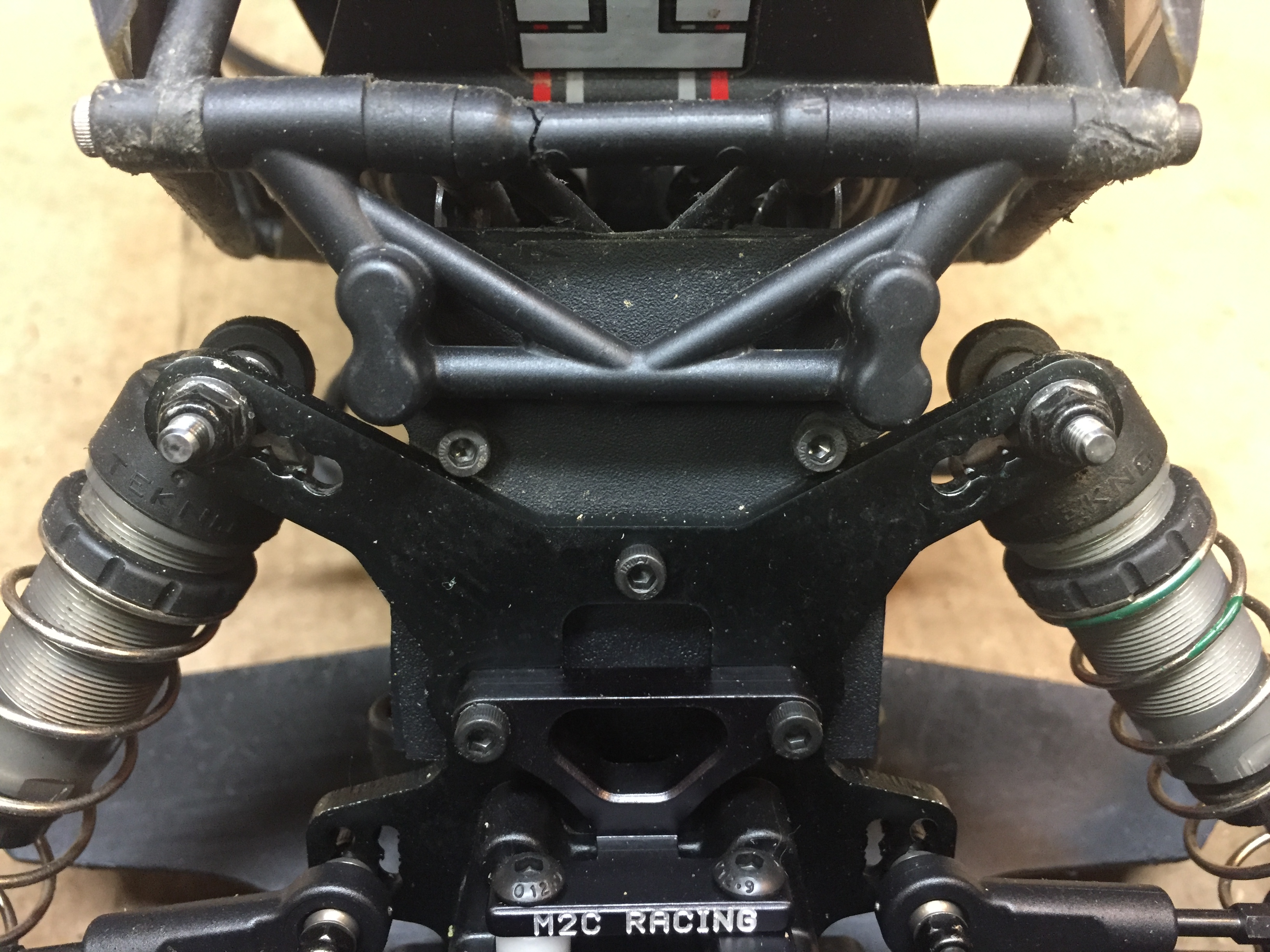

It’s got a hinge at the rear and has to be mounted to the rear shock tower. But it can’t bolt directly to the tower because it has to set a little bit higher to fit properly. . You need to attach kydex, aluminum or something similar to the tower then bolt the cage on just a bit above the tower. Let me know if you want more pics, I’ll get some up tomorrow. It definitely took a little work to get it all to set right.

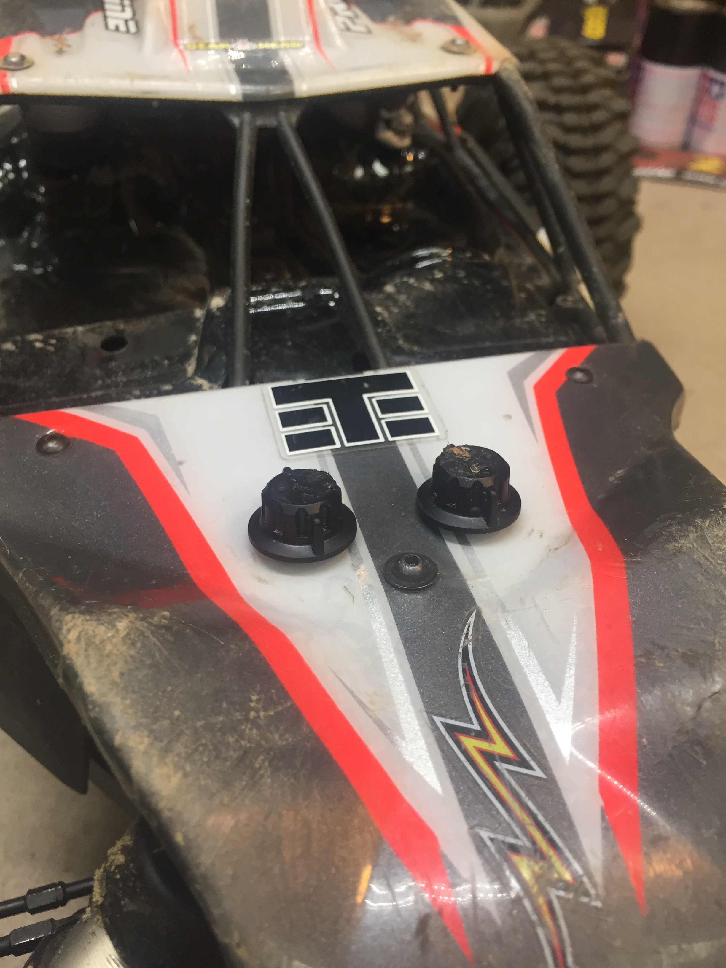

Here’s the front. I used an angle piece I chopped off of an old pickup truck bed liner. Ran two bolts from underneath....and I am using the Proline cap screw body clip thingies to hold the front in place

. Just to be clear my build
Is quite different. I did not use the truggy chassis. I’m still using the short course chassis. Most guys are using the Nomad DB8 cage, and I’m using a Losi scbe cage.
Also I converted my entire driveline over to eb48.4 parts(driveshafts, universals, arms, spindles, hubs, outdrives, diff pins, rear c and d blocks)....I’m after heavy duty durability. I tend to abuse my trucks a bit:)
I don’t race. It would’ve been cheaper and easier if I started with a eb48.4 but I’m working with what I had. ...and I enjoy tinkering.
The rear piece is bolted to both the kydex sheet and tower, then bolted also to the stock sct bumper(adding a lot of strength)
Close up
