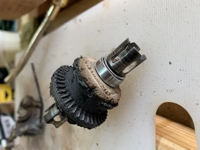

I'm rebuilding a used EB48.4 that I bought some time ago and had noticed it had a really bad turning radius. It just would not pivot properly.
After checking everything (including replacing the servo) I came to the conclusion that it was the center diff that was likely faulty. I removed it and noticed it is binding. Did a quick rebuild and is still binding... Anyone has an idea of what could make it bind and how to fix this?

Just a guess, but as filthy as the diff looks, I would rebuild it again, but make sure there are no metal shavings/grime that are lodged in the teeth inside. Perhaps flushing it with brake cleaner (after removing the rubber seals), soak the gears and let every dry completely before re-assembly. Verify the shims are not missing too!
It's possible that the diff case may have been "cooked" and the plastic melted due to any empty diff that wasn't properly maintained. If so, then replace the diff case and be sure to never let the diff run dry and do rebuilds every 20-25 battery packs ;)

hi Bill,
i did a quick check, it was not empty but the fluid in there was dark like I have never seen. Checked all teeth, rubber seals, shims and nothing was missing or compromised.
i believe it is a good idea to get a new case before throwing all fresh seals in there.

If you have not completely flushed the fluid/grime out of the diff, then I would be willing to bet you have a chunk of something causing the binding :(

full cleaning on the way.
here is another of the diffs for your pleasure 😂
Oh boy... that’s no shelf queen for sure...

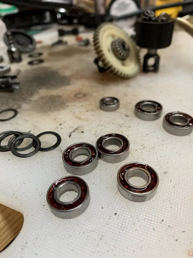

Following the diff horror story mentioned above, I thought you guys deserved some diff and bearings love. :)
Clean bearings with fresh high end aviation grease:
The grease I use is Mobil 28 aviation grease with following specs:
