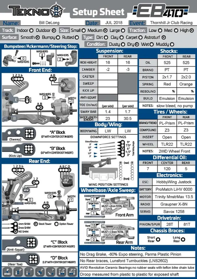

I struggled to get my EB410 to perform well at the local turf track in my area. Many custom parts were once available from VRP to get the geometry a little better and yes I ran 120K in the center for this track condition, but I would ultimately learn that the EB410 was not a solid performer for carpet/turf:
