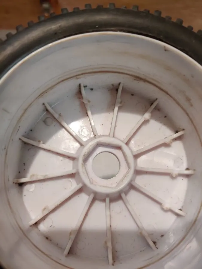

I think I may have found it. Was cleaning and removed one of the rear wheels. There was a small stick stuck inside wearing onto the rim. Which would explain the sound lessening as I continued to drive. I'll verify later when undoubtedly one of my sons wants to use the rc cars lol
