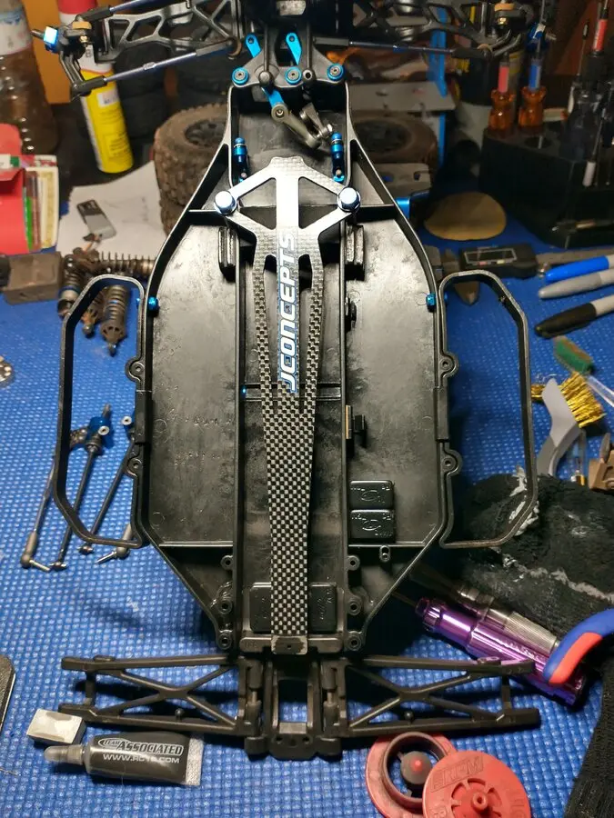

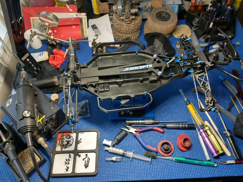

If it's just dirt/dust, and loose debris after a run, then I just use compressed air.
If doing a complete end of season tear down/rebuild (like shown below), or prepping to sell, then it's normal Simple Green (50/50 water dilution mix)/toothbrush for scrubbing. Naphtha for doing diff fluid overhauls, and bearing cleaning. CRC QD Electronics Cleaner for degreasing, motor cleaning, shock cleaning, and sometimes bearing blasting. Pledge, or favorite silicone spray, misting on the plastics afterwards.
People that go to extremes using a shower, power washer, sink, dishwasher :oops:🤣 etc., etc., this involves water and a person needs to have an anti-rust program/regimen to go with it. Lots of ways to go about cleaning, and there are lots of formulas/products that people choose to use that make cleaning easier. It all depends on how far you want to take it. Bottom line is, "elbow grease" is going to be evolved.

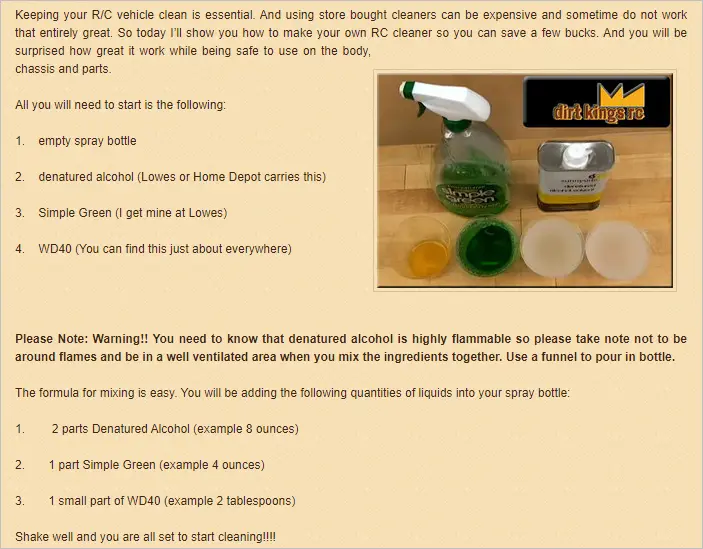

Radio Control Car Action had a cleaning mixture "back in the day" that was super popular.... I think this is it:
