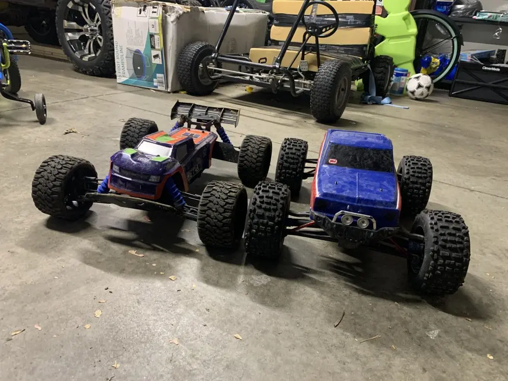

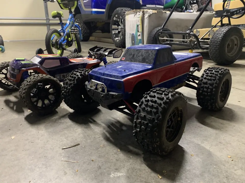

I know you already ordered but I got some pics
The backflips are mounted on my e-revo and the ET has sweeps
Both rigs are the same size just to give you an idea of size

I think they are the perfect size light and lots of traction for the price I wouldn’t run anything else.
