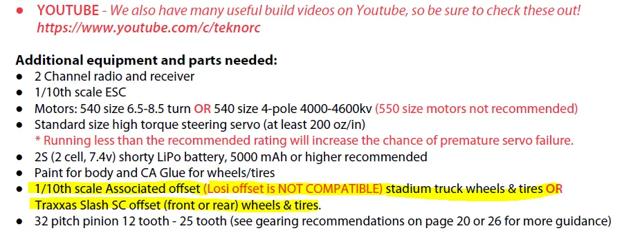

From the manual...
2.2" stadium truck tires, or, if using SC wheels, you'll want 2.2/3.0" SC tires.
To add on this, I would stay with ST wheels/tires only, I have experimented with SCT wheels and they would prove to be a disadvantage in all terrains from carpet/turf/dirt/low/med/high grip
The ONLY advantage SCT wheels offered where ability to self marshal but at the expense of a significantly slower truck, if you want to be competitive then stick with ST wheels.
