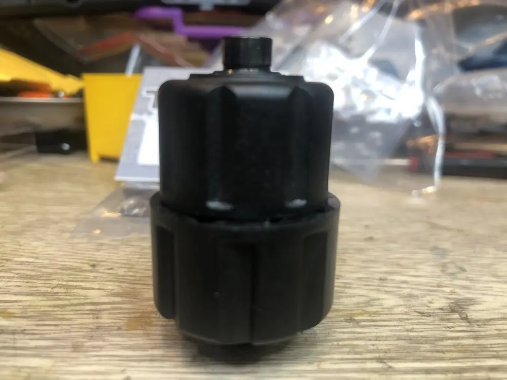

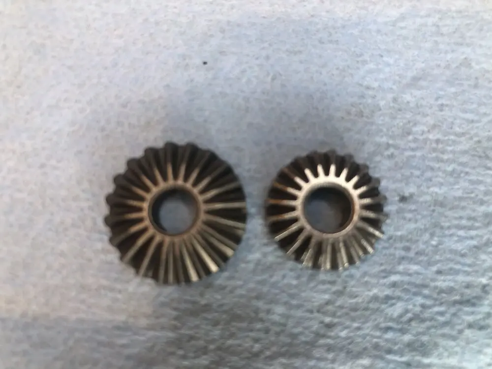

Matt, wish you had spoken up earlier. Ordered out some of the new parts, guess I have a start on a 2.0 build. See pictures for difference. Looks like new bigger, tougher diff on the way. They do not seem to be a retro upgrade, not sure of that. What is Tekno's return policy. grin.
The parts descriptions say that they can be used on all 2.x models, meaning any 2.0 model or future 2.1, 2.2, etc. models.
You could however use a complete 2.0 center differential in the MT410 as the bearing spacing is the same, and the electric 2.0 vehicles use the same tooth count for their spur gears as the previous generation of electric vehicles.
Sounds very interesting. Where does one find the manual for the 2.0 that list the new parts? What I find on line does not show the new parts. Seems one will have to find the part # for the new gear to fit the new bigger case. Have it all but the gear I think. What will be effect be with the new style diff on car preformace?
Maybe figuring it out. Looking at my manual for ET 48.3, it uses the same case as in the MT410. Now Tekno has not one diff case but two. The new and larger style is in the 2 vehicles. With the new TKR9115B the latest design. So one can order gear and gasket from the 2 manual to make a new larger center diff that will fit all older MT410, ET48.3 etc. Think the new design will act very much like a positrac diff with equal power distribution which is very interesting. With 2 MT 410 and a third on the way plus two ET48.3 think it is time to experiment.
