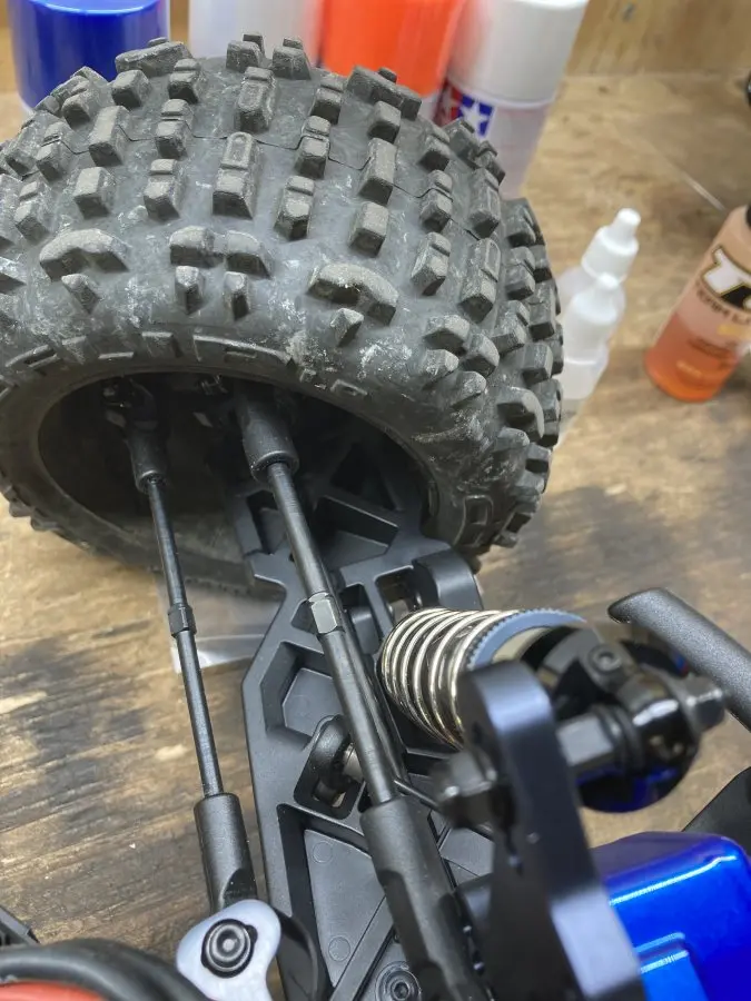

What offset are the wheel hubs? I plan on running +2mm for bashing.
Plus 4mm on the front and plus 2mm on the rear with the front plus 4 backflip lps just clear the arms

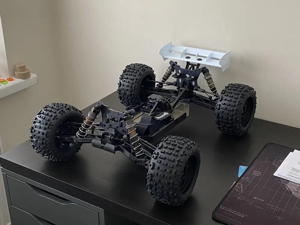

Basher build coming along slowly but surely!!
Added:
- Metal Spur Gear 44T
- Diff fluid 60/200/20
- Orange springs front and rear
- Tekno servo horn
- Backflip LP 4s
Now waiting on all my electronics to arrive, namely ESC and servo!

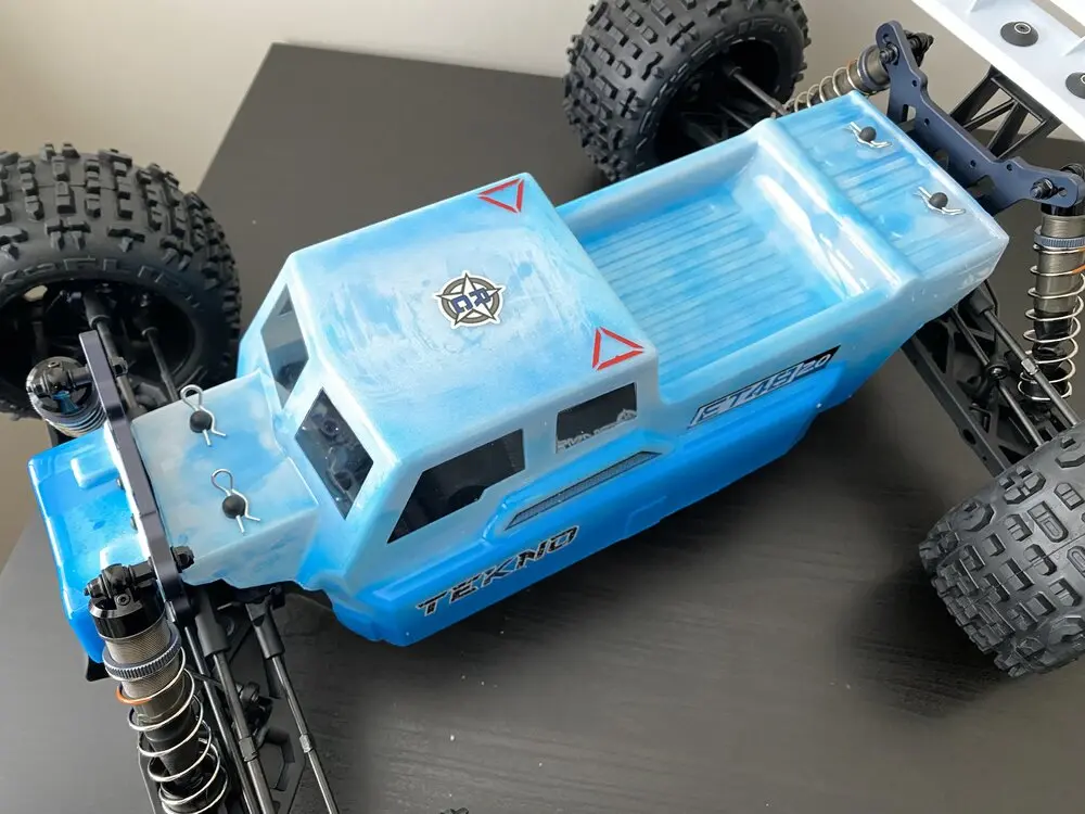

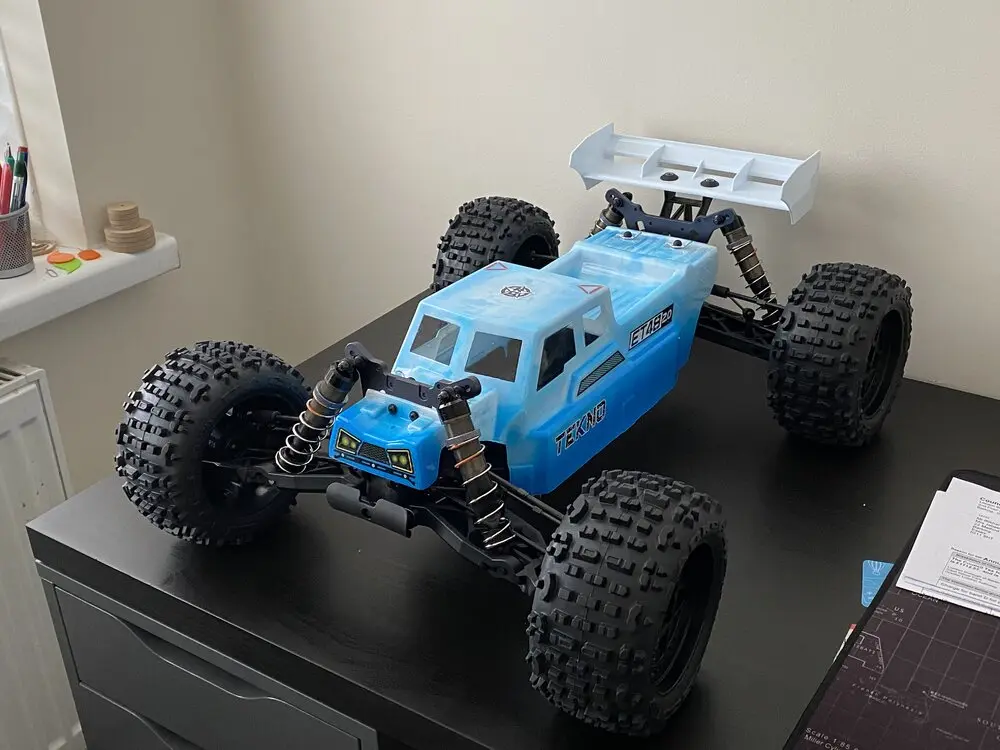

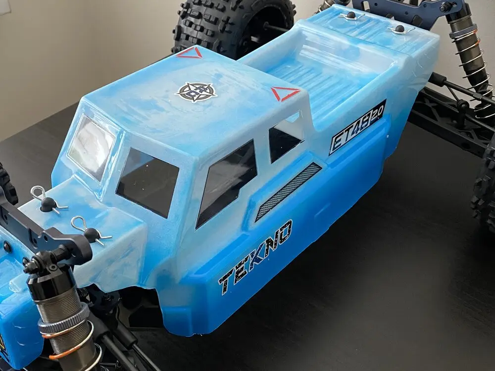

So while I wait on electronics I decided to [try] and paint the body.
This is my first ever paint job - usually pay to get a body painted - but I just wanted a plain style this time round so thought I'd give it a shot!!
Honestly, I just wanted mostly white all over with a little blue around the bottom edges - kinda overdone it with a blue a bit, but the end result is still pretty decent [for me at least]! lol

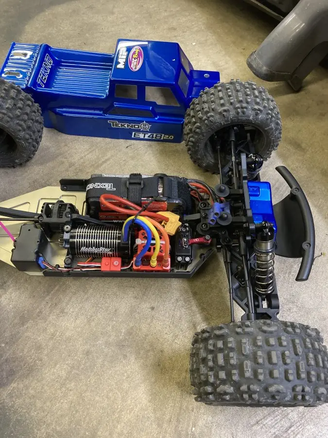

I ran my ET48 2.0 on the track yesterday and I'm looking to install the XR8 plus combo with the 4274 motor, just had it in my mind that this is what you had ordered?
My Castle set-up is nice, but it is a bit of over kill, I got it as I wanted to make this car a basher, but after racing it I want to get another kit to make my basher.

I have everything else set and ready to install - HW XR8 Plus with HW 4274 G3 2260kv motor.
Will go with a 16t pinion for now and see how things go.

Nice. Hey Tekno, some window masks would be good..
Mine had window masks. Took me a bit to figure out that what looked like a random off-white sheet of paper was really window masks.
Window masks are inside the box!!!
Totally missed it. Thanks
