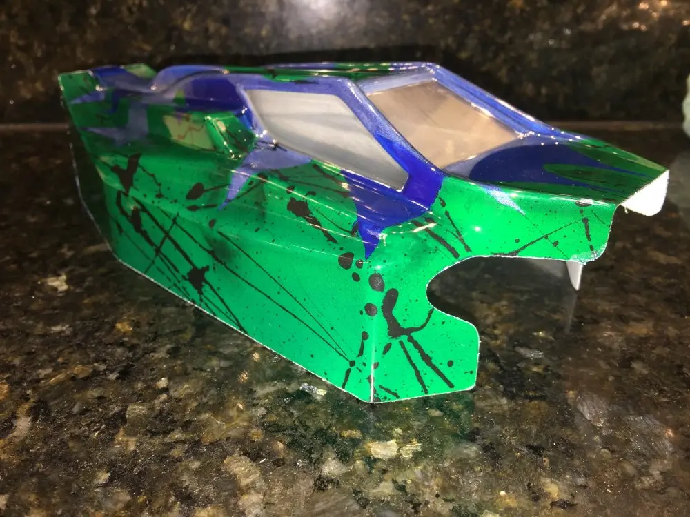

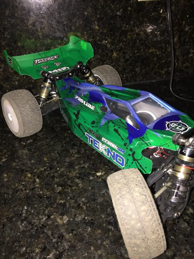

Just painted up a new body for one my EB410s, the Proline Elite. Really wasn't my first choice of body body but I got it for $24 with shipping w/ the two wings so I thought it was a good deal. Turned out all right...for some rattle cans and masking tape.

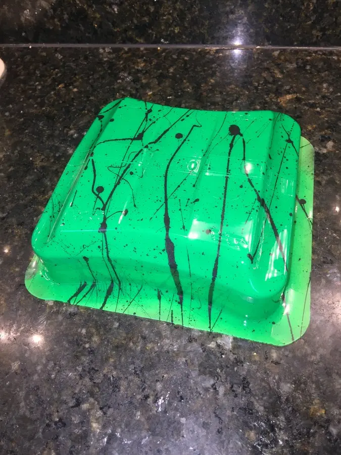

The wings...I don't usually paint the wings but this time I said why not?!

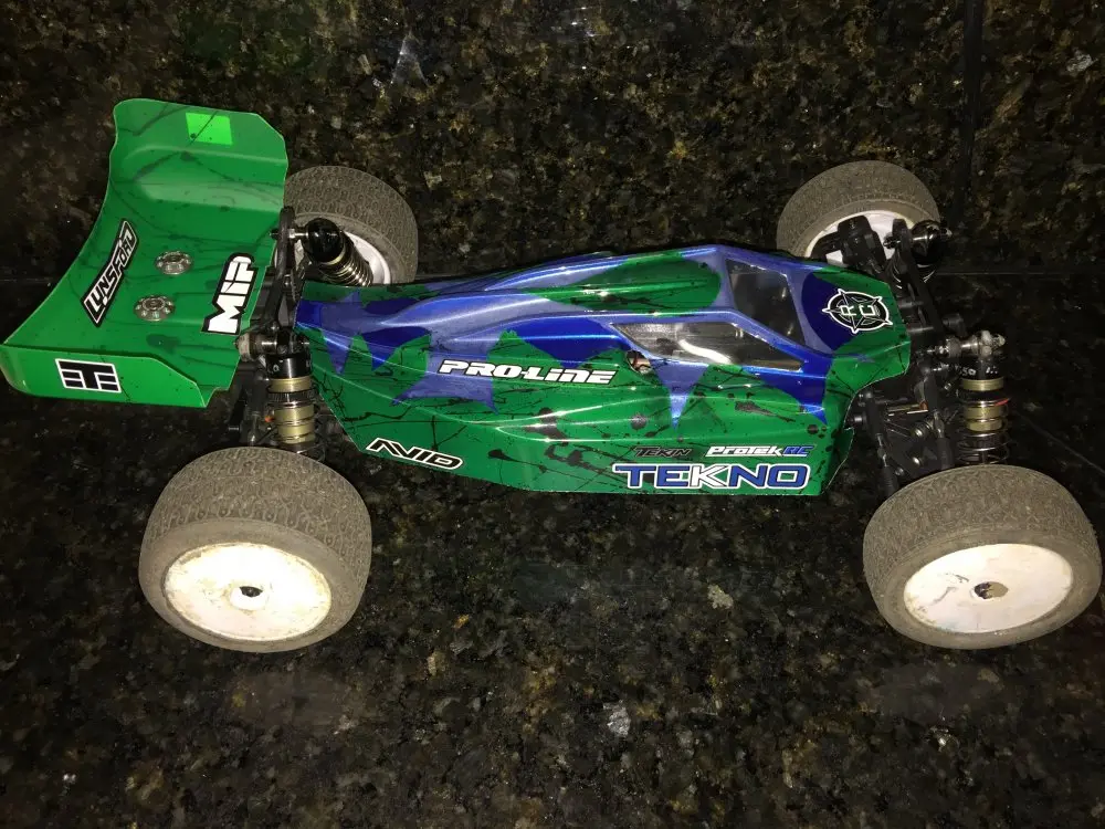

Topless shot.

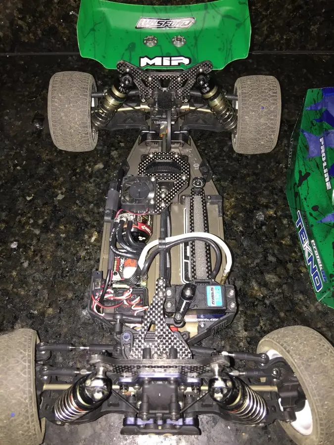

The things that make this thing TBuggy's:
Electronics;
Running Tekin Spec R 13.5/RS pro BE
Protek 130t servo
Powered by Team Orion 3800mah shorties (when I want it really lite)
Wheels;
JC w/ Dirt Webs (soft)
Hardware Upgrades;
Protek Titanium screws through out (except the lower chassis screws in rear...I wanted the weight down low back there)
Protek aluminum servo horn (lighter than tekno)
Protek aluminum spacers
T-works Titanium ball studs
Lunsford Titanium shock stand offs
Lunsford Titanium turnbuckles
Exotek titanium wing buttons
Exotek rear hubs
Exotek rear steel "D" block (13g)
Exotek chassis weight (using 40g)
Tekno cabon fiber top plates; center and front
Tekno carbon fiber shock towers
Tekno composite gears
Tekno +1mm hexes
Tekno lite weight body or Pro-line Elite body
Tekno Delrin pistons (front 1.7mm and back 2.0mm)
Tekno Aluminum shock caps
TLR shock limiters (using small spacers to accomplish the same thing MIP shock cartridge set does)
Avid carbon fiber battery strap and aluminum thumb screw
Avid bearings
MIP puck system
Mattox designs indoor chassis protector
PT diff and shock oils
Also running the rear shocks forward currently.
