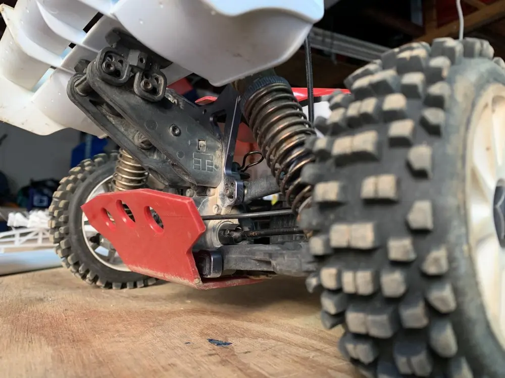

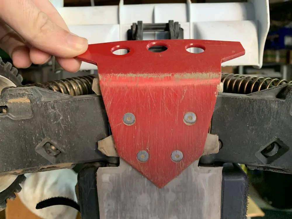

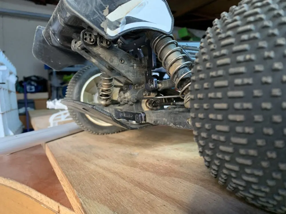

is the D block protected on the MT410? I added a rear bumper on both EB and ET for that precise reason and because they act as a rear skid plate.
went with T-bone, they have lifetime warranty from what I understand.

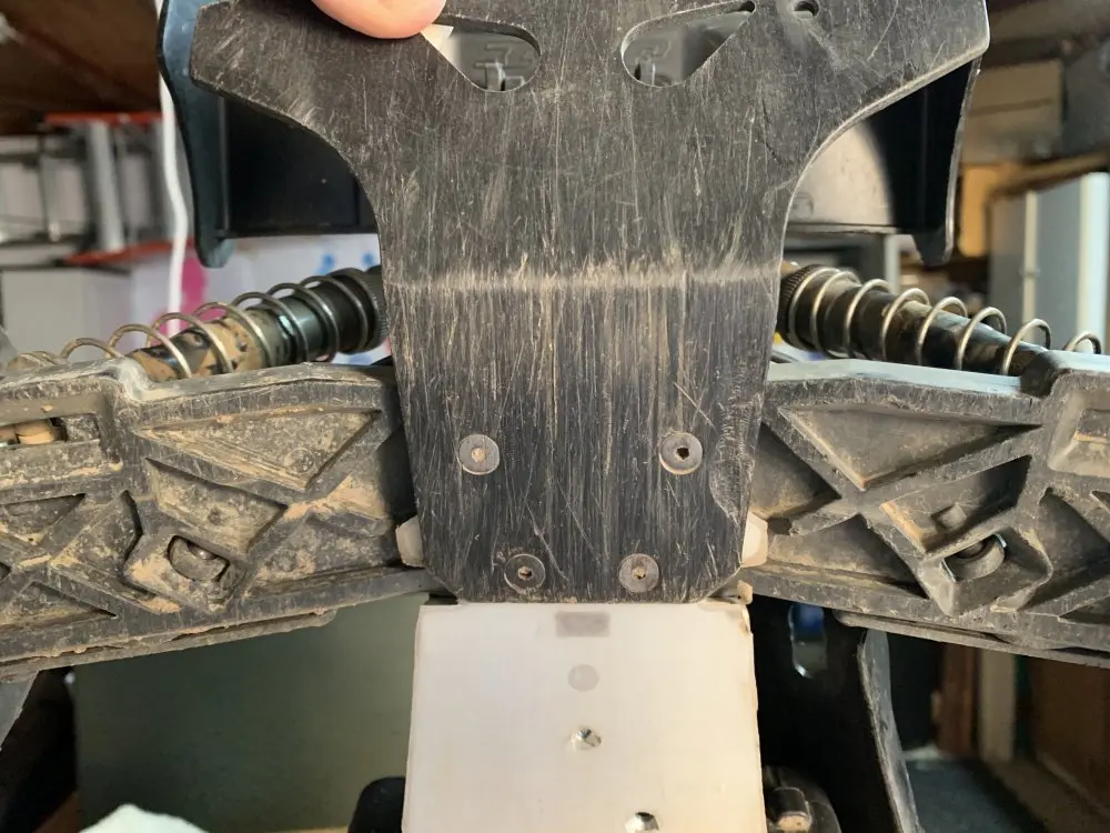

EDIT: added pictures, black is ET48.3, red is EB48.4

I put the front t-bone bumper on my EB and shortly after broke a bulkhead. Not 100% sure it was due to the bumper but I suspect it was since the force of the impact transfers to the bumper screws. Took it off as I’d rather break an arm or turnbuckle being they are easier to replace.
