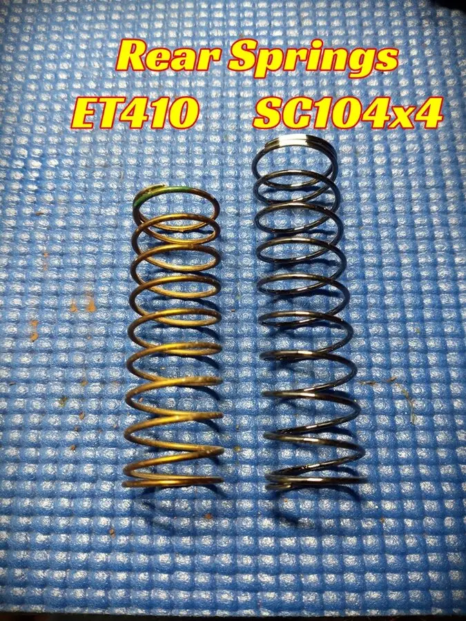

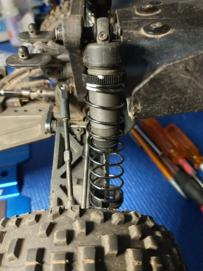

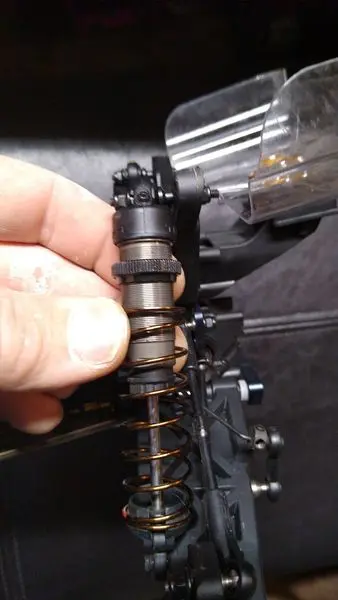

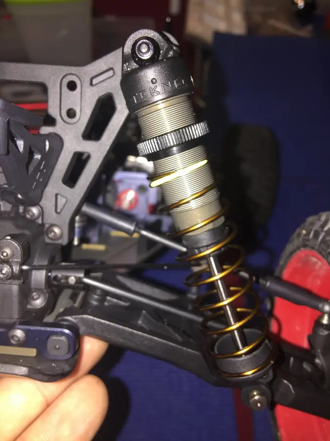

Has anyone tried different spring manufacturers with success on the ET410 shocks? Tekno springs seems larger than AE/TLR/Etc and wanted some ideas.
Yeah, just wanted to tune shocks using AE springs because I have a good selection.Not sure who started it, but Tekno's 1/10 scale shocks are 13mm diameter "big bores". (SCT410.3 uses 16mm shocks). One can only assume that Team Associated will hop onboard the 13mm big bore shock band wagon with their future SC/ST platforms as they have begun to move that direction on their buggies.
Let me guess, you are worried about the gap between springs and collars?

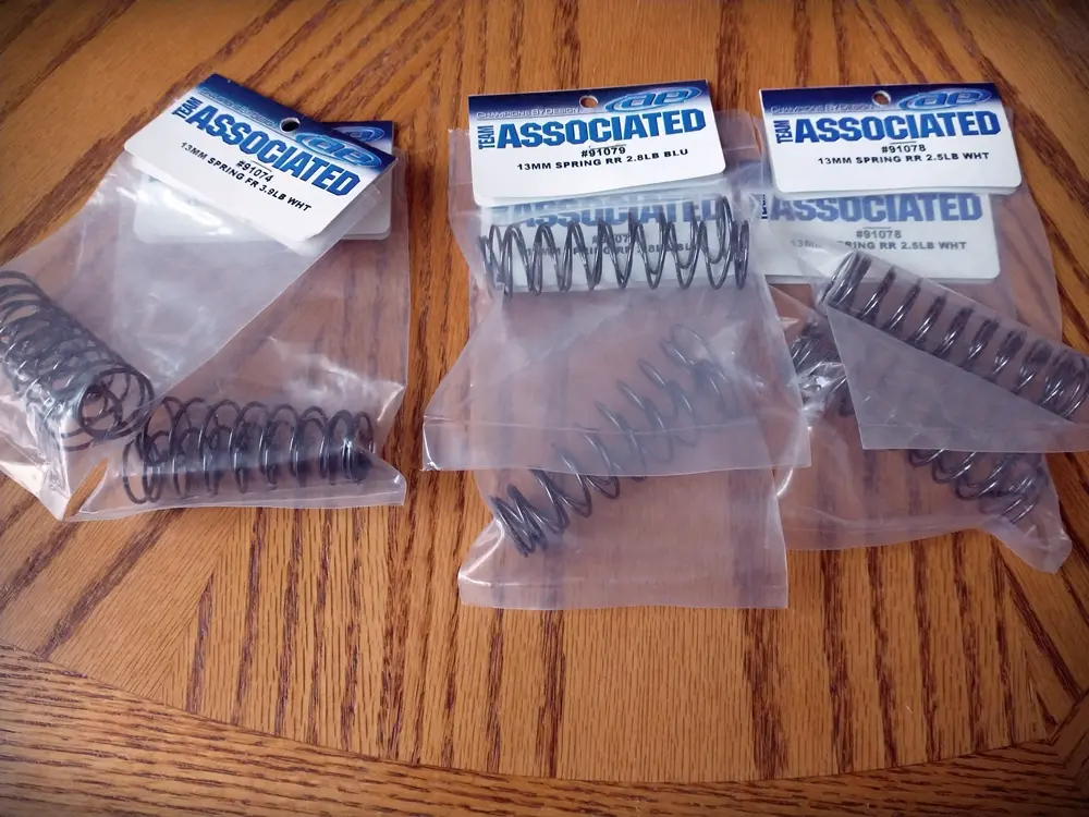

I heard associated 14mm springs wont fit?Am I right?I stand corrected... Team Associated does now offer 13mm shock bodies/springs for their trucks. Man, a person takes a couple months off, and they miss out on a lot of happenings going on.
HB are making 1/10 truck springs?After switching over to HB I can confirm they are interchangeable with TEKNO.
