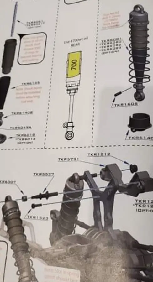

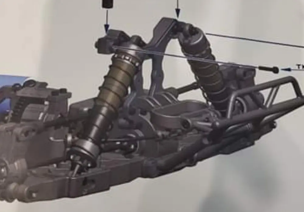

Can someone please post pics or let me know where the spring collar placement should be? The manual indicates as follows and when I set the collar all the way to top, the rear droops down. What should I be looking for when I set the
spring collar?

Pushing the collars down will only change your ride hight. Not the suspension stiffness. I know it is counter intuitive, I struggle to understand the mechanics of it myself.
Your ride hight will be at its best when the arms more or less sit horizontal.
The collars were meant for that setup and never stay up on the shocks. To make the suspension feel stiffer, you can change the attach points of the shocks on the arms and towers. Further “out” / closer to tires = stiffer. Further “in” / close to chassis = softer.
Thank you Nicochau, the attach points are left stock as per the manual. Do you have suggestions in terms of where the front and rear shock collars should be for big air jumps?
