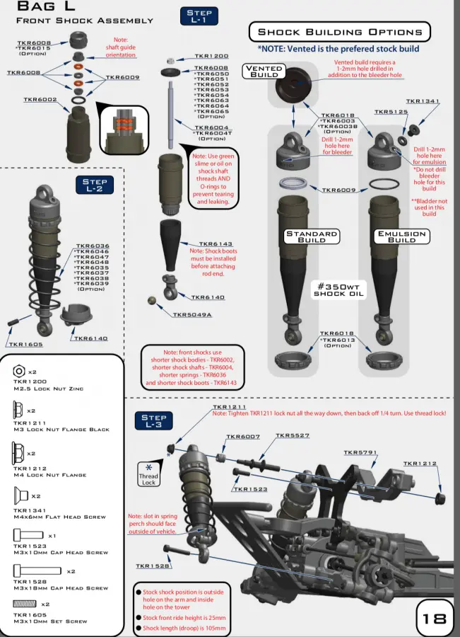

This is from the SCT 410.3 instructions manual, the plastic shock caps are the same for the SCT and MT but they do not give you the bleeder screw TKR1341 or the o-ring TKR5125 in the MT kit so you would need them to make the stock plastic MT caps emulsion setup. The metal shock caps are much better for the MT given the added abuse of bashing, the plastic ones did not last long for me.
Emulsion shocks require the hole on top and at the angle shown in the pic above. After you bleed the air from the shocks you install a screw and o-ring to seal everything up.

Ahh, got it thanks guys! I have drilled a 2mm hole and built the bladder shocks for now. I will get the aluminum caps once these break (eventually).
