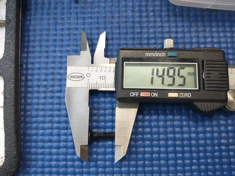

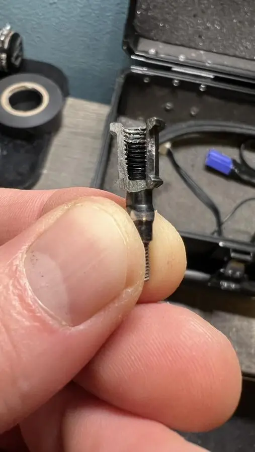

I used longer screws after noticing a lot of chatter about the new standoffs not being as durable as the older style shock standoffs. You can kind of see below (looking at the dried threadlocker) how far a stock M4x10mm BH screw goes into a standoff...

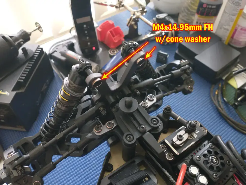

A person could use a M4x13mm BH screw to secure/fill the cavity of the new +2mm standoffs. For the front TKR8777B +2mm standoffs, I went with M4x15mm Flat Head screws and cone washers.

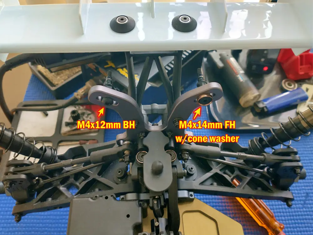

For the rear TKR8777 +0mm standoffs I used M4x14mm FH screws and cone washers. If you don't have cone washers, M4x12mm button head screws will do.
