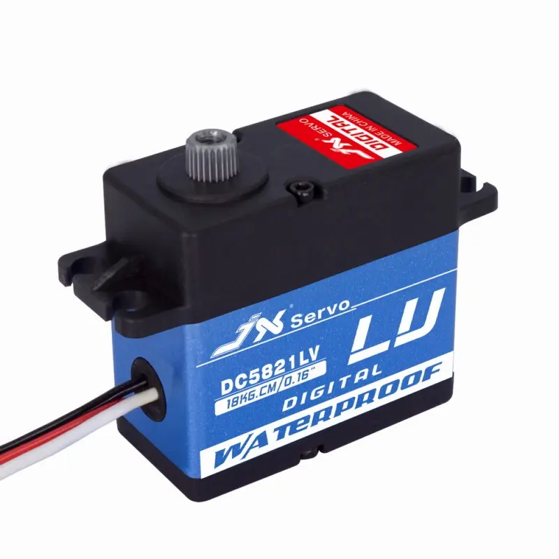

As far as low budget servos go, I would consider JX, and no matter what you get I would only recommend a solid aluminum case servo as a bare minimum, more info here:
https://www.rctalk.com/forum/threads/servo-rating-info.138498/#post-1382954

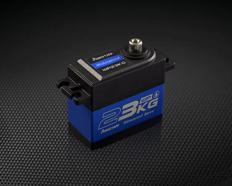

The "right" servo includes a choice of many. Even though the "SL" is what is known and designed as a lightweight SCT, it's still a heavier RC running with no servo saver... you want a strong servo to handle things. This day in age, over the top specs are everywhere.
I definitely would go with Tekno's recommended starting point (240 oz/in) for torque. When I go shopping for a servo that doesn't come with a lifetime warranty (and price tag to go with it), I make sure I can find replacement gear sets for if/when the time comes.
If I only got/want to spend $35~$40 for a servo...

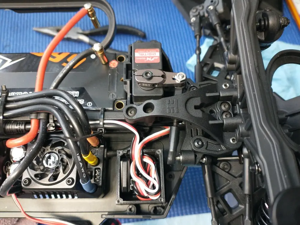

A lower priced servo horn that I found (keep on hand) and use on EB48, ET410, SCT410.3, and SCT410SL...
1698402696358-jpeg.9924
