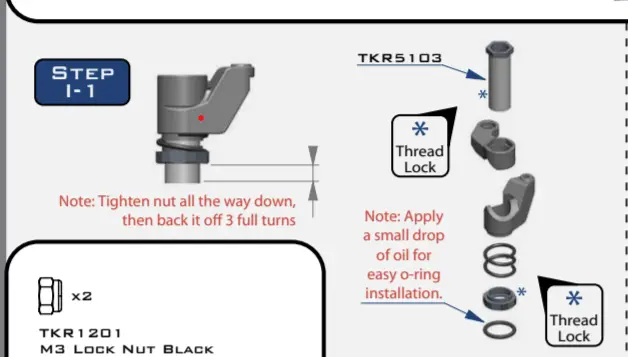

Can someone explain why the directions for the servo saver have the oring just sitting on some threads below the nut
The o-ring goes inside the nut. There's a groove on the inside diameter for it to sit in
Wow thank you very much had to take it all back apart to put it in but would never have go it without someone telling me
