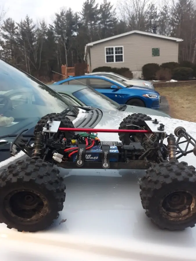

I hear ya, the Tekno mounts leave much to be desired. After tearing up a kaiju and avalanche body in short order due to no support, I made my own.

More information on how you make your own. Please.

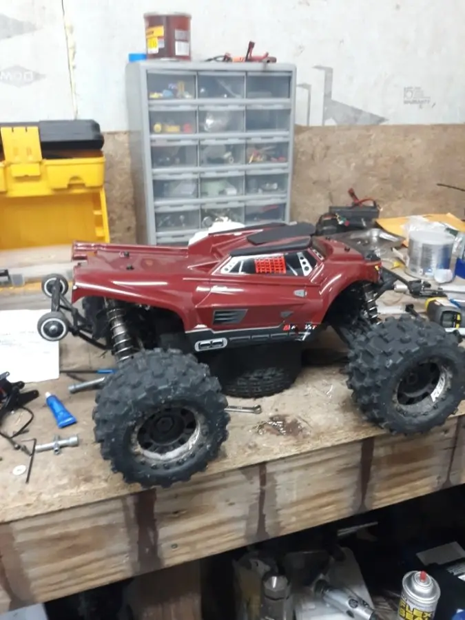

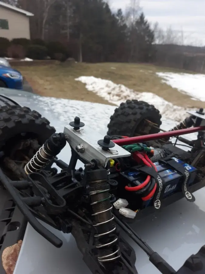

Aluminum angle,Losi body posts. The aluminum angle I used is a bit heavy, but after 2 years and 3 bodies it's never bent. The t2t is from an Arrma. Got it for like $1.99 off JRC. Can't remember what model it was for but I believe JRC lists the lengths of them on their site.
Did you mount the T2T on the angle? and then the angle is connected to the shock tower on the shock standoffs and center screw right?

It was just what I had on hand really. Yes, the t2t is connected to the angle, angle to the shock towers via standoffs. I'm not a huge air guy or anything, but like I said 2 years in, still holding up well.
Plus is, the t2t brace makes a convenient handle to carry it by,LOL.
I originally used this setup on my kaiju, got tired of breaking the cheesy stock redcat bits.
Used some leftovers for the mt410.
Credit for the idea goes to Megasty over on AF. I first saw the idea from him in the kaiju megathread.

Got supplies ordered. Local Tractor Supply was out of stock. Looking forward the the project. Looks not hard.

Definitely not..unless you wanna get fancy. Obviously I'm not fancy. LOL. I like the Losi posts, but you can use whatever. If/when I get around to stretching my mt410, I'll have to come up with a longer t2t rod I guess. I don't really run mine that hard but figured since theres not alot of give in the mounts it's a good idea to have..IDK. Thought I would be doing more flips and shenanigans when I built the mt410, I got bored of back flipping pretty quickly though.

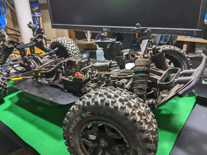

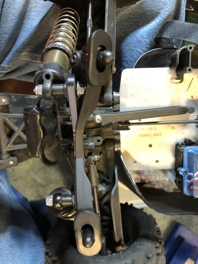

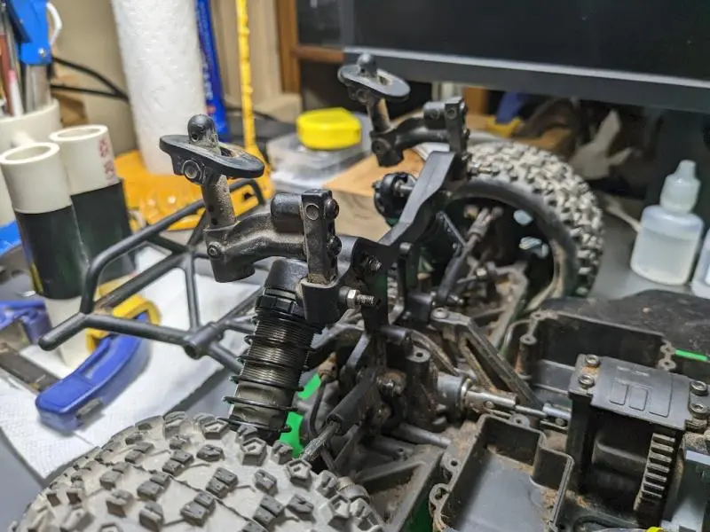

I just hacked a set of Arrma body posts for my SCT410, not perfect but they'll work for now. Still need to come up with something to get the front set to 90 degrees
