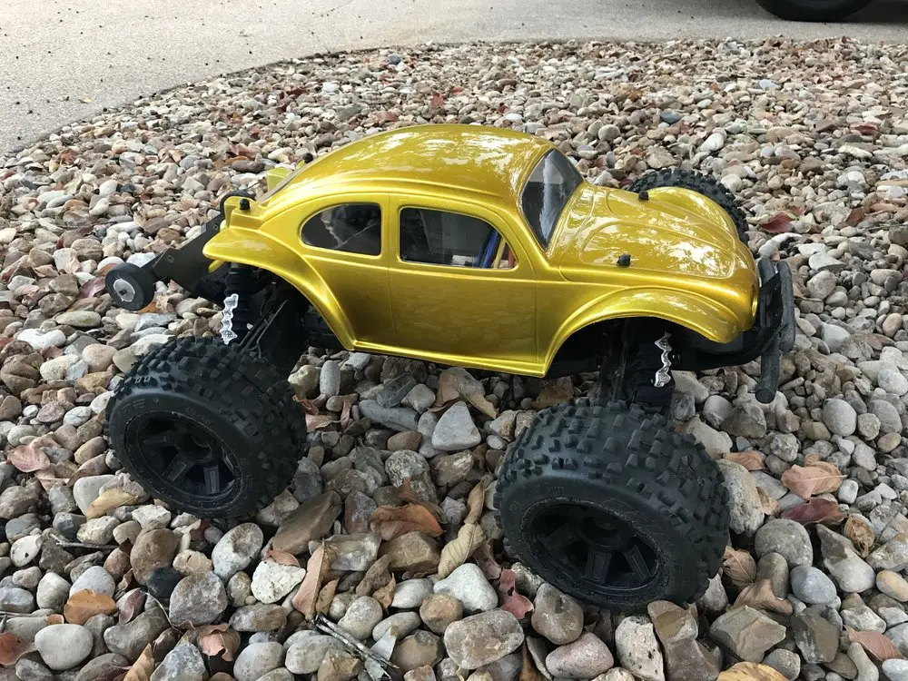

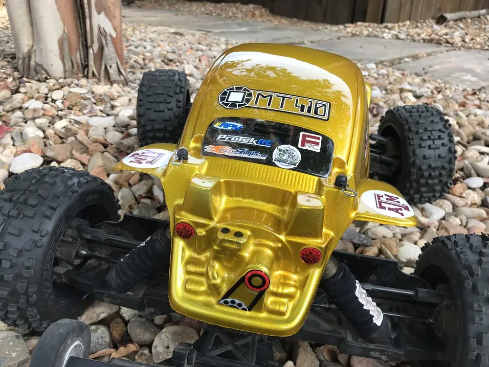

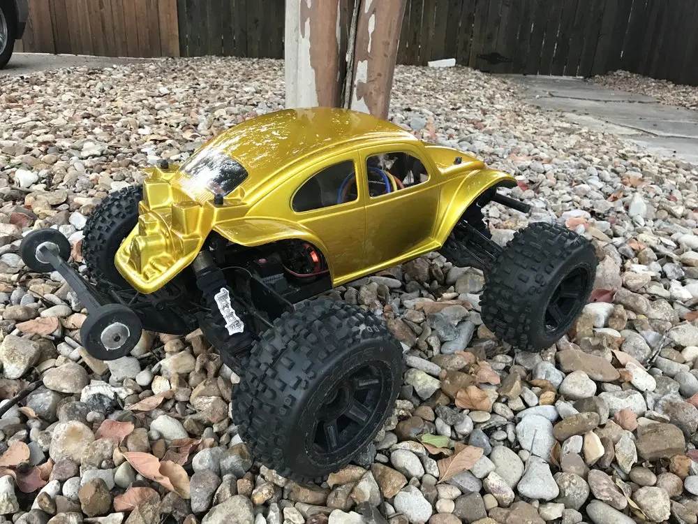

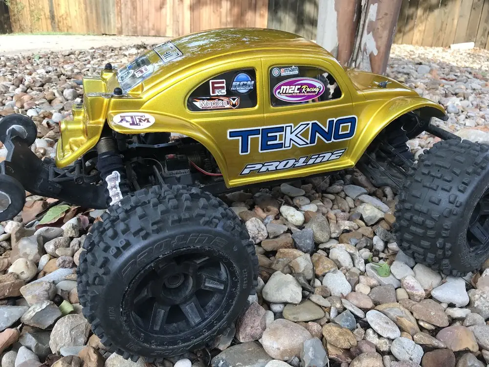

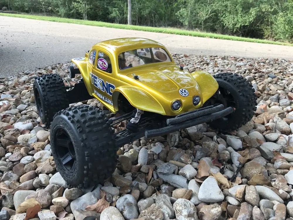

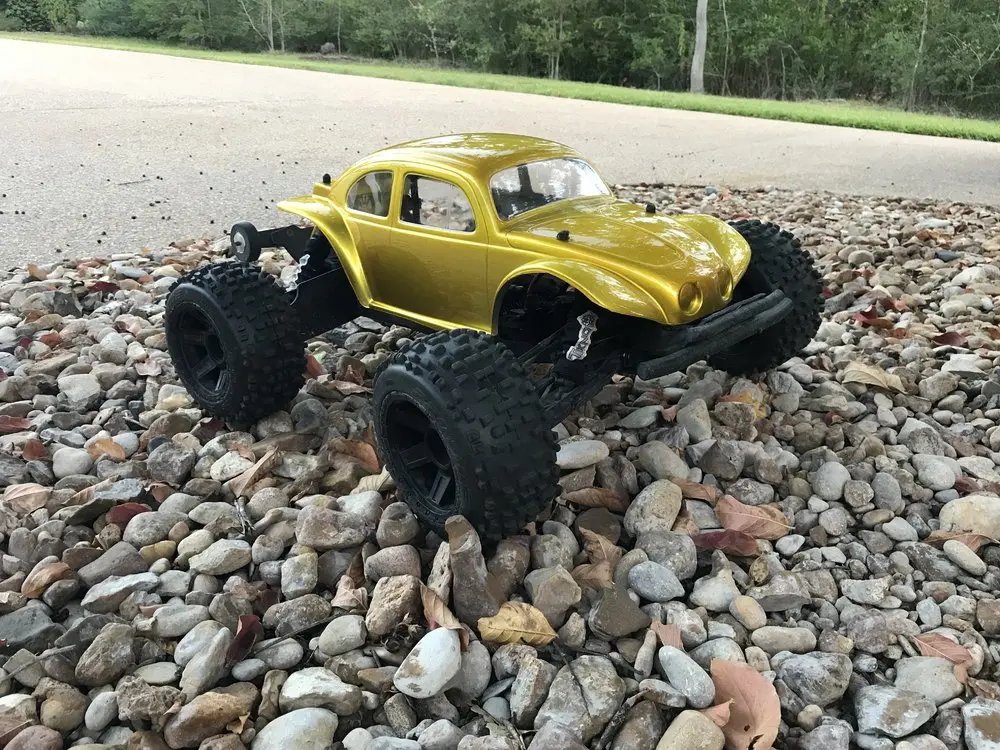

That looks really nice. What brand paints did you use and how did you apply them?
Charlie Hall
52
College Station, TX
MT410

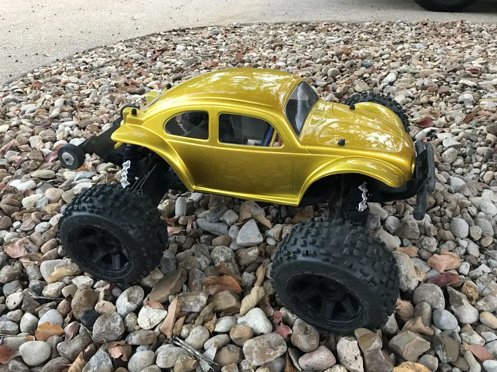

I experimented with the Spaz Stix brand this time. I used the Candy Yellow (#15259) with the Silver Metallic Color or Candy Backer (#00309).
Here's what I liked:
  1. It came in a little larger can - 3.5 fl oz. compared to 3.0 fl oz for Tamiya (my previous go-to paint). I always had to buy 2 cans of Tamiya but only needed about 1.25 in reality. I had a second can of Spaz Stix (just in case) that I elected not to use but I could have touched up the top a little to remove some light spots (my fault). But rather than use a partial can, I just went ahead and applied the silver backer paint.
  2. I had NO spattering at all. The spray was uniform and 3 light coats were applied with no issues. I will be a Spaz Stix user until I run across something better.
Helpful tip for next time:
I washed the body thoroughly, then trimmed it, and then painted it. Next time I will trim it first, then wash it, and then paint it. I noticed 2 or 3 spots where my fingerprints affected how the paint stuck to the body. Again, my fault, not the fault of the paint.
