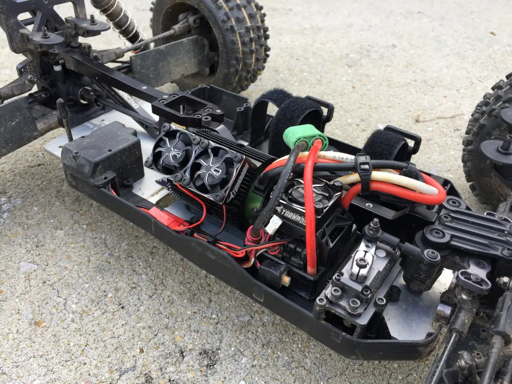

@Overkill I bought a 107mm TP Power 1700kv motor for my wide chassis. Do you think I should support the back end of the motor with something?
I swear I saw you used a fan mount, but cannot seem to find that picture again.
My motor screws are 4mm and I have the older style M3/M4 Tekno mount.
Thanks!!
Thanks!!
With my other truggy, I use the stock ESC plate as a rear motor support. I use 20/43 gearing and the motor rests right on the plate, it works really well. With the truggy in this post, I did try a fan mount support but it didn't hold up on big jumps.

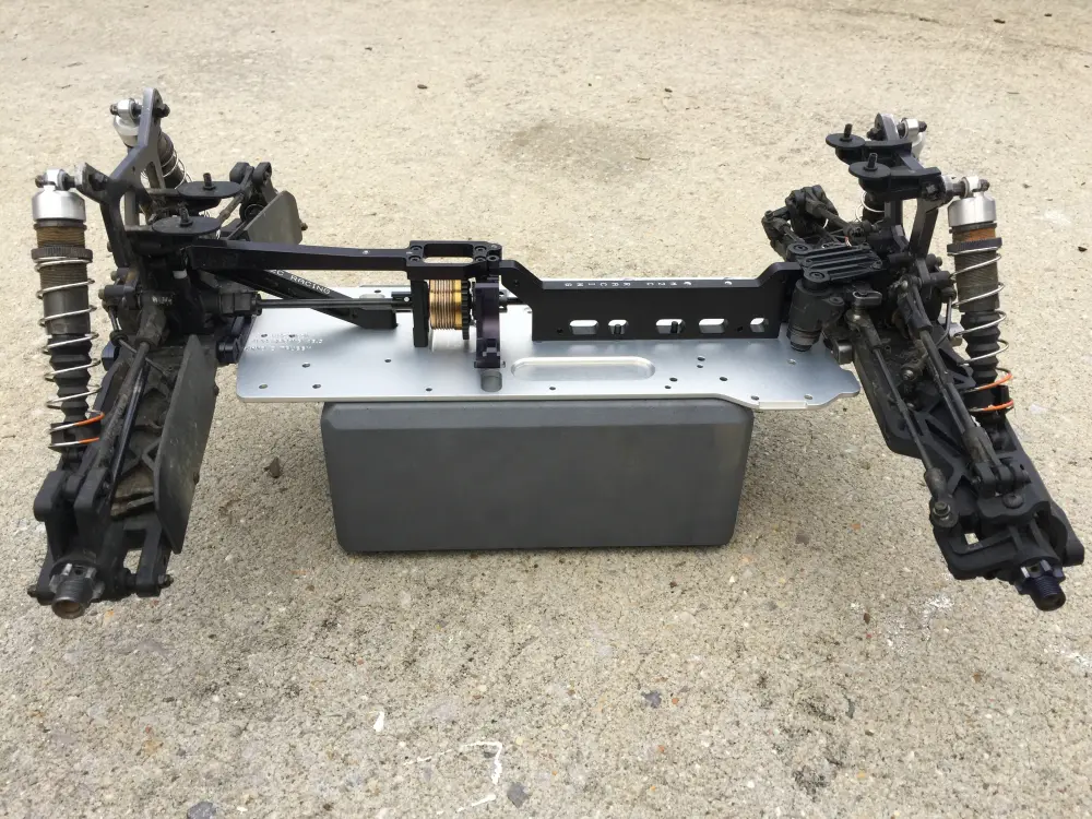

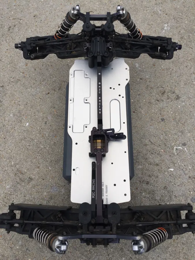

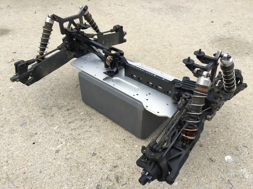

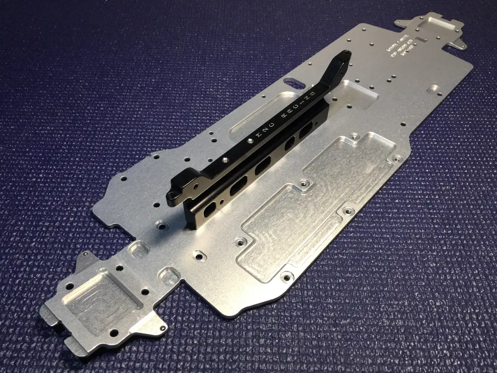

I just realized I never posted up the production chassis.
The rear sides of the chassis were cut back just a tiny bit to provide more clearance for the arm mud guards. The rear ESC plate holes were moved a little closer towards the center to provide more ESC protection from debris. The left rear section of the chassis was cut just like stock instead of straight all the way down.
MEGA brace
3 chassis braces for the ultimate level of durability
I'm currently running my light weight setup, which is a little over 11 lbs. w/battery.
Castle 1515 2200kv motor
Castle MMX ESC
Yeah Racing aluminum case fans
Tekin T-440 servo
Proline Badlands
15/44 gearing
6S hardcase battery
iceman2733
55
17
2603
2604

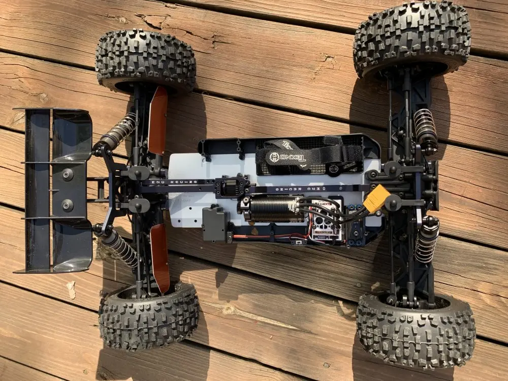

I am glad ya posted I had forgot to post pictures of mine finished up needless to say the standard electronics and truggy motor def don't fill out the chassis as much lol
