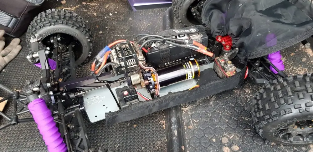

I believe the servo has to be flipped and you need a longer servo horn, Check this image out
tbh. you have to test around a bit. i still run the normal servo horn on mine, gave me a better angle on the stearing.

Thank you, I knew the servo had to be flipped but I was still using the build manual as a reference and I shouldn't since the photo you provided shows the connecting rod from the horn to the steering link in a totally different way. Thanks

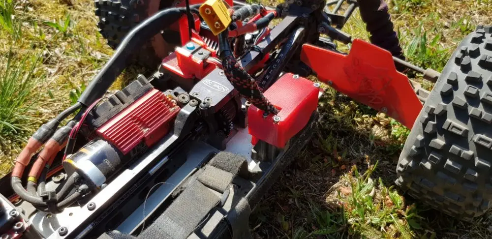

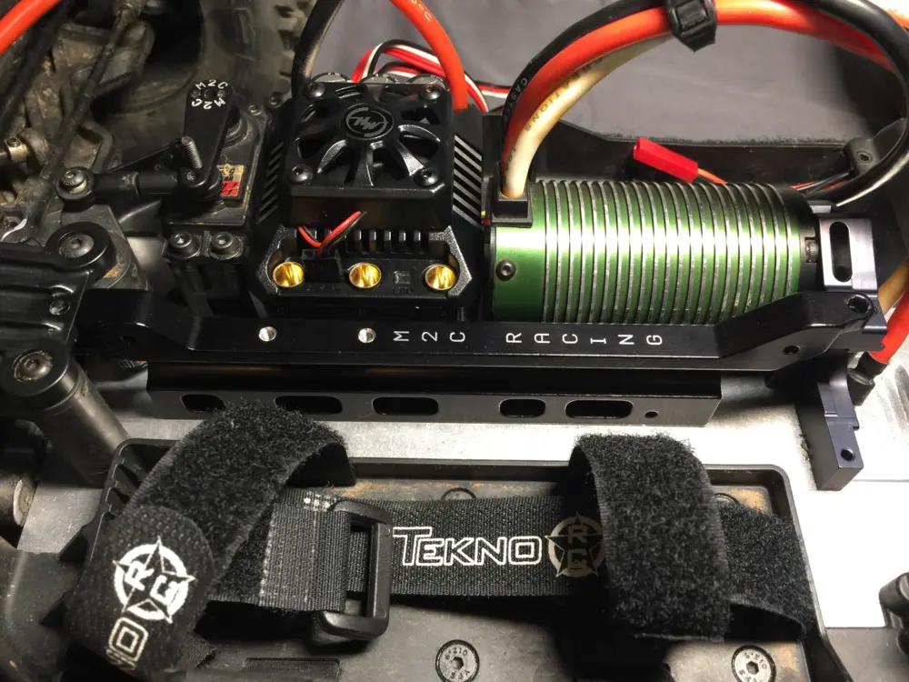

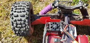

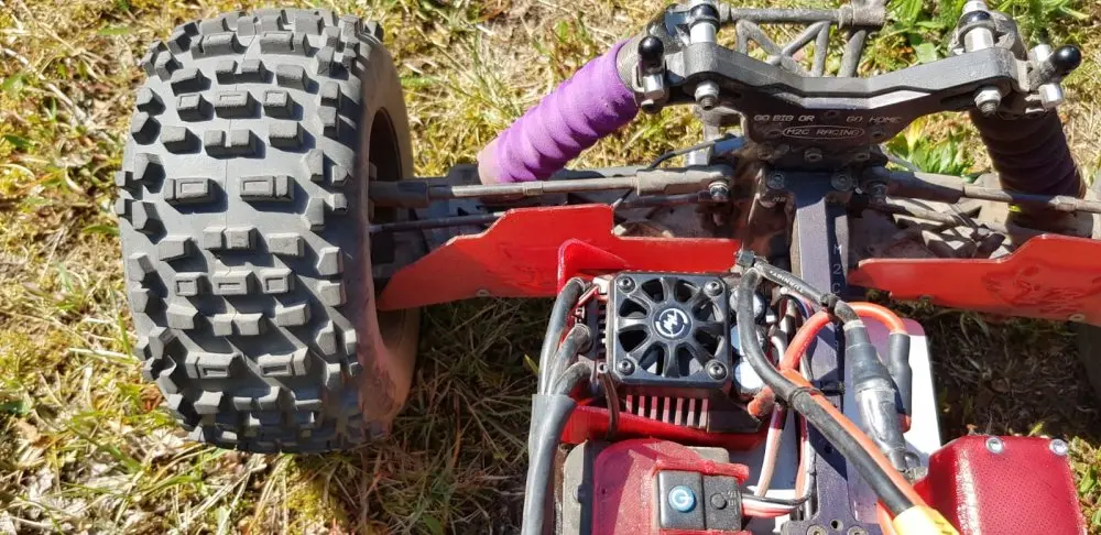

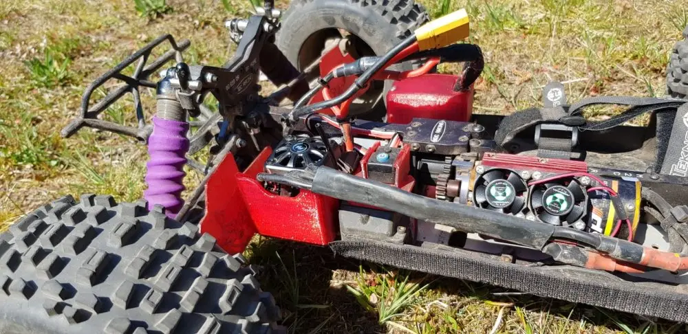

Motor is a 4060 1750kv, still gets kinda hot on 6s with a 16t pinion. So if i had to buy another one i guess i would go with a 4070 1400kv and a bigger pinion. I switched to a max6 on the mt48 lately, runs super cool but the HW fans are trash. I killed 2 fans allready.... guess i have to upgrade to a 30-40mm fan and mount it on top of the esc...
