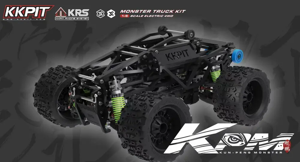

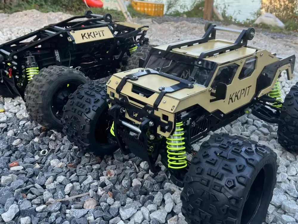

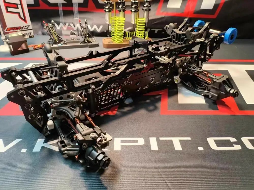

I almost bought KKPIT's K1-SCE, but Tekno's SCT410SL changed the direction for me. KKPIT seems like top notch stuff. Is the MT based off of the Golden Beetle? Do you have a link for the truck?
The MT is a completly new chassis, made for stunt. You can use a cage or a classic body.
All parts seem very strong, and alu is 7075.

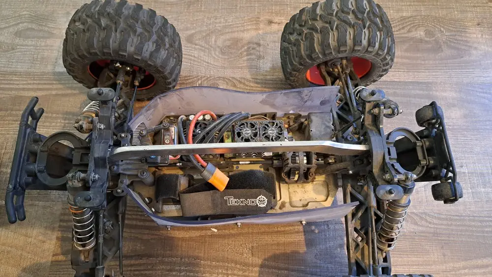

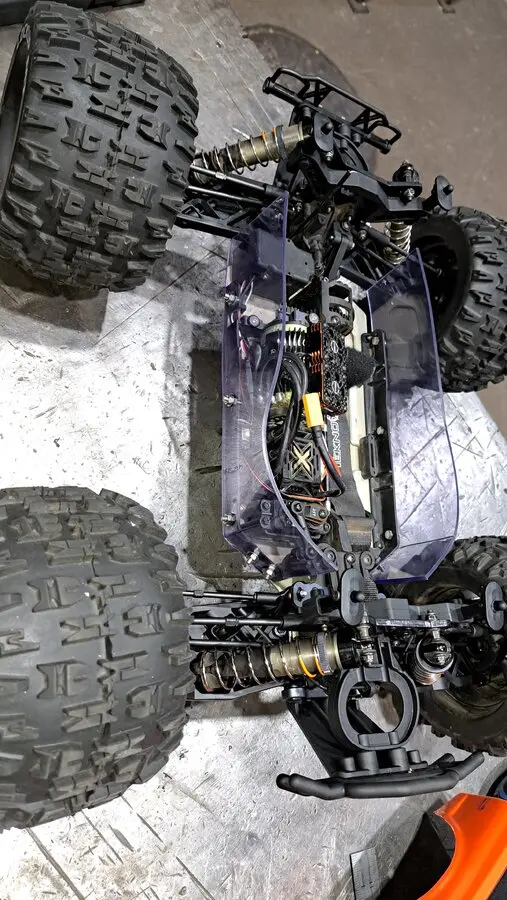

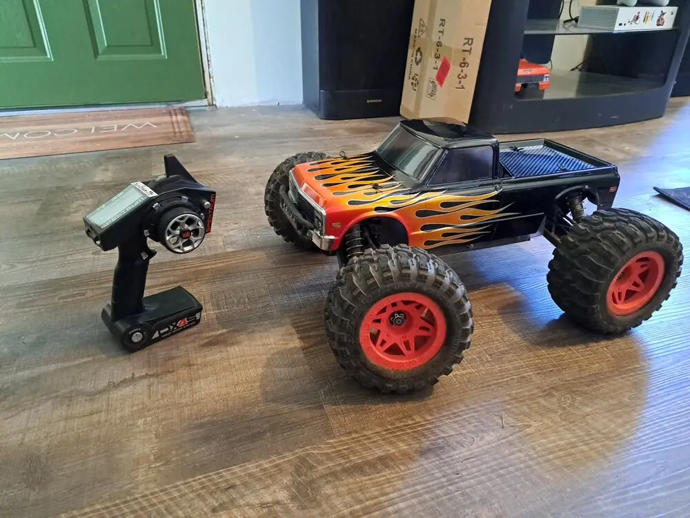

Got so upset with tekno I did just that. The Mt410 2.1 or Mt48 2.0 in complete.
I started with an EB48 2.0. That is what I had sitting around. This requires et48 2.0 arms, ABC and D blocks, shocks, swaybars, camber and toe links. MT410 2.0 bumpers, skids, shock towers, tower braces. Sct 410 2.0 body posts and mounts.
Buggy diff are geared quite high and I'm running a 14 tooth pinion on my 2200kv motor.
👍 Thank you. Good job !
Did you also need to use the ET48 CVAs?

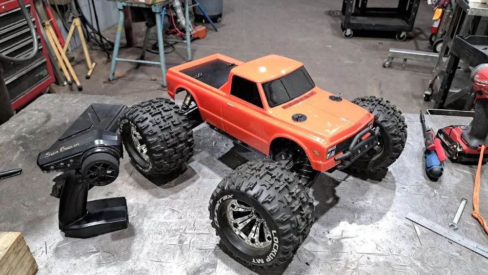

This truck is awesome and is now a part of the family. Tirs have changed and body has been well used. Still nothing broken.
